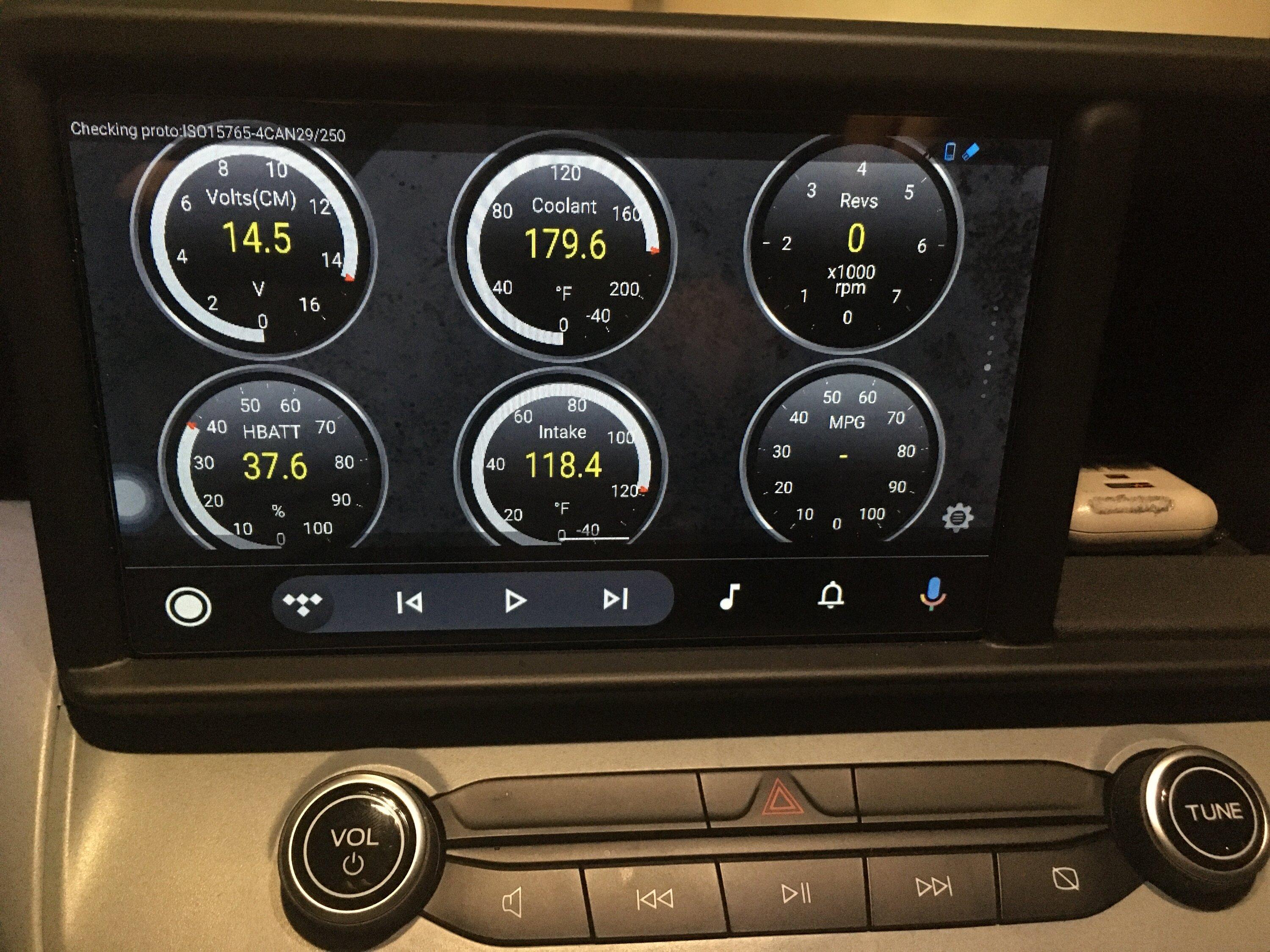

Depending on your phone type, you can run Screen2Auto, free, app and view Torque.
Works on my Moto MA1 adapter(or wired) with my Pixel 6 Pro, Oneplus 9, and Motorola phones.
Basically, this as well as most of the AI boxes just mirror your phone. Netflix and other apps with DRM (HBO Max,Hulu, etc.) don't allow screen mirroring. Copyright issues. Youtube works, 3rd party video apps work, IPTV apps work.

Root not required. Both my Pixel 6 Pro and OnePlus 9 are unrooted. Just install Screen2Auto using an app called AAEASE. Won't find it in the Playstore as Google doesn't want you using it, hence why they block it.
