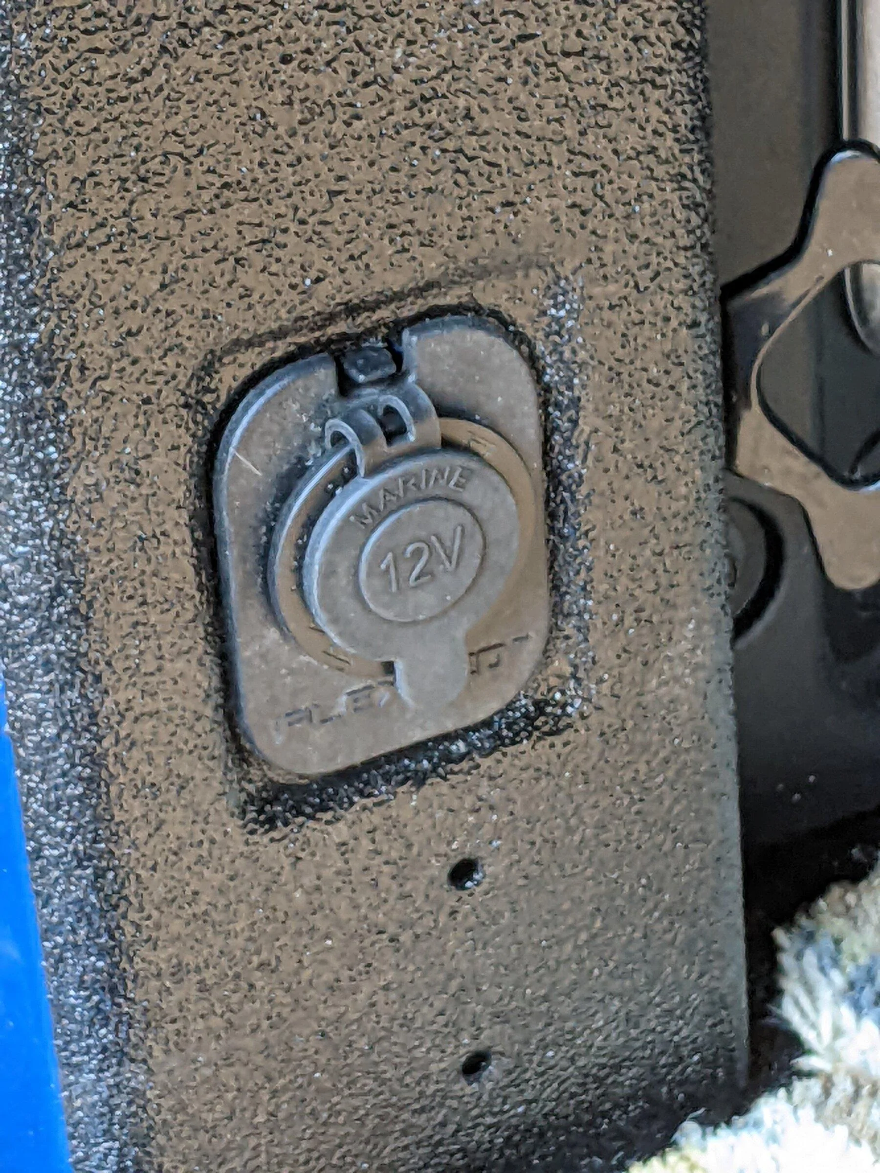

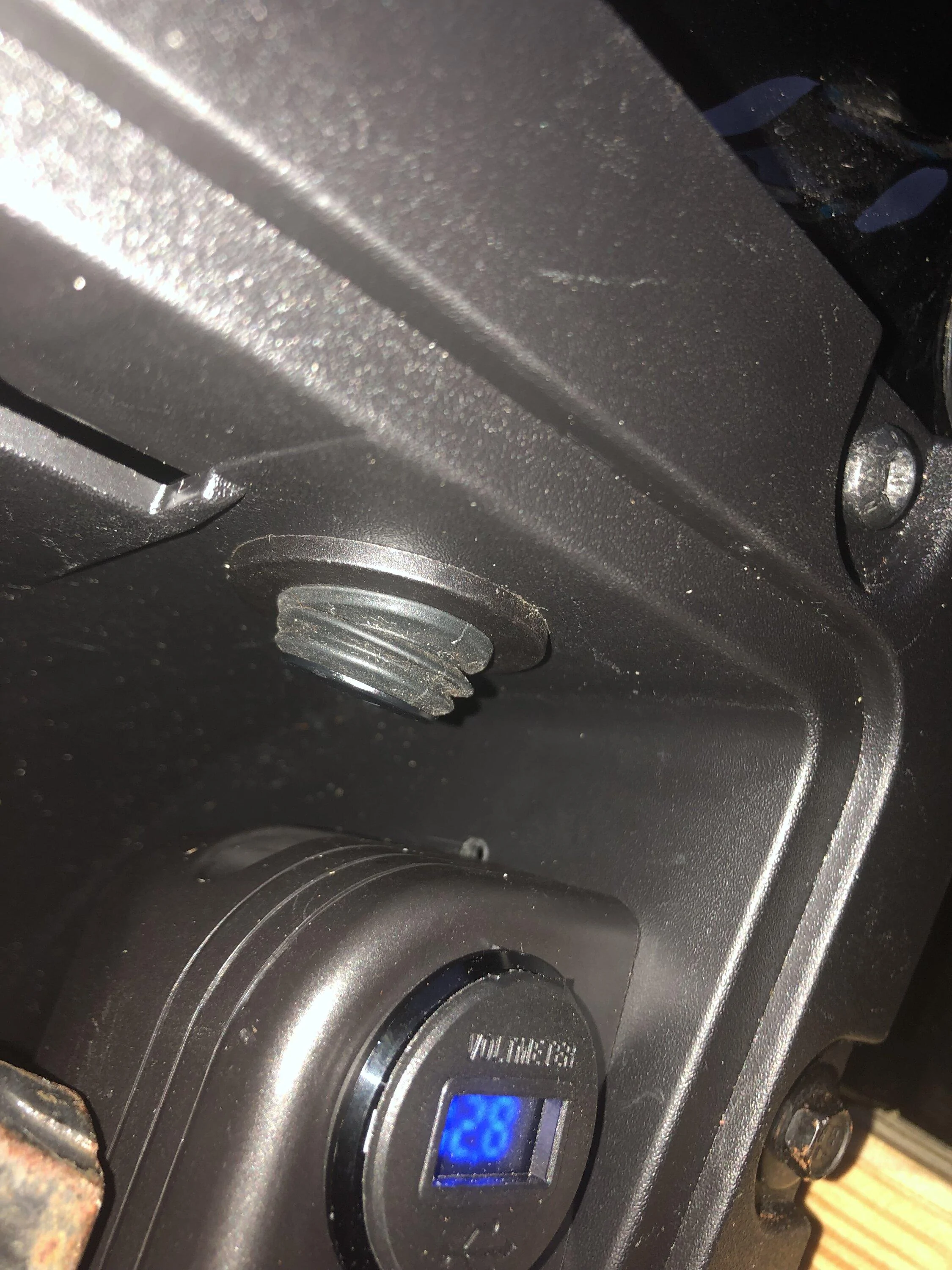

Here's the 12 volt outlet I installed in the bed. Went with OP suggestion. Mounted on the little access door on drivers side. 1 1/16 hole required and some butt connectors.
That looks perfect. Great job. Confirming that the drill hole saw size is 1-1/16. Would a 1-1/8 size also work ?
Thank You.
Thank You.
1 1/16 is a tight fit, but there is a plastic nut on the back. 1 1/8 sb ok.
Thank you Skeeter. Tight fit sounds better to me for keeping out water, etc.

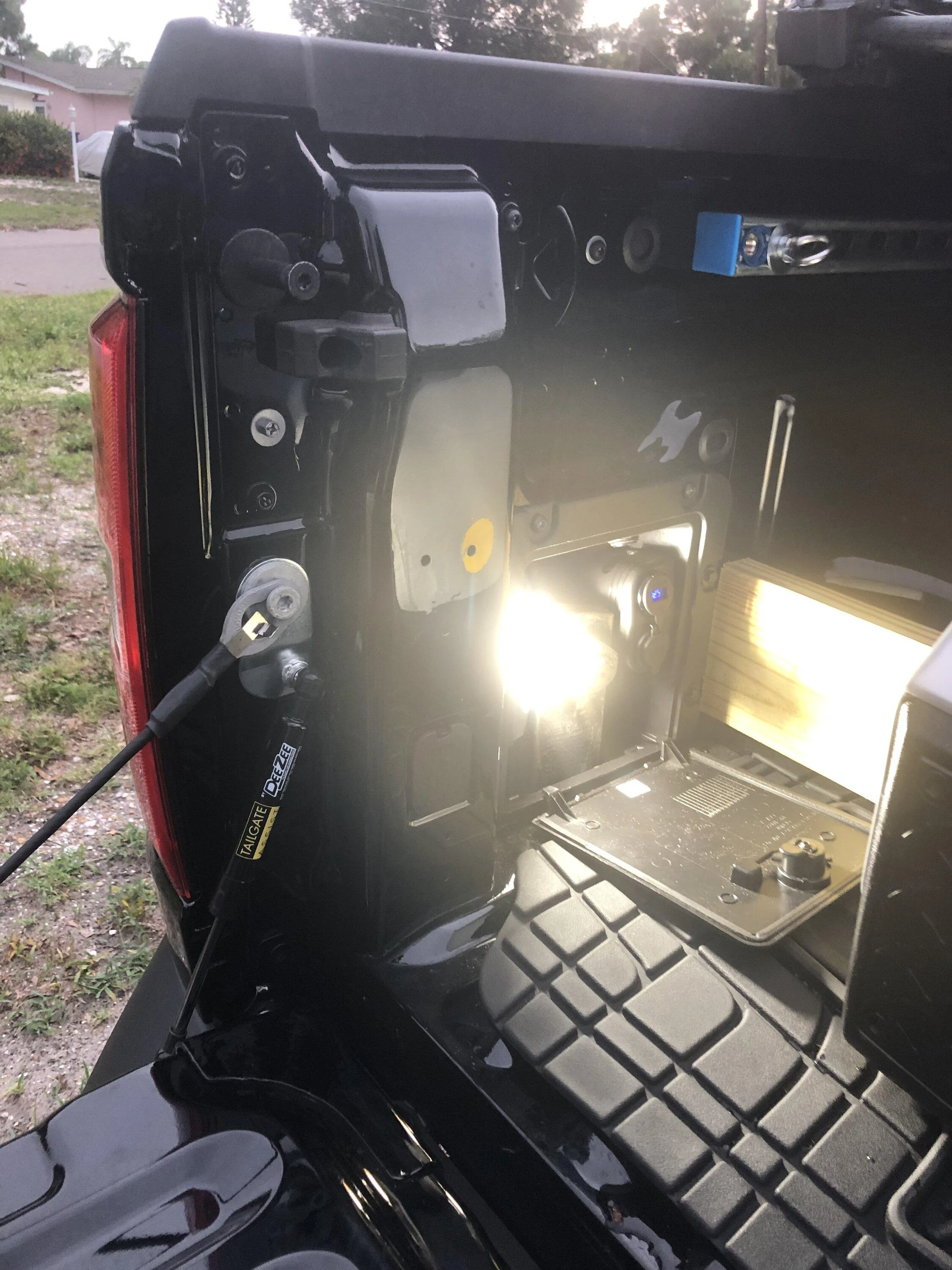

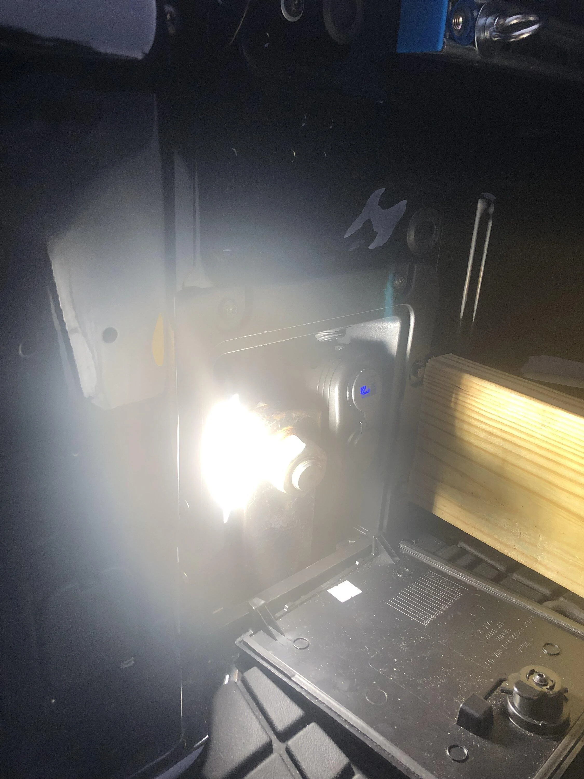

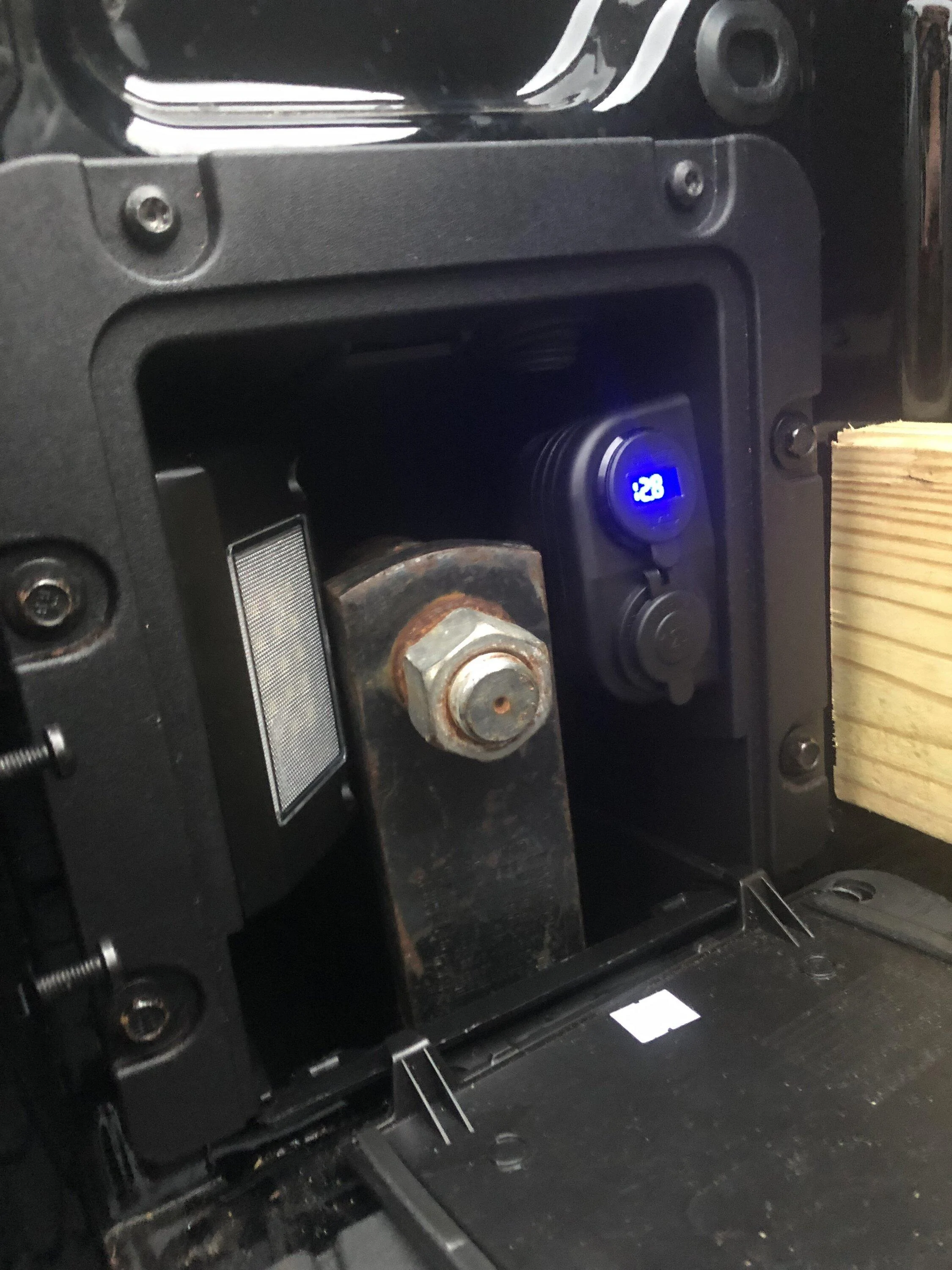

Same from side to side, wanted to keep the outlets and light safe from mulch and… Stuff, so I bought a second cubby, and an LED RV door light (angled) and some other bits from Amazon 3 panel doohickey with a voltmeter, cigarette lighter outlet and a waterproof switch… Things when wrong, extra holes were drilled but Amazon saved the day which an enderdash plastic thing and it was saved… Angled light toward the bed, and the switch is in the upper area… The RV light has a metal case so it’ll be oK getting hit by my hitch…
