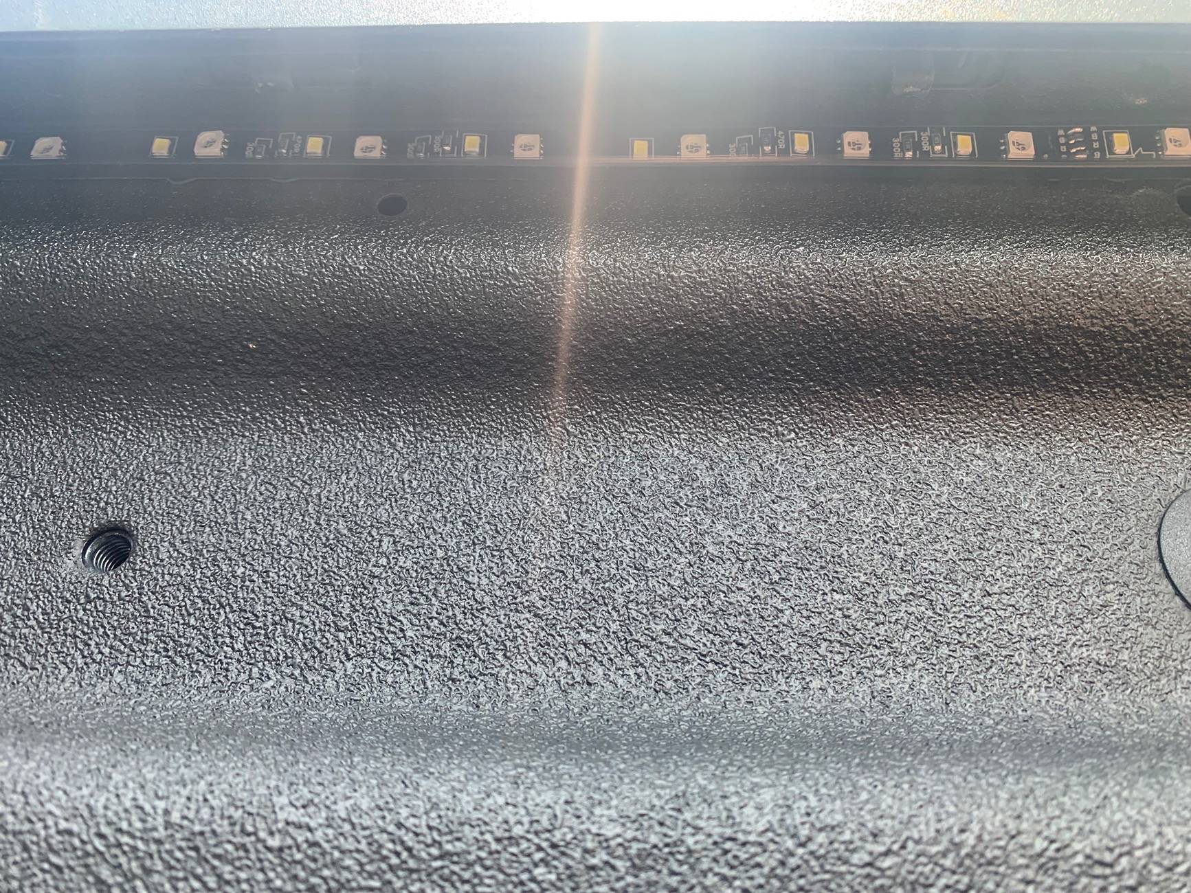

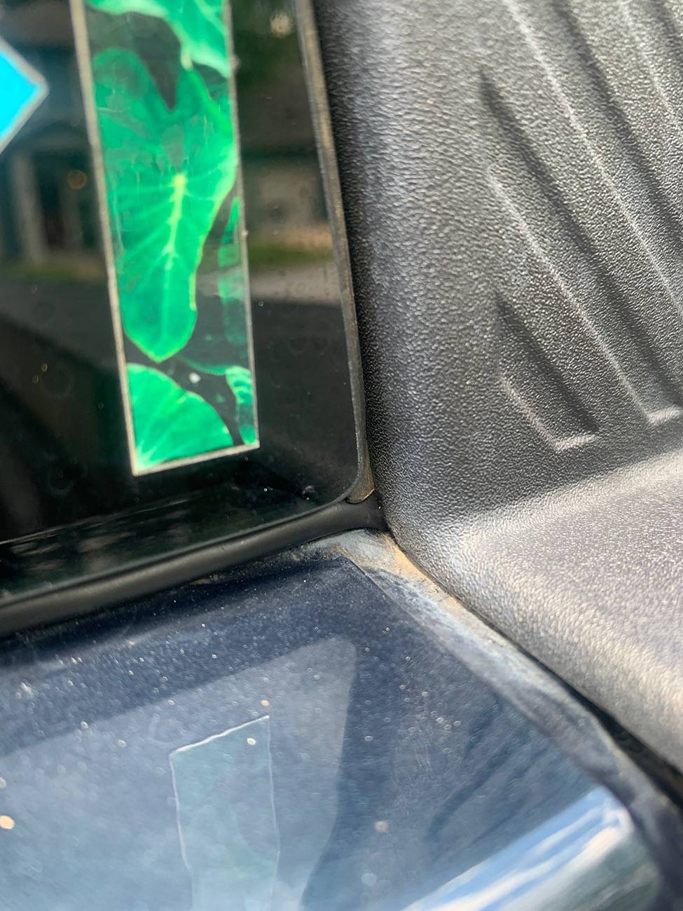

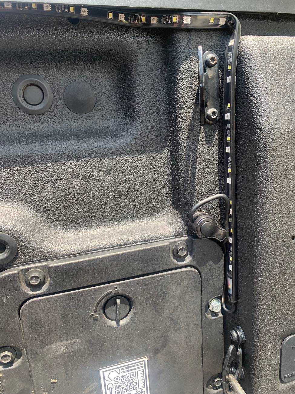

I know it’s been a bit. I kept forgetting to post. I ran the lights on the upper ledge of the bed, not on the lip of the cowling. From there I ran the power cable through the cowling popping out right under the rear glass to the other side. The control box is Bluetooth so I have it tucked behind the storage container. I did route the master switch to the back wall next to the 12V outlet.
