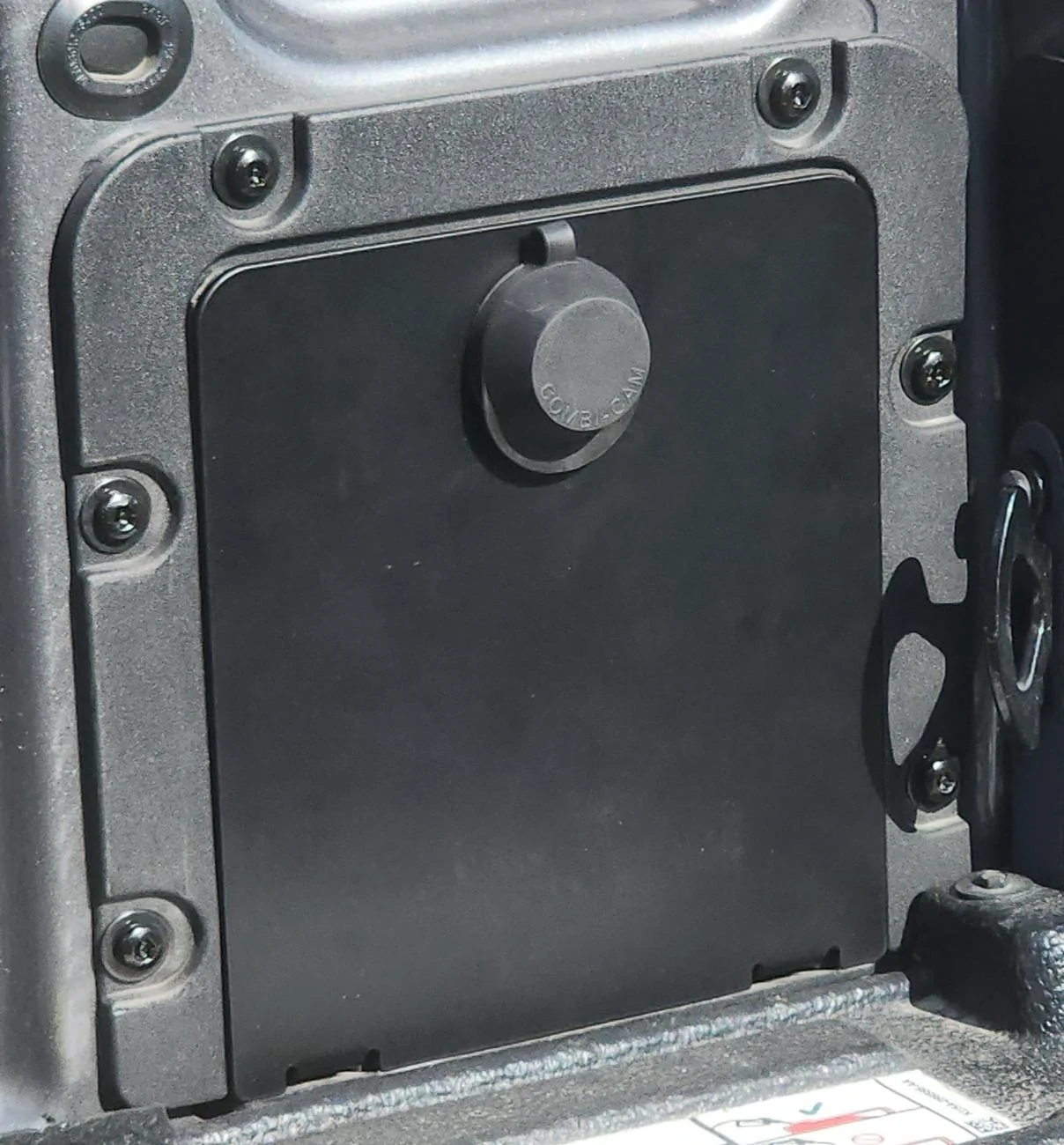

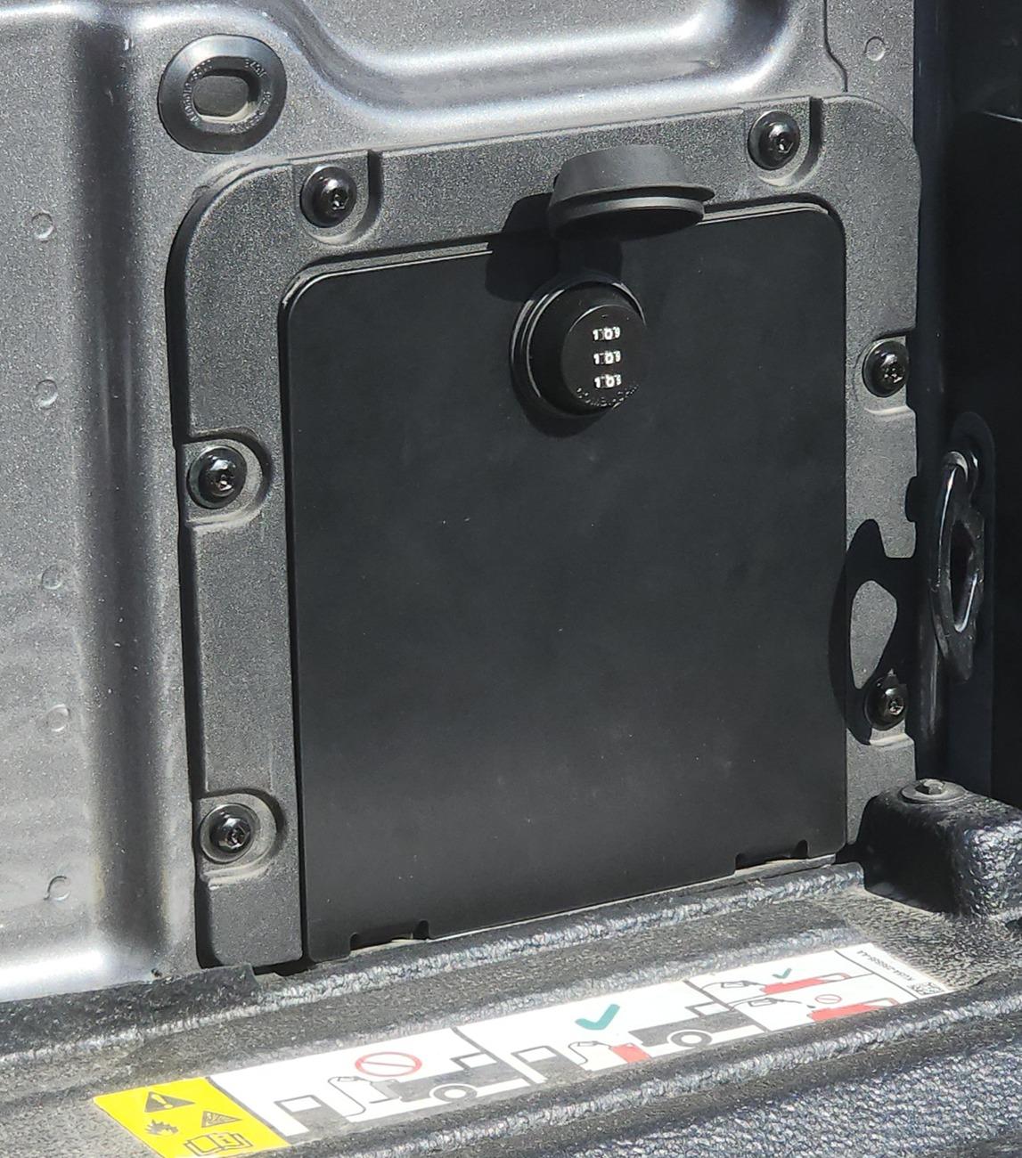

I have a new batch of bed cubby doors with a smooth matte black finish that doesn't collect a lot of dust like a rougher finish would. They come with a combination lock with a protective cover.

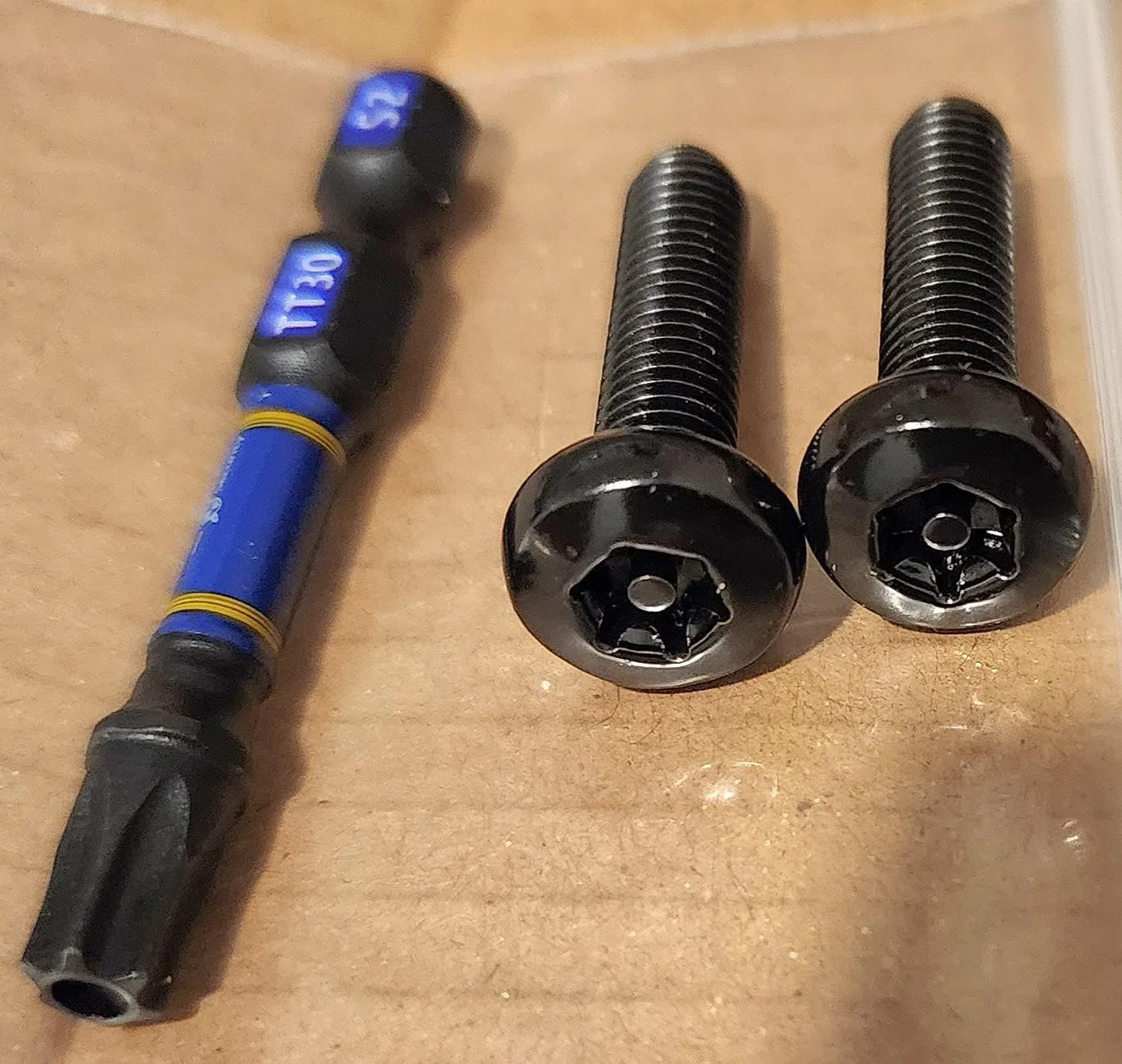

I also will include 6 bolts and washers with each door that are black oxide coated stainless steel. They are security torx head bolts, and the TT30 installation bit is also included.

Nice! Some of my customers want and have me install those combo locks on their pinball machines.
The funny thing is I think the lock alone is overkill but it’s nice to have. I have a MX4 so unless someone is putting something in these that’s valuable, they won’t know it’s there. And not sure what valuables I’d leave in my car yet alone in the cubby. My desert eagle will be on me before I’d leave it in there. 😃

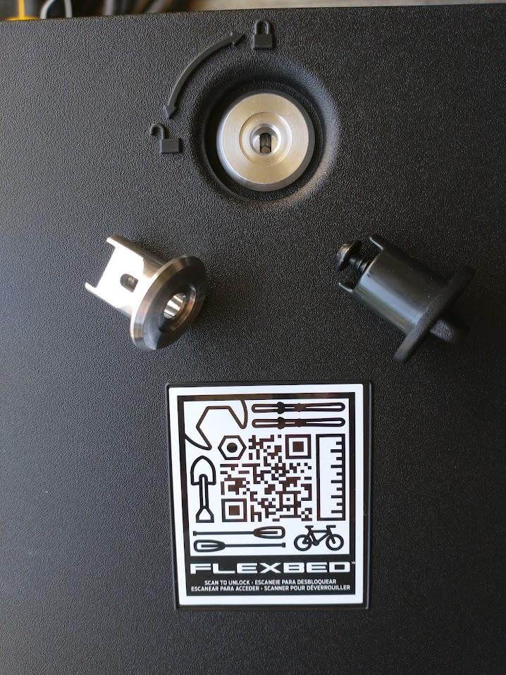

Very nice job! I added a second bed cubby on the driver's side of my XLT and love it. My cheesy approach to improved security was to fabricate aluminum replacements for the stock lock bodies on both sides. They're not at all "secure" as I just use the ignition key like a screwdriver to open them. I figured that those plastic doors are pretty easy to pry out, so actual security is impossible. My lock is mostly psychology but might slow down a lazy kid who happened to walk by.
Those look great, nice work.
And psychology is really all most "security" is, making it easier for a common crook to move on to the next guy. If someone wants what you have badly enough, they'll get it one way or another.

How do you set the combo on the lock?

Unless you have a tubular lock impressioning tool, then it takes like 5 seconds. 🤣
Not all thieves are familiar with those types of devices. Your absolutely correct though

There is a small hole on the bottom of the knob that you stick a pin into and set the new combo while holding pressure on the pin. The lock has to be in the existing combo position before rotating the numbers to the new combo, release the pin, the new combo is set.
