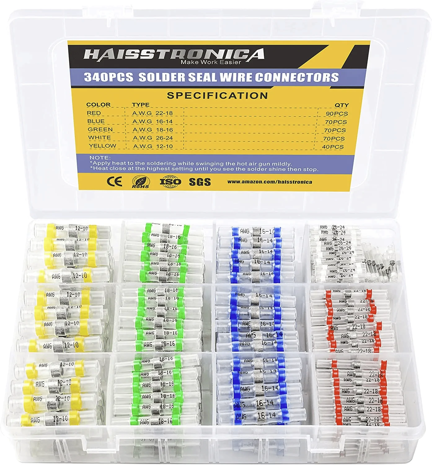

  5. Also not included: miscellaneous wire splices that are needed. I'm using marine-grade heat shrink solder seal connectors. You insert the wires and heat with a torch or heat gun, shrinking the tubing and melting the solder. Something like this:

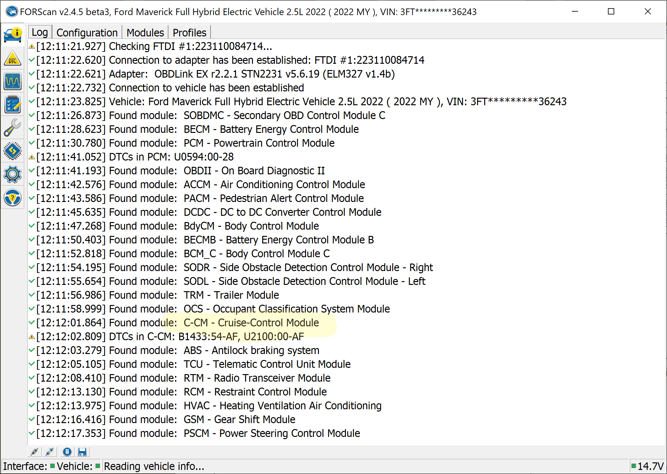

The engineers at Forscan turned around a beta version for me that lets me calibrate CCM and ABS. I was able to calibrate the CCM sensor, so I think I'm good to go on that front. I used an AsBuilt file from a LariatLux and entered my hex VIN.
I have the programming finished as far as I can tell, but I'm still getting a couple codes:
ABS U2101
IPMA U2101
IPMA Signal plausability (forgot to write down the code)
I tried resetting the ABS configuration back to stock and the code persists, which leads me to believe it's an interaction with another module that is causing the code.
Does anyone know if the ACC and non-ACC models have different IPMAs?
EDIT: After thinking about it some more, I feel like I would have been unable to calibrate the CC-M sensor if I had the wrong IPMA. There must be some other incompatible setting that's causing these issues.

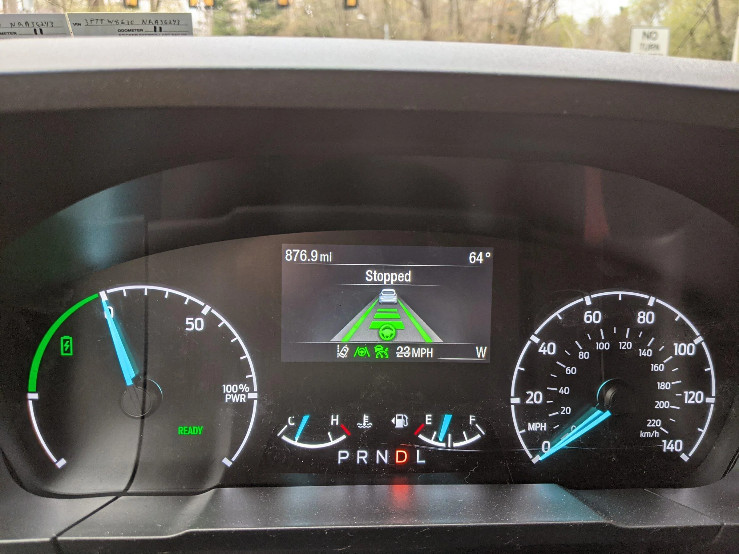

I now have ACC selectable in the IPC, I can set the distance ahead, and I can turn it on and off. There are no DTCs. The IPMA is working because I'm getting lane keep assistance in the form of little nudges if I get too close to a line.
The only thing that is not working is the cruise speed setting itself. I cannot set the speed no matter which button or buttons I press.
