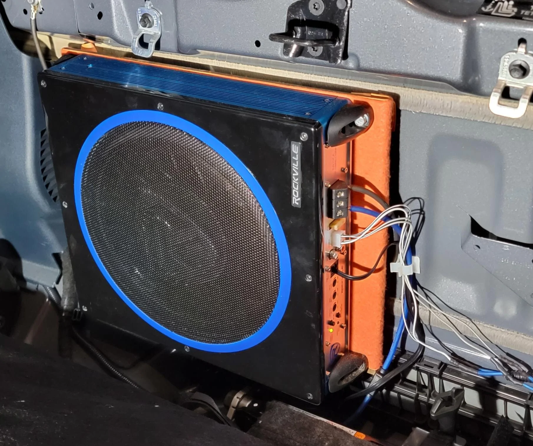

So, I gave it a shot. This cheap little kit was about $160 on Amazon. Had everything I needed for the sub wiring. Pulled panels all the way to the rear speakers, skinned a section near the factory connector and soldered my speaker leads for each channel, ran to hi level inputs for auto on/off. Remote got mounted under the steering wheel with VHB Extreme with the wire getting tucked all the way back without removing trim. Works like a charm. I've never done any sort of audio/speaker install before, so it's not pretty, but it was a shit load of fun. About 5.5 hours total, including the 1/4 MDF mount wrapped in orange foam/felt for vibration reduction/matching the accents of the rest of the truck. Mounted the plate to the existing amp mount after some minor modifications. I don't have photos of that, but I had to unbend a couple spots to flatten it out, and I installed (4) 10/24 rivnuts to attach the plate.
Rockville RW10CA 10" 800 Watt Under-Seat Slim Amplified Car Subwoofer +Wire Kit https://a.co/d/ad4hGhy

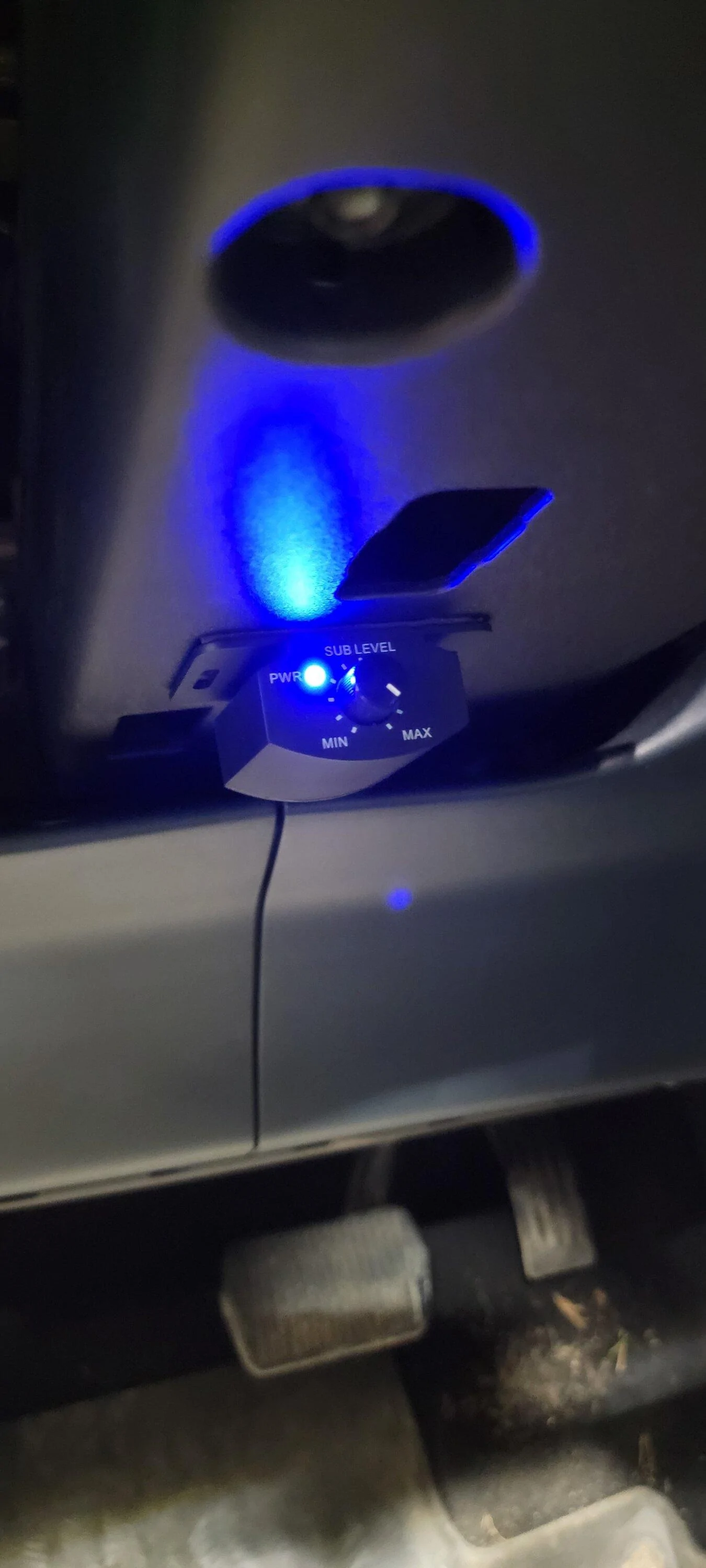

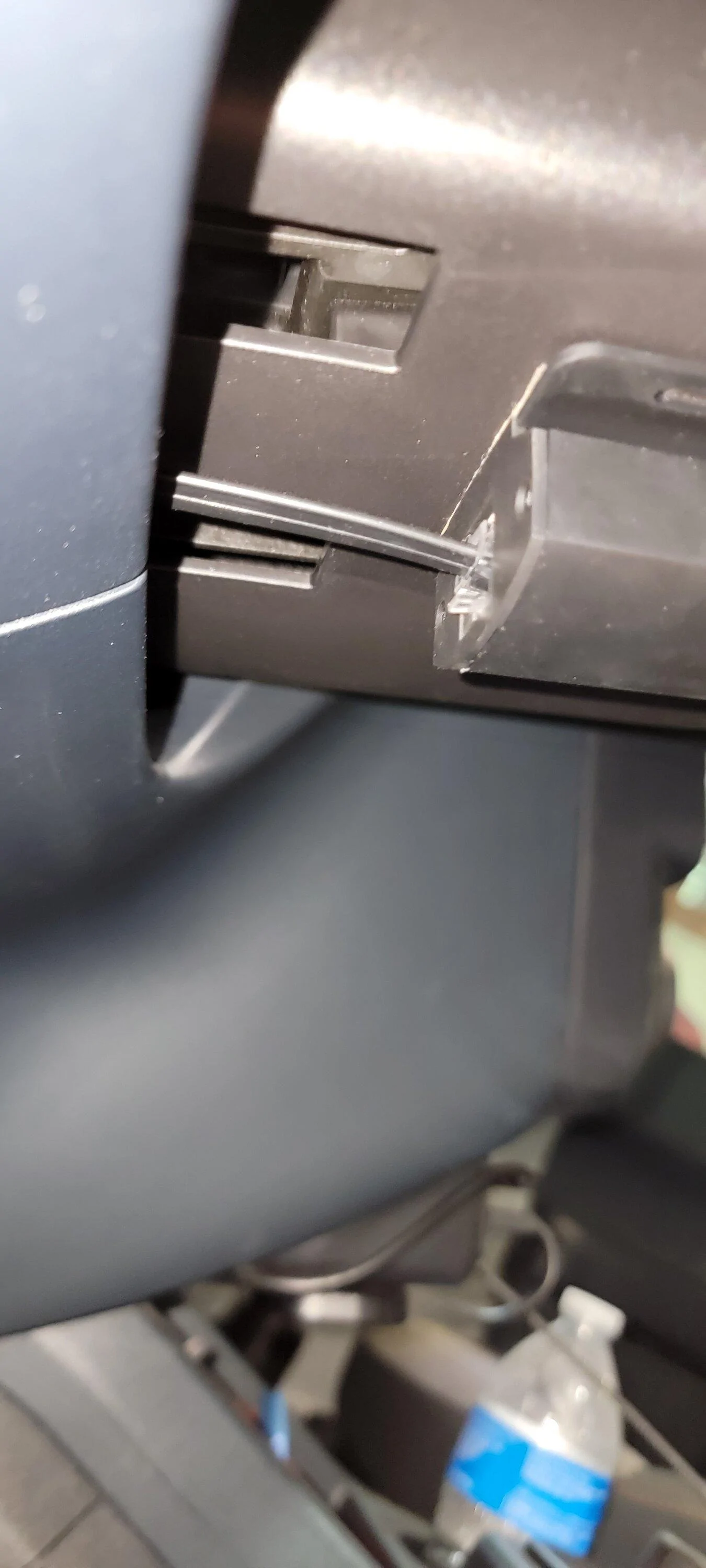

Here is a link to the video I used to pull the back panels.
I regards to the remote, it's an rj45 cable for the remote to control the sub level. It's not wired to any speakers in the front. It plugs in like a phone jack or ethernet. One end into the remote itself, wherever you decide to mount it, then you have to run it all the way to the subwoofer and plug it into there as well. You should be able to zoom in on my original photo of the sub and see the other end plugged in.

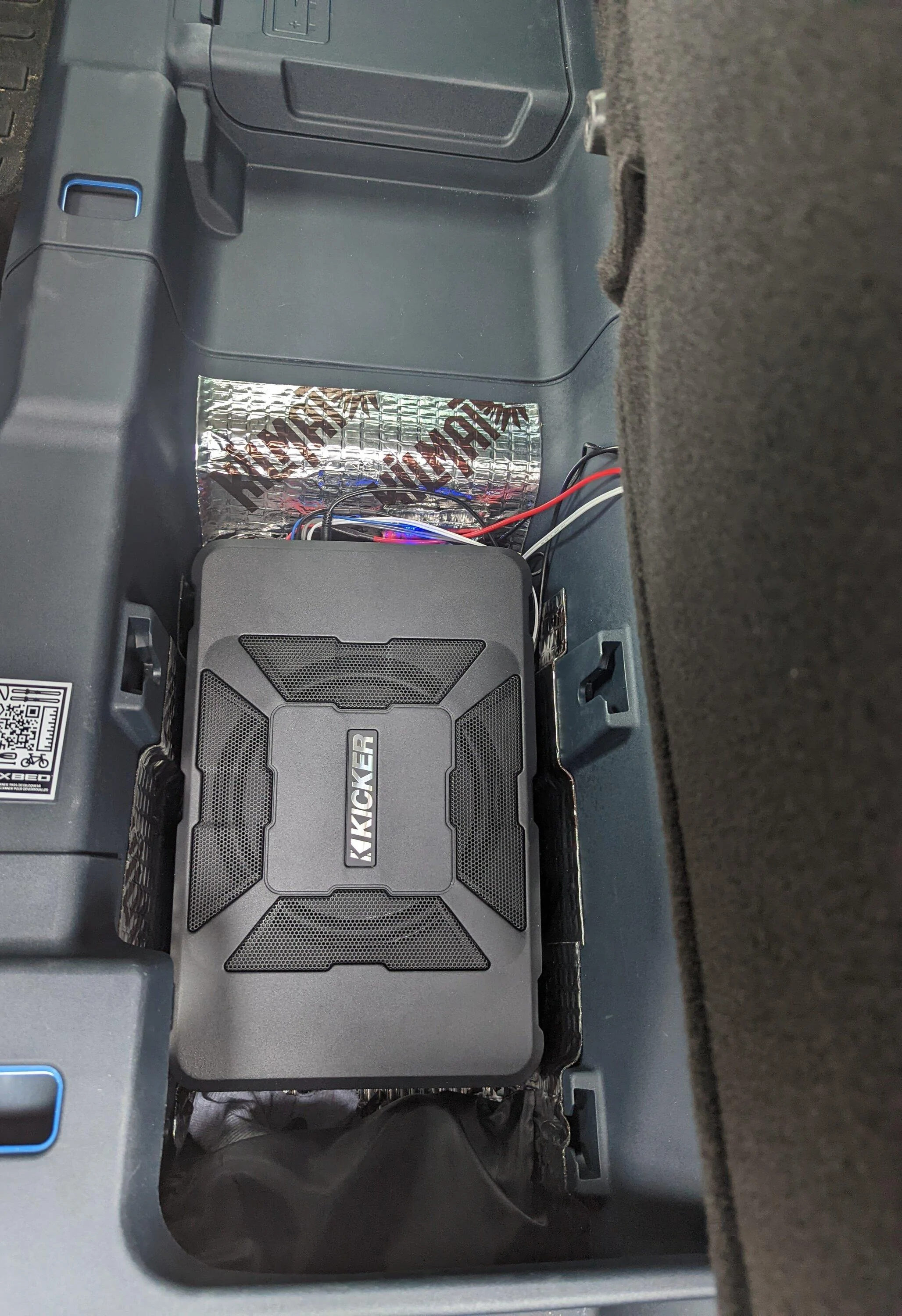

I installed a Kicker Hideaway 8" a few days ago. Huge improvement to my B&O system, quite impressed. Easy install, especially on a hybrid with the 12v already under the rear seat.
On sale for $254 at several places (Bestbuy, Crutchfield, Amazon,) I got an Open Box at BestBuy for $165.

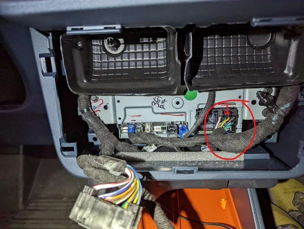

The info about location of the ACM connection is below. The low end is better than without the DSP Amp, but remember you can tune the DSP the way you want it to sound. As you can see in the photo below of the tuning screen, there is 15 bands you can fiddle with.
For me, adding the sub power connection was the most difficult task; but for you with a hybrid, that part should be easy for you. The sub input comes directly from the DSP sub output.

The harness connection couldn't be easier.
Here are the steps:

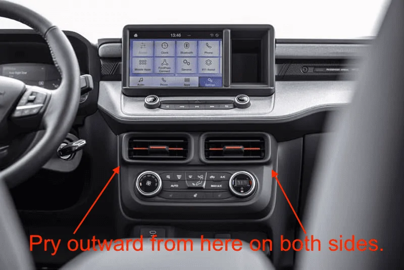

1. Pull off the center dash trim piece that holds the HVAC vents.
Ford Maverick Active Powered "All-N-One" Subwoofers 1677951374081
It's easy as it comes straight out and is held by four clips; 2 near the top on each side and two near the bottom on each side. All you have to do is get underneath on each side with a plastic trim tool and then pull straight out. The first time it is attached a little firm, but it does come out. You don't have to disconnect anything, just fold the trim piece out of the way.
2. Next unplug the Ford Harness on the right side of the ACM (circled in red shown the following photo).
Ford Maverick Active Powered "All-N-One" Subwoofers 1677951478274

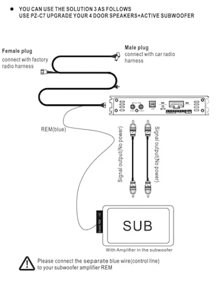

3. Plug the harness marked Male plug to the ACM where you unplugged the vehicle's harness wiring. Plug the harness marked Remale plug into the connection you unplugged from the ACM.
Ford Maverick Active Powered "All-N-One" Subwoofers 1677951681527
4. Fish the remaining end with a white rectangular connection that goes to the DSP amplifier down inside the dash on the side you want to put the DSP Amp. The length is considerable and is long enough to put under either seat. I'm thinking about putting mine near the bottom of the cavity beside the fuse box at the front of the right side floor board.
5. Plug the white connector into the DSP.

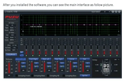

Then follow the instructions to connect a computer or smart phone and tune the DSP.
Ford Maverick Active Powered "All-N-One" Subwoofers 1677952072855
6. Put the trim piece back on then using the palm of your hand hammer it home seating the clips.
And that is it. It took me less than 20 minutes to connect the DSP and sit it on the right front seat. The tuning is specifically a personal choice and takes as long as it takes.
