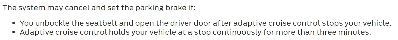

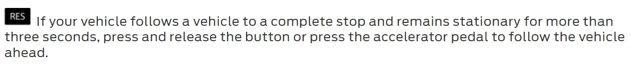

Feature, not bug:
Ford Maverick ACC 3 seconds after stopped 1698942034767
If you are parked for 3 minutes, truck automatically move to Park:
Ford Maverick ACC 3 seconds after stopped 1698942102812
