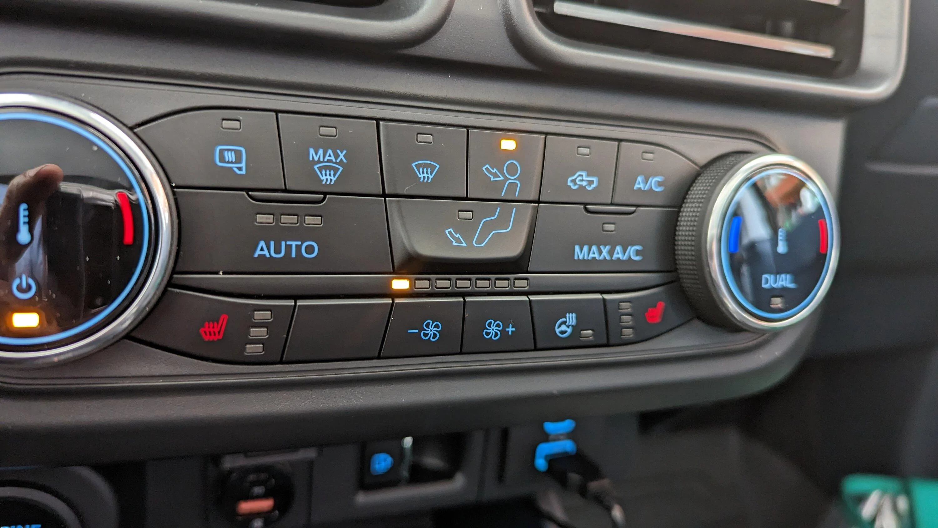

Thank you for the help..I am looking for any help from experienced members but no I am not remote starting the truck. I have actually turned off anything possible from auto updates, modem auto headlights. If I turn off the AC that might work but I do want the fresh air fan flowing air and that turns it back on. I tried that last night after seeing some people mention turning off AC altogether but that also turns off the fresh air fan. Still open to any thoughts but right now every time I start the truck I have to release the silly parking brake, turn off stop start, turn off AC so I can drive with my windows open or just outside air from the fan. This is not convenient, if that is what they were trying to do. There was nothing wrong with the older method of turning AC on when you want it or putting in automatic ac mode. All my other 6 cars, yes I have 7 cars now with the Maverick work fine. I have no issue in automatic mode if it does this.
Set fan speed to whatever.
Set vent selection to whatever you want.
Set temp to Lo.
Confirm NO recirc if wanting outside air of course.
Confirm Auto is NOT pressed. It shouldn't be coming back on if it was turned off with truck off.
Turn HVAC off and then truck off with those settings.
Should remain when turning truck on, and then HVAC back on.
If it does that right - test just turning truck off, and then back on. Should really hold too.
That way not messing with HVAC off/on.
Those settings use outside air.
Unless the AC button is pushed - then AC is turned on as you'd expect.
Now, this does NOT prevent the hvac system from turning on the AC in the background if the humidity is seen as too high - which it could if windows open and just right temp.
But when this happens, the AC button is not enabled - AC is just running, so it may be felt, until it turns off. In EB you may hear compressor, hybrid never have.
But if driving in those specific probably not likely conditions with windows open - turn off the hvac.
There are times the AC button will enable.
My son yesterday understood the Lo for outside air, and set fan speed - but failed to select vent, not sure what default was at that temp, I think still on defrost and foot vent, but I was comfy so not paying attention. On startup later without everything selected and humid in cabin - AC button was enabled. I disabled and selected upper vent.
I don't recall ever seeing that happen when I actually had all selections done.
But if I don't have it totally in manual mode (3 selections), it seems AC button could be enabled if conditions right.
But unless I hit a glitch, I don't believe I've seen it otherwise.
