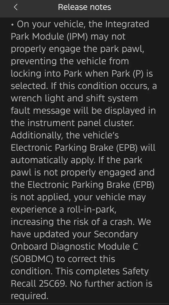

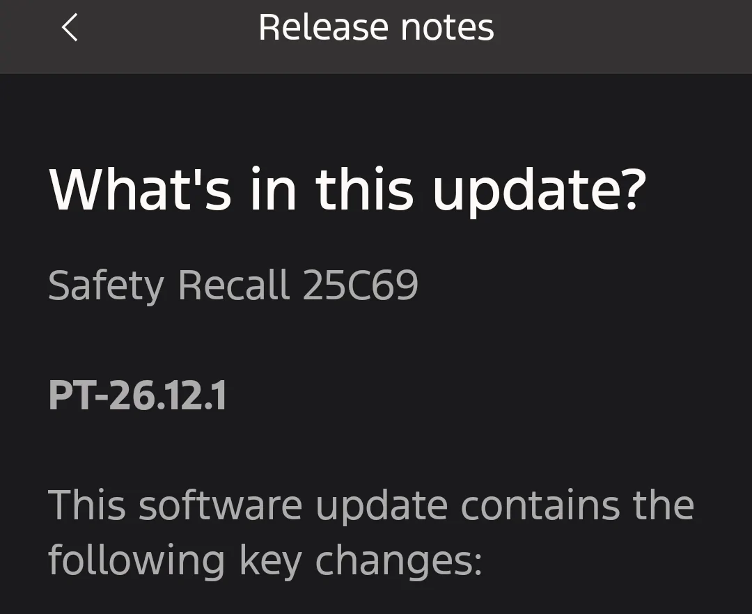

I received an update of some sort Monday night that was supposed to take care of a recall I had but can't remember what it was about

You can check your Ford App, if you have it, to see your updates, if you want.
Easier then going out to your truck!
Cheers,
Andy
THANKS, it was PR-26.12.1 for safety recall 25C69 (parking brake). I still showing needing the trailer module reprogramming update 26C10.
Probably this one:
