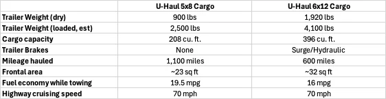

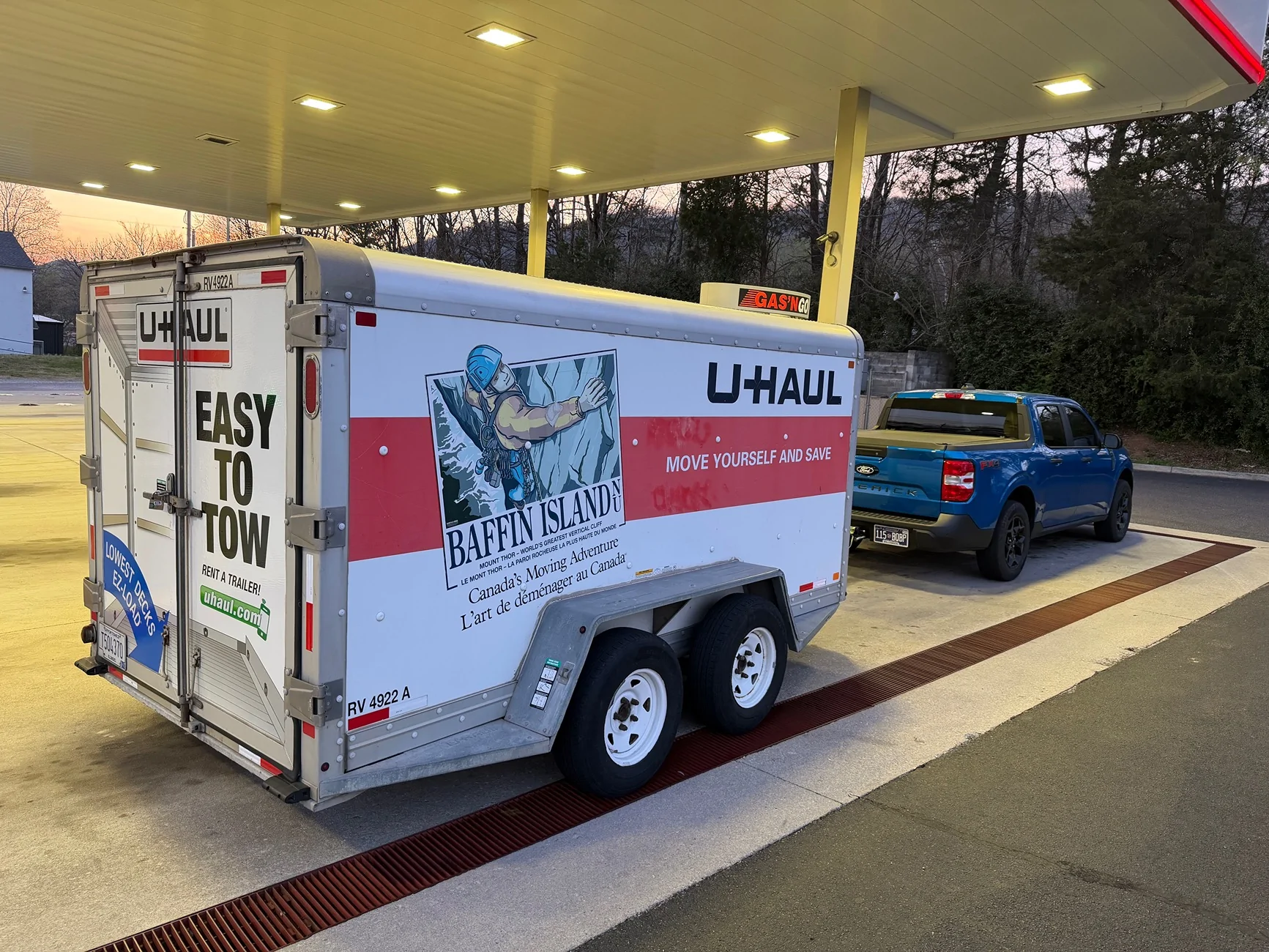

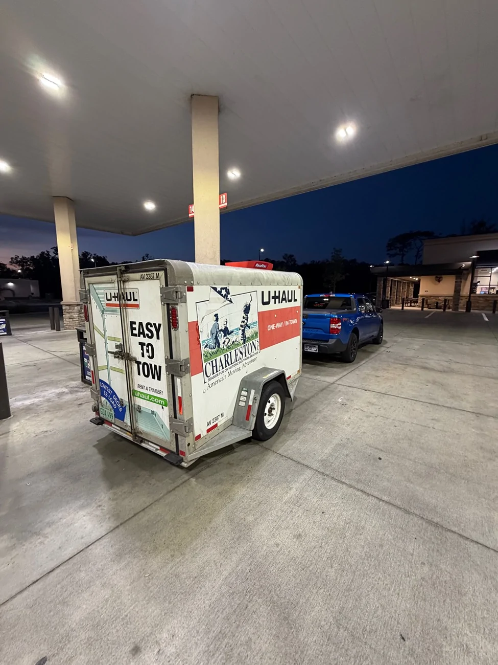

I just returned from a 1,700-mile trip towing two different U-Haul trailers behind my 2025 Maverick XLT EcoBoost AWD/FX4/4K Tow. Overall, the truck did great in some challenging mountainous terrain. But what struck me the most was how different the experience was between hauling a U-Haul 5x8 Cargo trailer vs. the larger and heavier 6x12 Cargo trailer. In a nutshell, the 5x8 was well suited to the truck and pulled smooth, while the 6x12 was clearly pushing the limits of what the truck can safely tow — especially due to its larger frontal area, added weight and some not-insignificant elevation/windy conditions in the Great Smokey Mountains.
I know there have been various posts of Maverick owners' experiences towing both of these trailers, but what was unique for me was having the opportunity to tow both nearly back-to-back in the same week.
Here are some insights and stats to chew on:
Ford Maverick A Tale of Two U-Haul Trailers (Towing Report) 1774645658618-yf

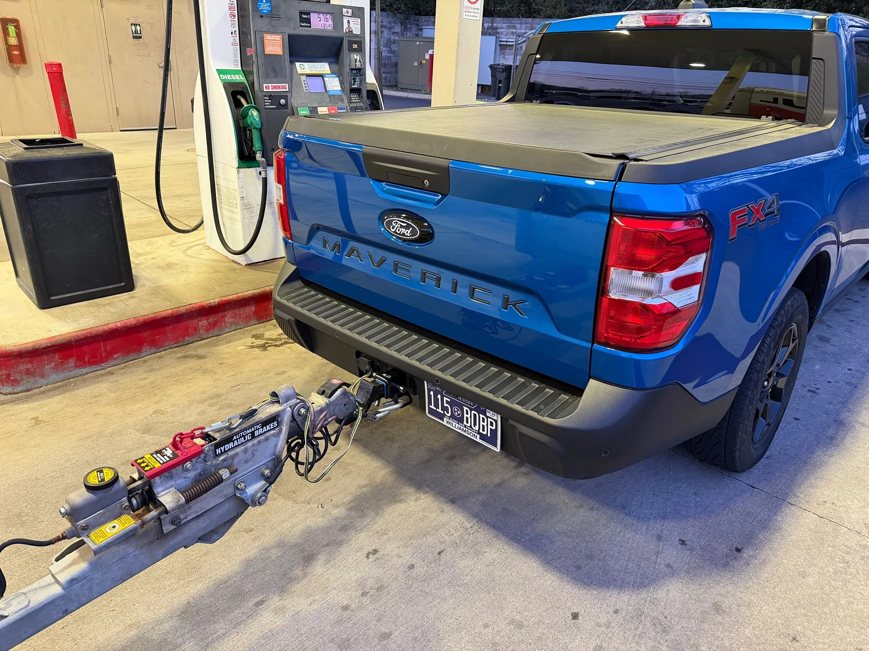

The 4K tow package did its job with both trailers. No sway to speak of even in very windy conditions, and I used Tow/Haul mode for the entire trip, which was essential to helping the truck get up some long pull grades in the mountains. The fuel economy suffered, but mid-to-high teens isn't terrible considering the conditions I was towing in (very windy, mountainess) and the fact I was trying to keep a steady speed of 70 mph throughout most of the trip. Cruise control was activated for probably 75% of the time as well.
The addition of the trailer surge brakes was noticeable on the larger 6x12 trailer and fully welcomed especially in the mountains.
If you're debating between the 5x8 U-Haul Cargo or the larger 6x12, I'd tell you to stick with the 5x8 unless you absolutely need the additional space. You can fit an entire queen bedroom in the 5x8 if you pack smartly and the truck will pull it with no sweat. I pulled the 5x8 from south Florida to Nashville and then on to Memphis and it was a pleasant experience. A few days later I needed to move my son out of his apartment in North Carolina back to Nashville, so we went with the 6x12 for that trip. We needed every inch of space the 6x12 could offer, although due to the items packed inside we weren't maxing out the trailer's weight capacity but definitely on the bubble for the Maverick's 4k tow rating. And that larger trailer frontal area in the 6x12 showed up in the windy conditions where it was obvious the truck was loaded down in the mountains.
Bottom line: the Maverick tows well and will handle either a U-haul 5x8 Cargo or the larger 6x12, as long as you have the 4k Tow package and observe the weight capacities of trailer+cargo.

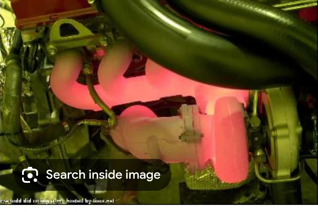

What I picture. When I hear of a vehicle with turbocharged gas engine pulling a heavy trailer under constant load up a mountain grade
Uphill towing a heavy trailer. 😬😬
Ford Maverick A Tale of Two U-Haul Trailers (Towing Report) Screenshot_2026-03-27-17-05-09-91_40deb401b9ffe8e1df2f1cc5ba480b12
I don't believe anybody said, it couldn't be done but at what cost ?

Very true. I would put the 6x12 in the “getting stressful” category at 70 mph based on my fully loaded weight. It was never dangerous as it was perfectly level, was loaded properly including appropriate tongue weight and had no sway. And of course how you drive — leave plenty of distance to stop, stay out of other vehicles’ way and pay attention to what the truck and trailer are communicating to you.

In general U-Haul’s rule is that the tow vehicle has to have a curb weight at least as heavy as the unladen trailer. The 6x12 is 1,900 lbs empty, so roughly half the weight of the Maverick.
The trailer as loaded was right on the Maverick’s 4k tow spec, so it handled it fine. But I wouldn’t have wanted to go any higher or bigger. The 6x12 fully loaded is reaching the limits of what the Maverick can and should tow. Which was the point of my post — not unsafe but getting stressful.
