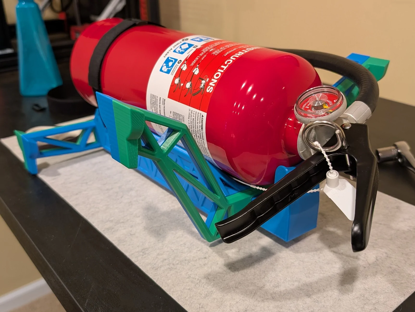

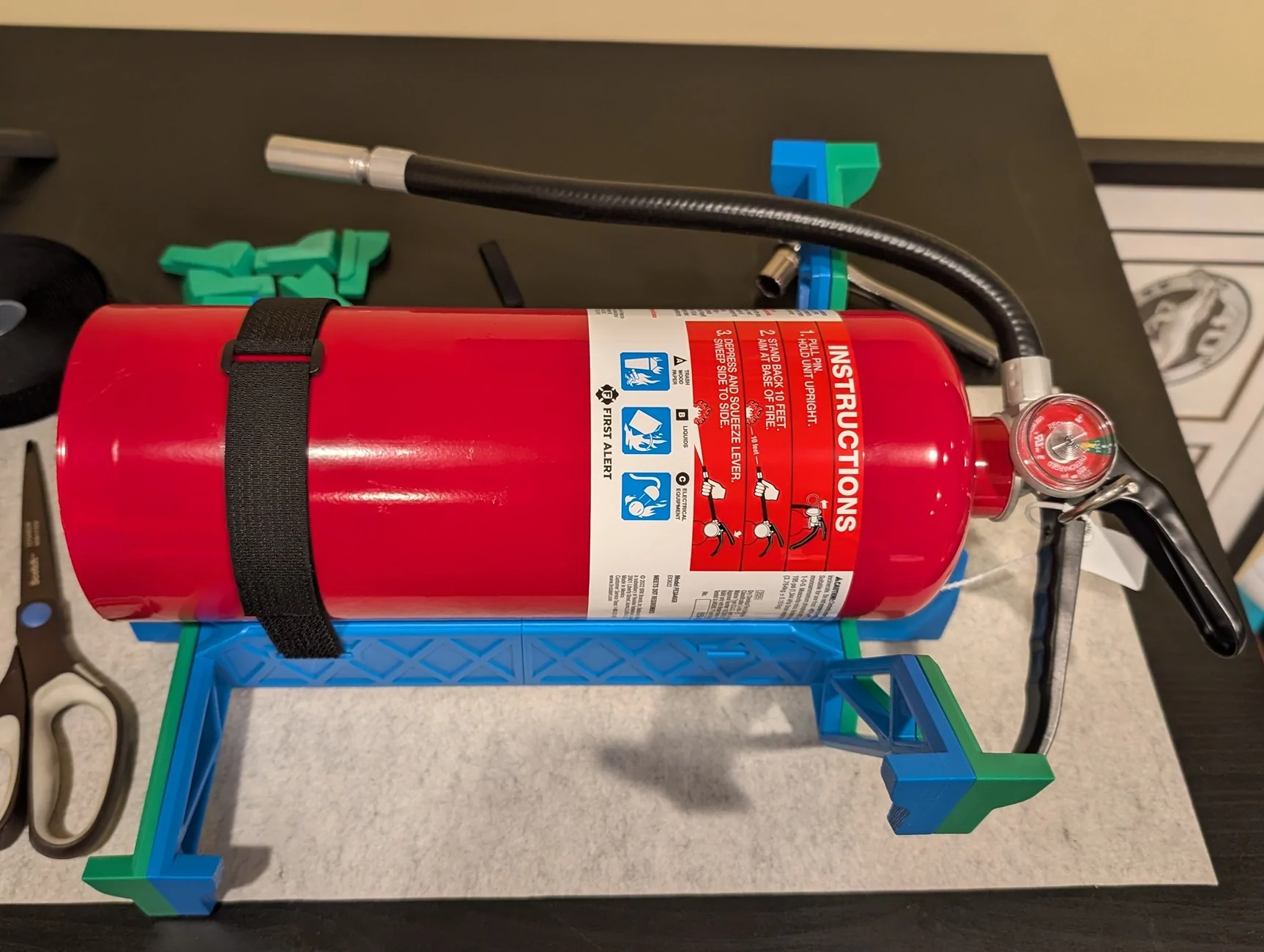

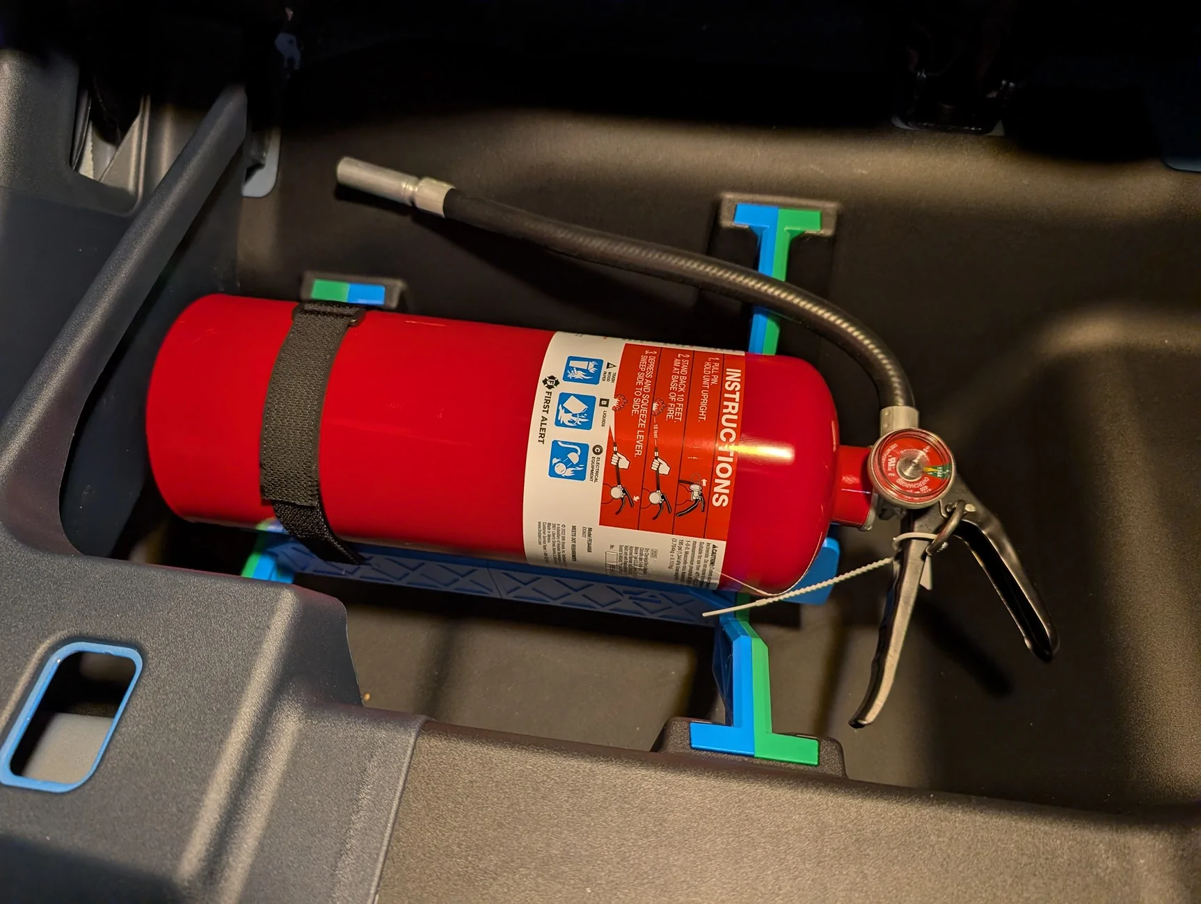

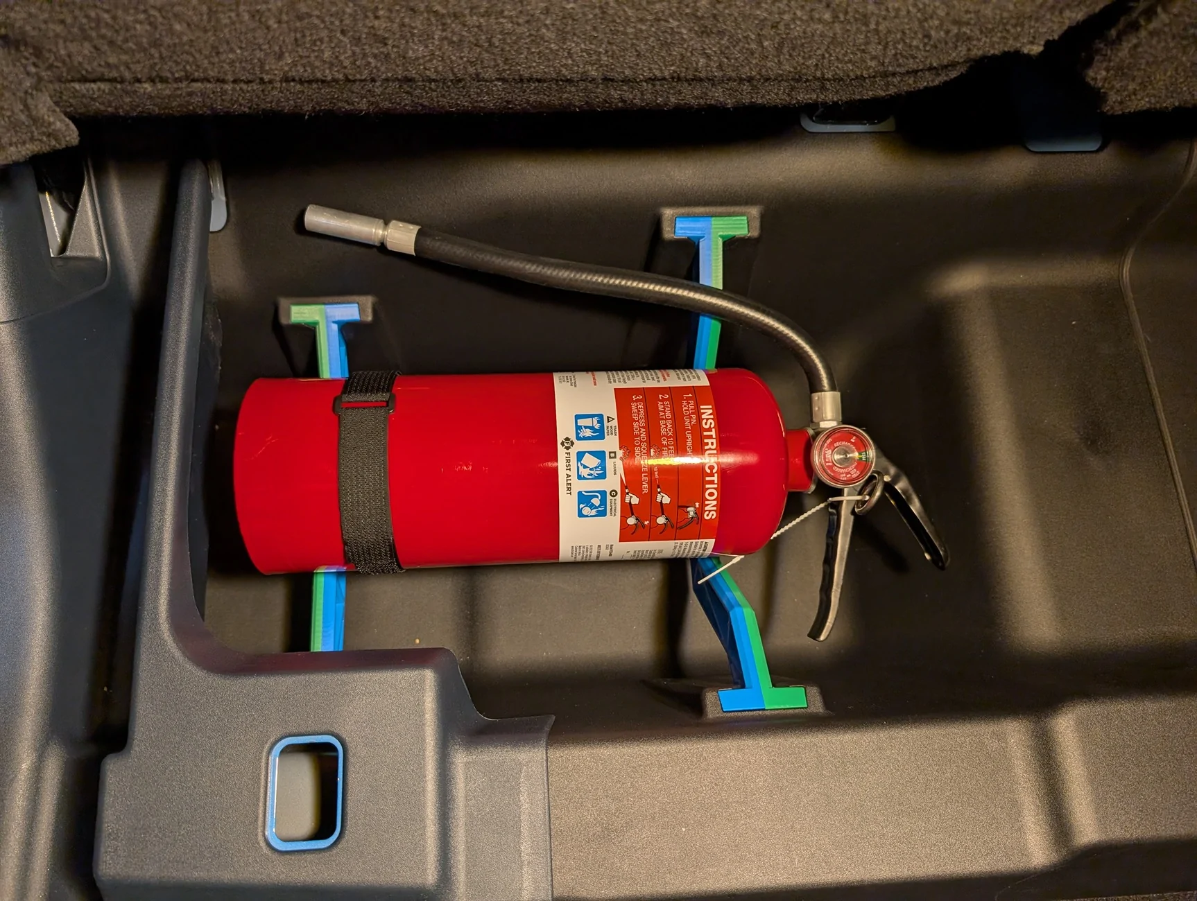

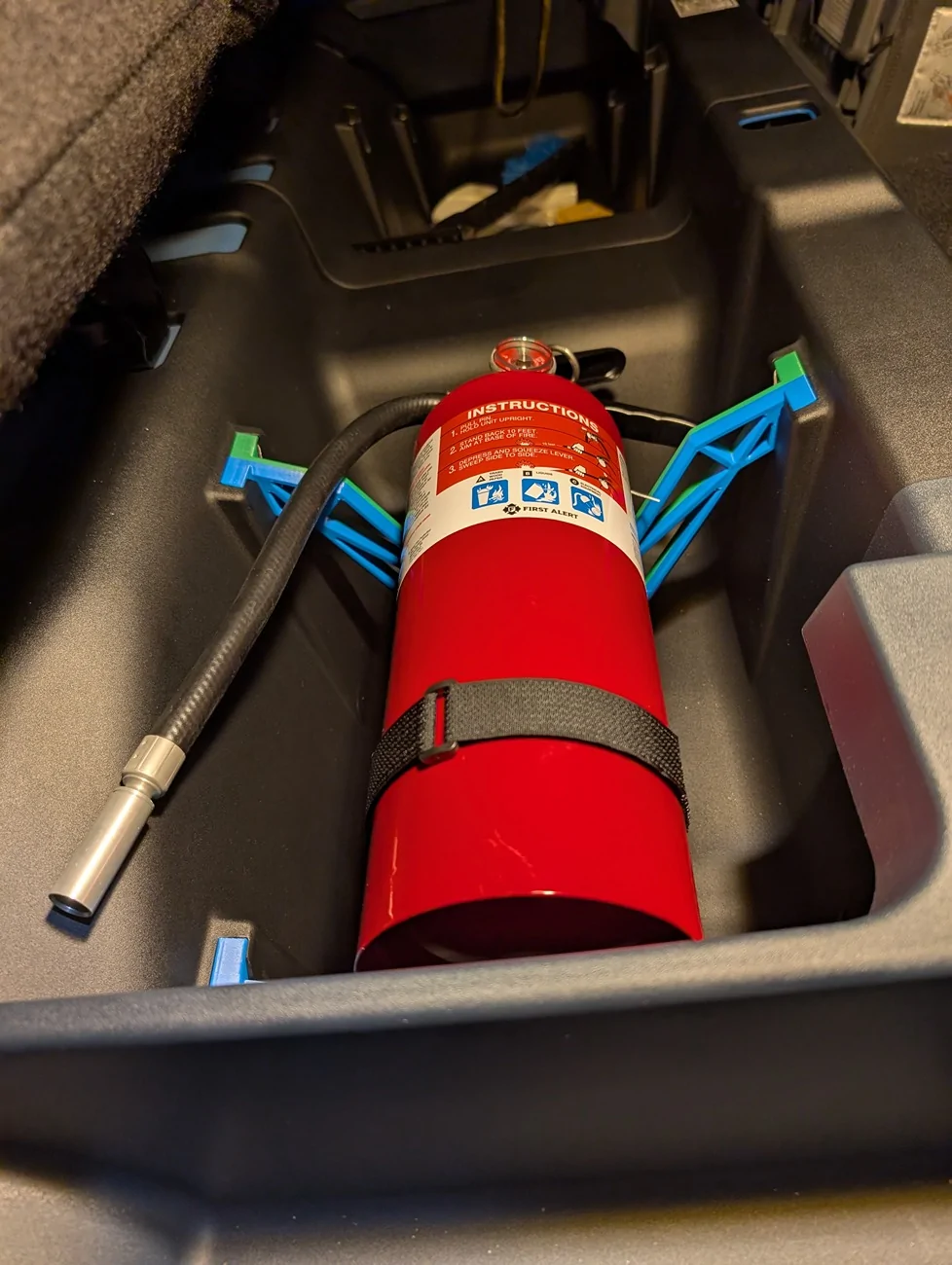

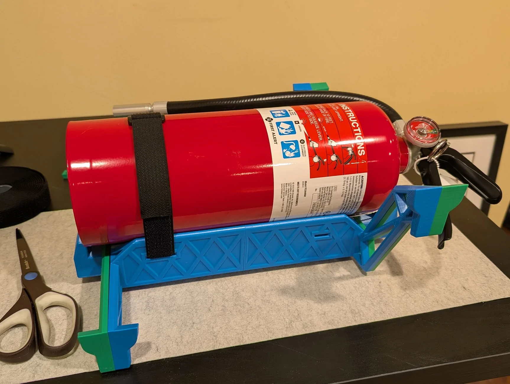

Currently working on an under seat "5lb" (~8-9lb gross) 3D printable fire extinguisher mount. I'll probably share the final version on my Printables account if anyone's interested.
There will be a driver and passenger side version. Might work on a mount for a 2.5lb as well.
These photos are of the first prototype. The revised version tweaks the geometry a bit, adds a second strap, and includes a feature to secure the hose (if your bottle has one).

Wouldn't it be better to have it somewhere else for easier access in case you need it? Under the rear seat is impossible with child seats, or people in the back seat.

Well sure, but this is a forum for the FITS anchors and the only one not under the seat is the one on back of the center console. I may design a 2.5lb bottle mount for that one in the future. Personally I prefer larger fire extinguishers in my vehicles, but I think a single FITS anchor might be too wimpy for a 5lb bottle.

A 3d printed plastic mount is OK under the latched rear seat, where the extinguisher can't fly out during an impact / rollover situation.
Anywhere inside the cabin you need a mount made of ductile metal, which can't break and let the extinguisher bounce around inside the cabin in a crash. Porsche OEM and aftermarket extinguisher brackets are ALWAYS metal, and they bolt securely to the seat bracket or other hard mounting points.
Also a plastic bracket under the front seat could fail from the heat and let the extinguisher roll under the pedals, potentially causing a crash.

Definitely switch which side the handle is on. In an emergency I would want it close the door so I don't have to reach farther into vehicle. Ergonomics and such.
Could you get away with a wider single strap in the middle for simplicity? I'm not sure on the strength of the plastic. Would need to move the break or make it three pieces, though.
As for the hose, on the big trucks I just strap it in. Beats feeding the strap between the hose and bottle. Might save you some work.
Once you get settled on the bracket, see if you can modify the outriggers going to the FITS. Keep them low to use the walls of the bin as horizontal support (won't need to rely on the truss network) and then up to the FITS. May also give more space for other emergency items to be placed next to the extinguisher.
You are right to express concern about the durability of any fire extinguisher mount and that is one of the main reasons I designed this one for under the rear seat. If all else fails, it is at least contained under the seat. However, not all aftermarket mounts are metal. I have one in my Mustang that is made out of fiber-reinforced nylon that was manufacturer certified to 27G.
All good suggestions! The design of the mount is modular to the extent that you can mount the bottle in either orientation. User's choice. I just happened to mock it up with the handle toward the inside of the truck for these photos.
Also- I was actually considering a single, wider strap in the middle, but I happened to have this 1" wide stuff laying around. I may still do a single wide strap.
Part of the game I'm playing with the geometry is to keep it printable on a Bambu X1C. The truss section on the big end uses up the full build plate. I might be able to play with it a little to regain some of the storage space, though.
