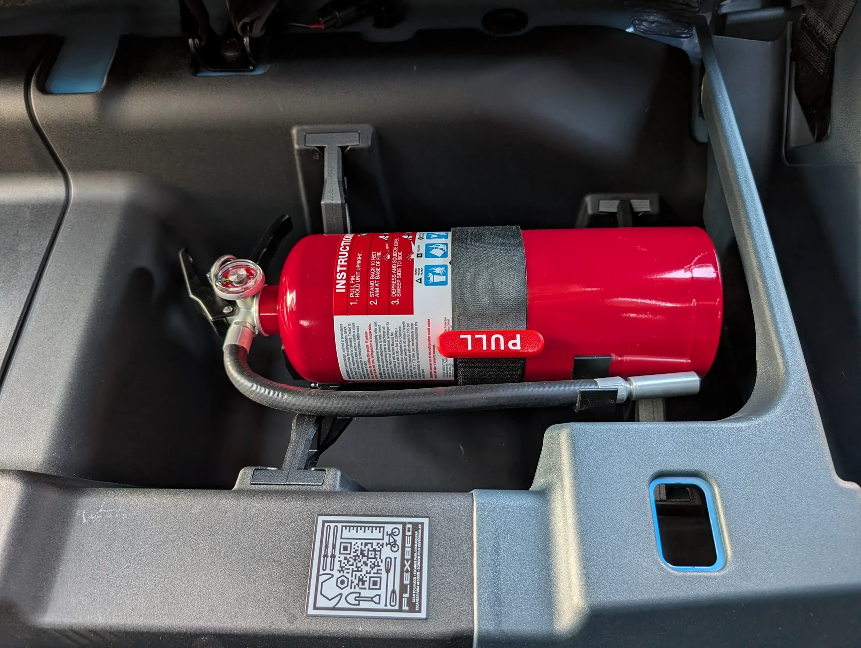

OK, the design is complete and all the files are available on my Printables page:
https://www.printables.com/model/1645141-ford-maverick-fits-under-seat-fire-extinguisher-mo

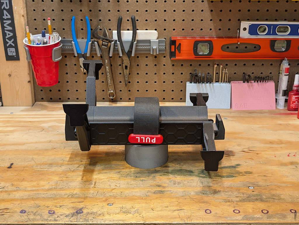

Changes from the prototype:
  • Truss sections tweaked to be stronger and more rigid.
  • The design is now configurable to be installed on either side of the truck, with the bottle in your preferred orientation.
  • Single 2" central retention strap with pull handle.
  • Cool honeycomb cyberpunk aesthetic.
  • I also printed this one in glass fiber reinforced PET and it looks SOOO good. Kudos to Polymaker, this filament is great.
It's pretty straight forward, but feel free to ask questions about the build or print settings.
