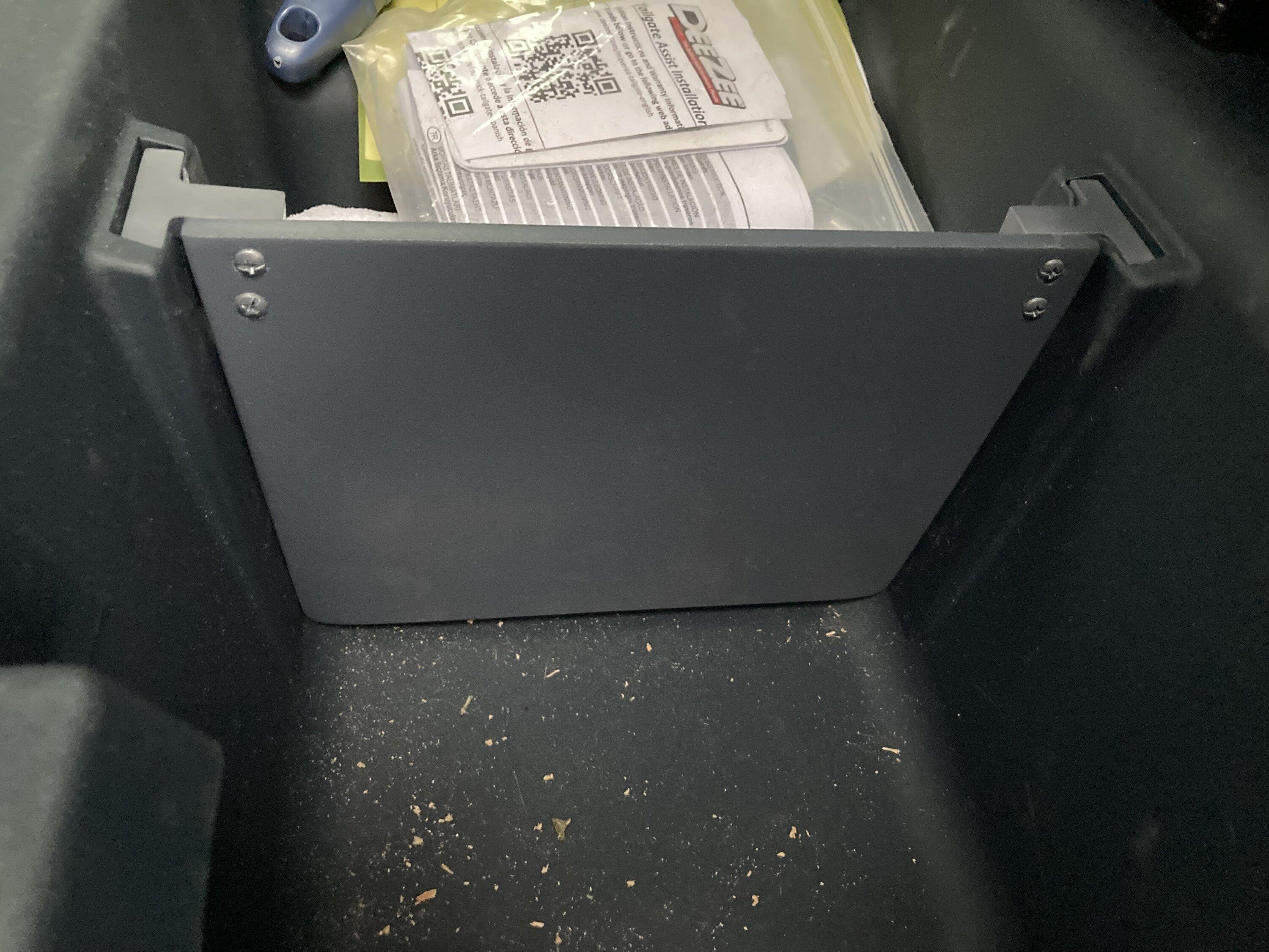

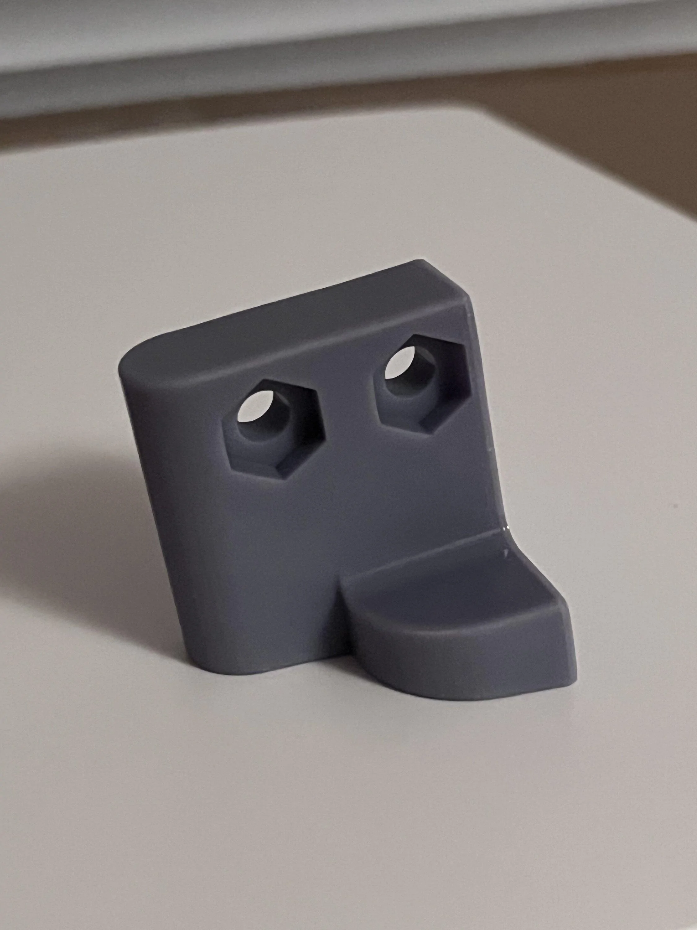

I believe I still have some of the under seat divider pieces my son 3d printed for me. Let me check when I get home. I have them in my truck (they're just the FITS pieces, requires plywood or something else to hook to it) uploading a pic

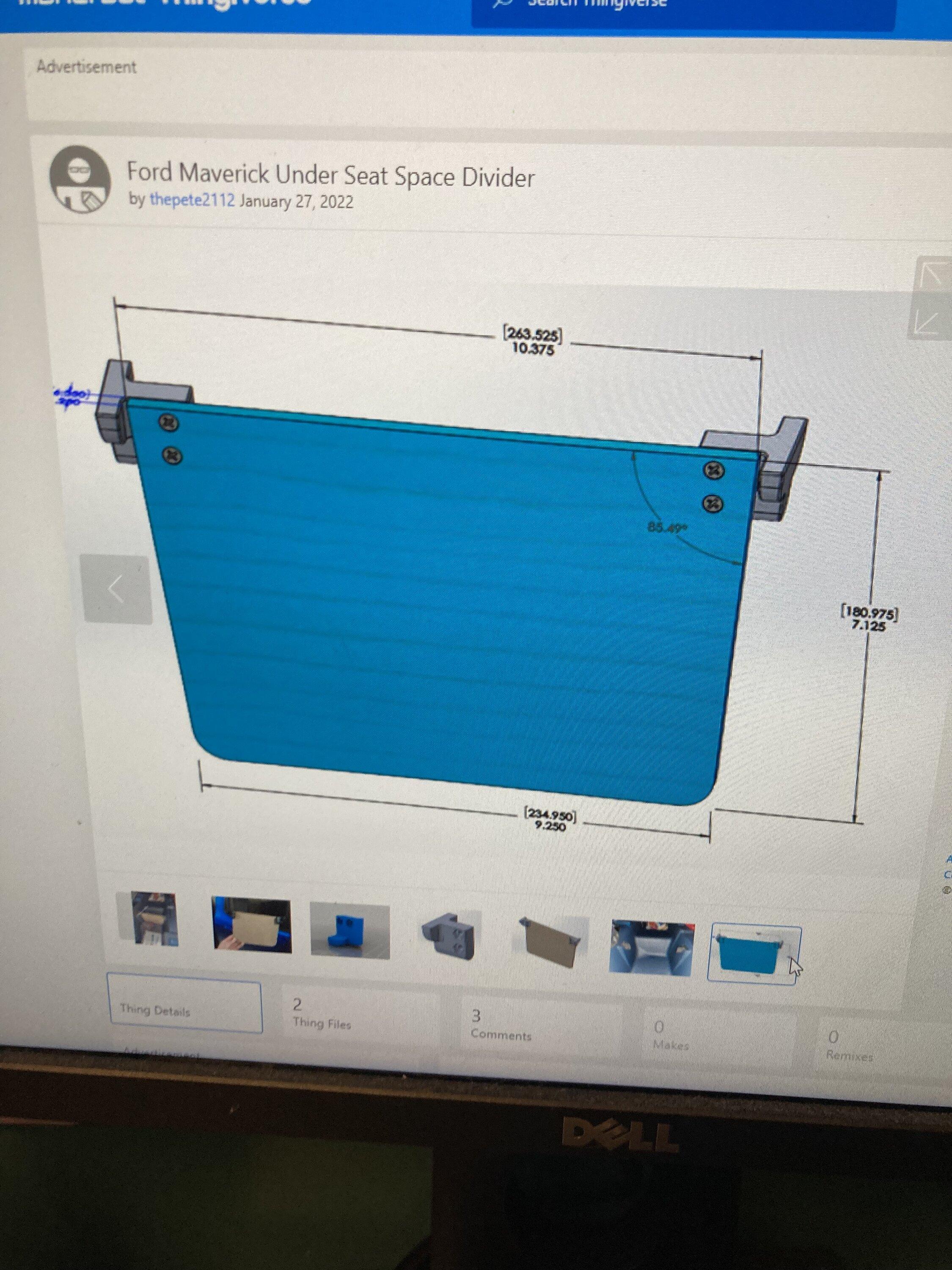

Thanks, I have downloaded those files and but wanted to see if there were any aftermarket options before I went this route. Did you end up building them? I just figured if I could purchase some for $20 it would save time and would probably end up costing about the same.

I used them in my truck and used 1/4" plywood that I plasti-dipped to make the dividers. pretty easy. I only have one divider under the seat (hybrid)
I had son print a good bit of small items, but postage being what it is, wasn't feasible to offer something for $2.50 with postage at $5.

Those look great! I've got them running on my printer now. I keep a bunch of stuff under my seat and need a solution. Are the cut dimensions pretty accurate?

yes...........I cut a piece of cardboard first to make sure it fit properly
