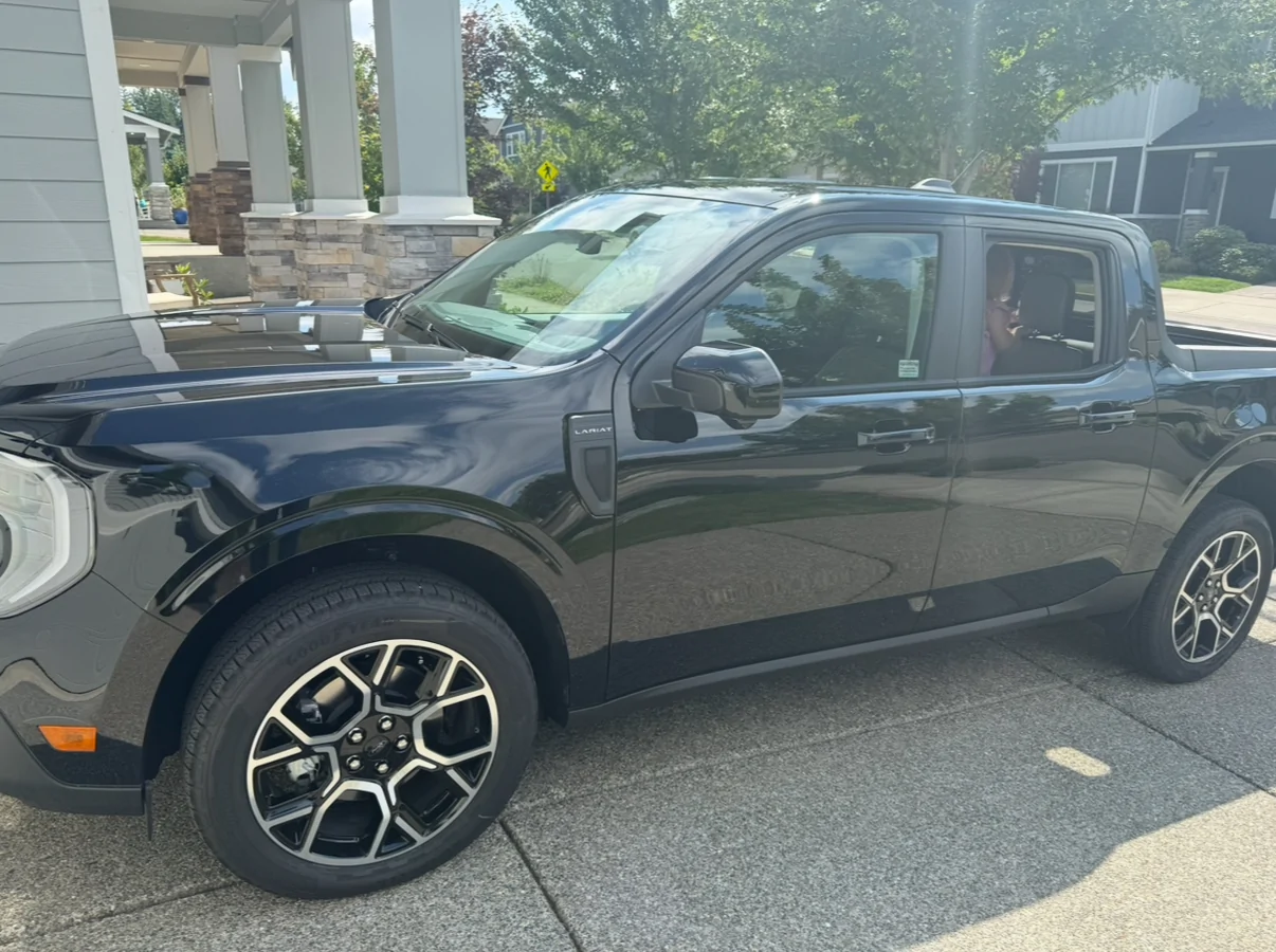

Personally didn’t understand why 19s in the first place but excited to get exactly what I wanted. Perfect for me in the PNW. Rides better with more sidewall, no discernible difference in MPG yet but happy to follow up.
Thanks for all the posts on the 245s I love the look!

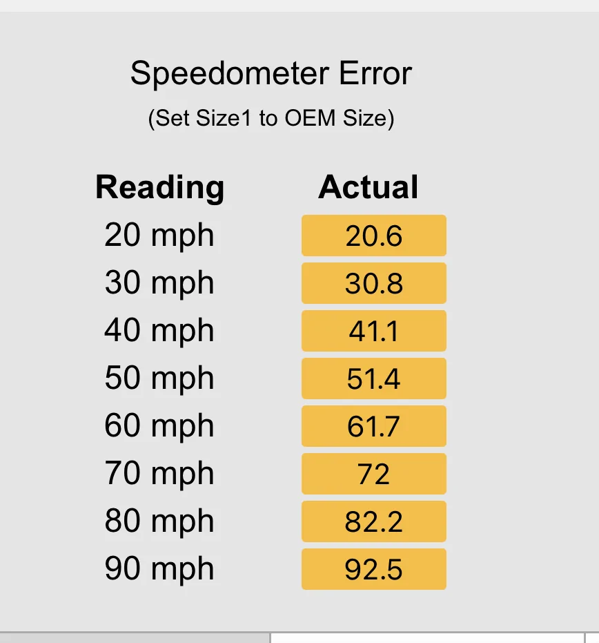

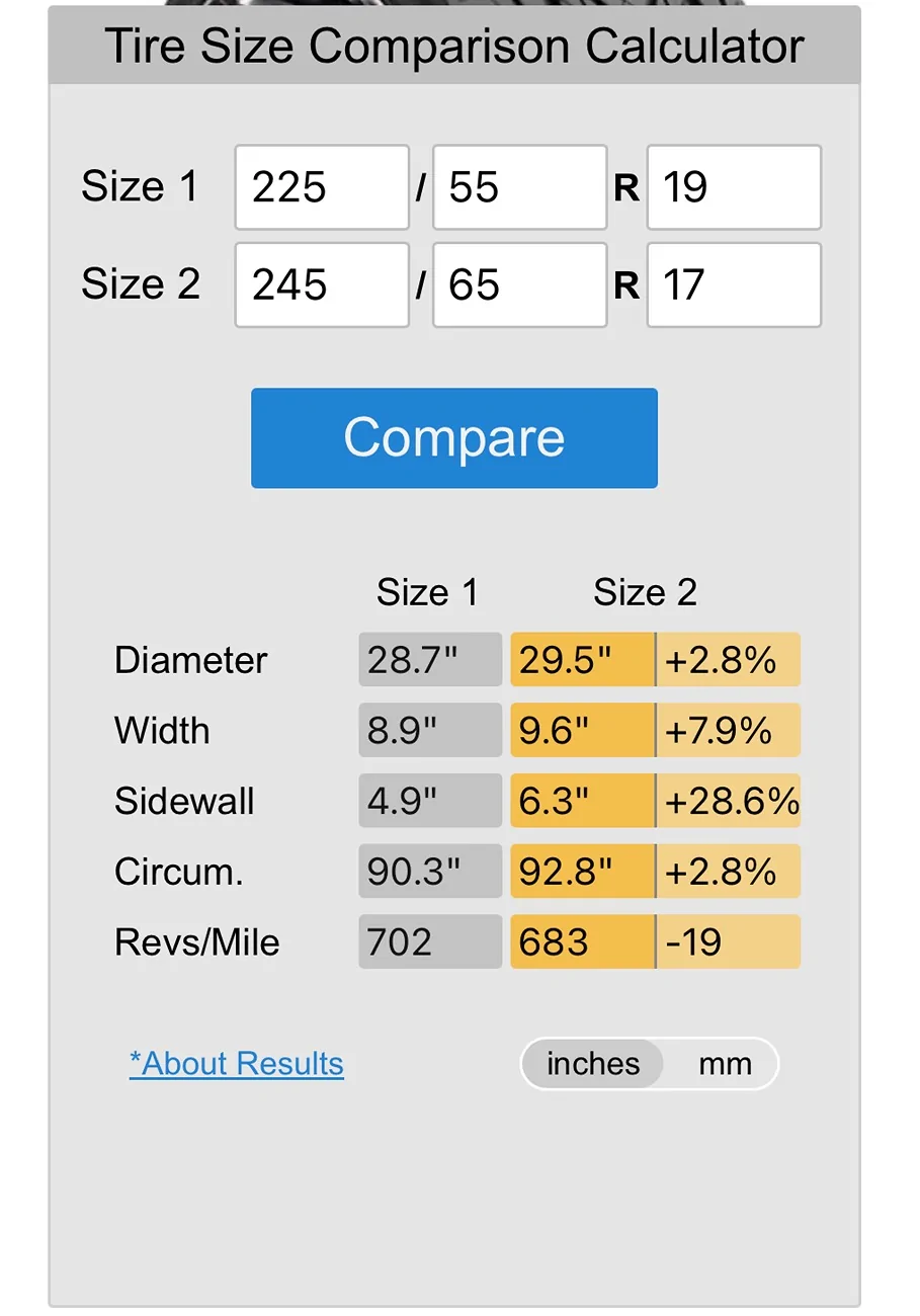

Have you noticed any discrepancy in your speed (car vs gps)? I went to 17's for my snows vs 18 that came with the truck. Tire dealer said that the speed would be off slightly. They said when showing 65 in the truck it would be 64.75 in actuality. Figured it was close enough, but that is not the case. 70 or higher I am off 2 to 3 MPH... Though I can compensate with my foot, miles to empty is now way off. Have found (when towing my snowmobile trailer) that when the truck is showing 10 to 25 miles remaining to empty, the gas gauge is still showing a quarter full (sometimes more). Is that any way that the tire size can be adjusted in the truck so that the speed numbers are correct (dealer or forescan)?
Off a couple mph at 70 seems right on according to the tire comparison chart:
Ford Maverick Goodbye 19s. Hello 17" Fifteen52 + 245/65/17 Open Country AT3 IMG_2073
Ford Maverick Goodbye 19s. Hello 17" Fifteen52 + 245/65/17 Open Country AT3 IMG_2074
Thanks for the heads up, I hadn’t really considered the impact to the odometer being that big of a deal considering it’s only a less than 3% difference to the revs per mile. I’ve read that you can update the tire size in the software but I’ve never used forscan. Maybe the dealer can do it?
