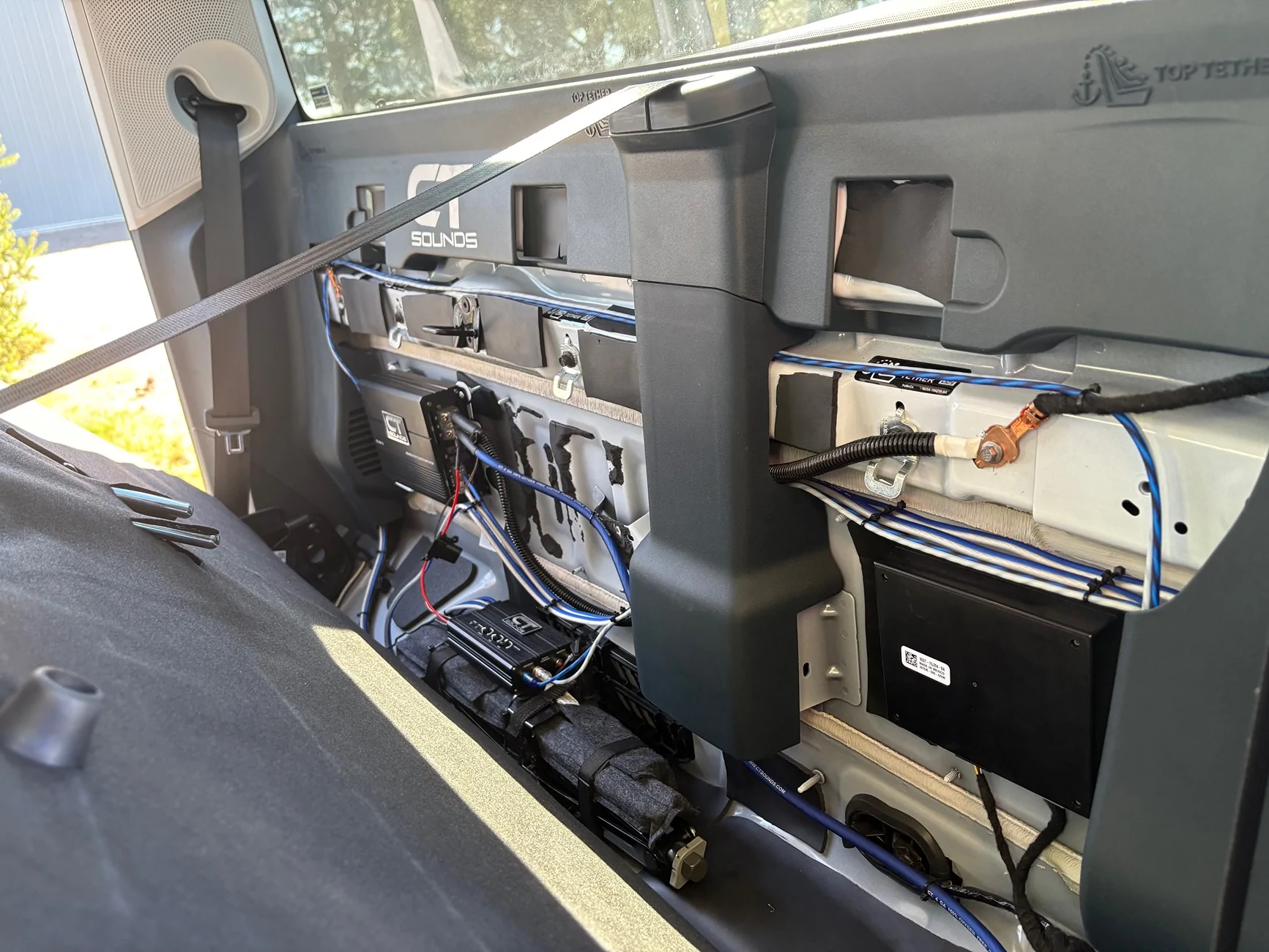

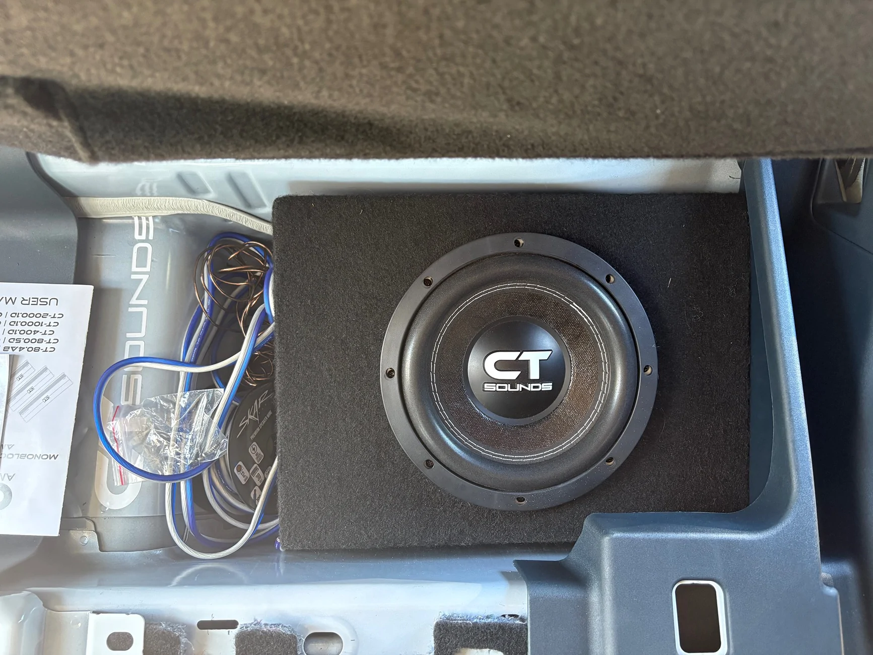

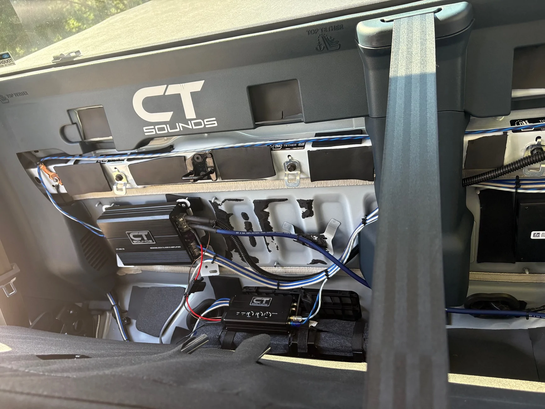

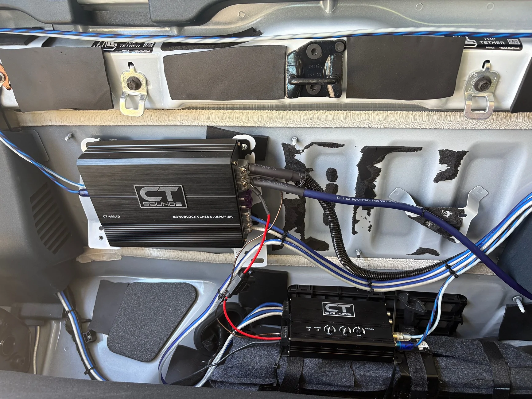

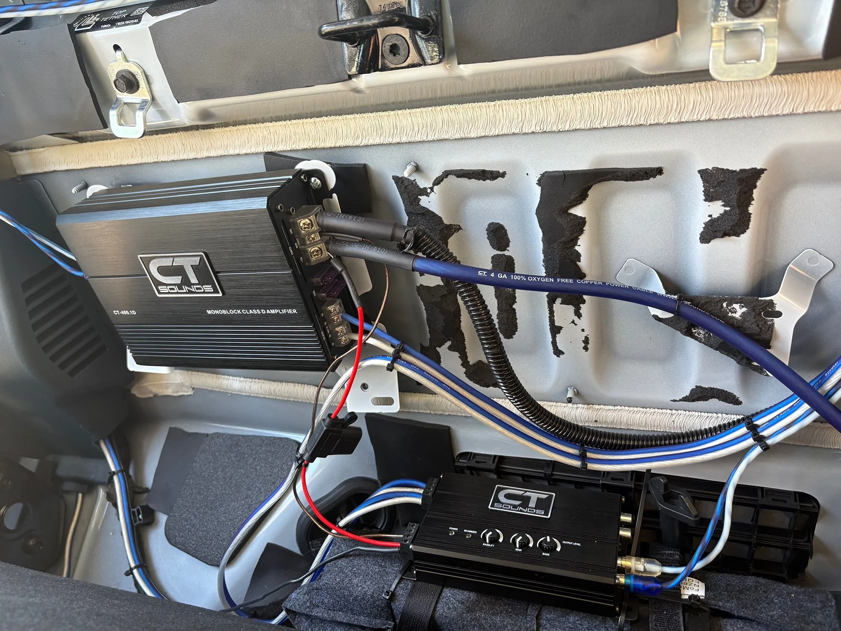

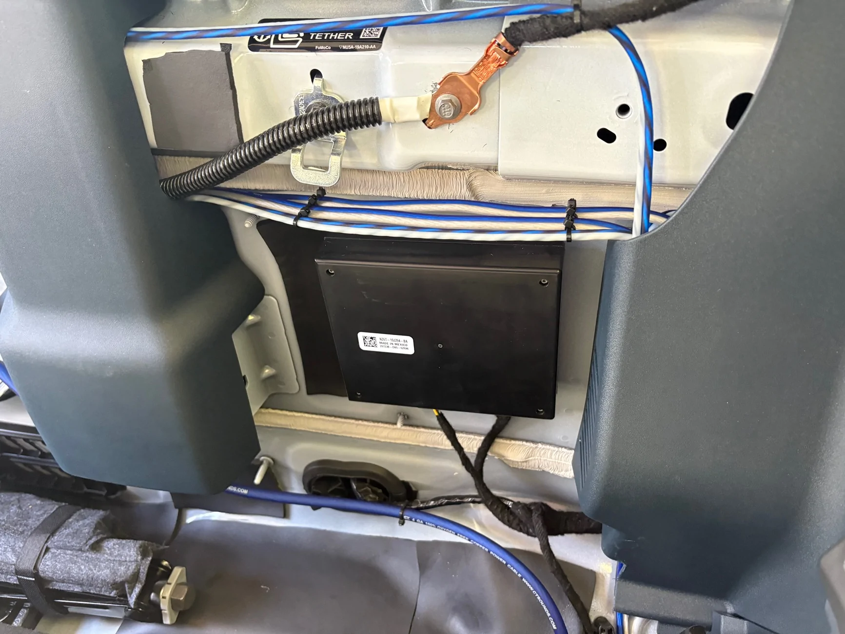

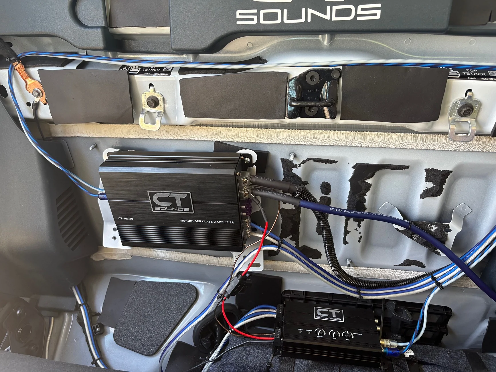

I found a subwoofer box on Amazon that would fit underneath my rear seat, although I did have to remove the plastic trim that was underneath and make the hole slightly larger to fit my sub, nonetheless I am extremely pleased with the completed build. I used a line output converter to get signal and tapped into the front speakers underneath the kick panels to get the signal, because I’ve been advised the rear signal does not have bass frequencies.I do plan on adding another amplifier from CT sounds either the 80.4d or the 150.4 d to power the 4 kicker CS series speaker I installed in my doors and rear pillars previously
LMK if you have any questions or suggestions

Here are links to everything I used
Amplifier -https://www.ctsounds.com/collections/ct-series-amplifiers/products/ct-400-1d
Price - $119.99 (on sale)
Subwoofer (2ohm model) - https://www.ctsounds.com/products/hydro-8
Price - $89.99 (on sale)
Active Line Output Converter - https://www.ctsounds.com/products/ct-lc2
Price -$42 (on sale)
Wiring Kit - https://www.ctsounds.com/collections/4-gauge-amp-kit/products/4ga-elite
Price - $79.99 (on sale)
Speaker Wire - https://a.co/d/0WlZgua
Price - $26.34
Subwoofer Enclosure(Had to cut hole larger to fit sub) - https://a.co/d/fEbX7HG
Price - $48
Posi -Tap - https://a.co/d/iiAmVby
Price - $9.90
Inline Fuse Holder (for LOC) - https://a.co/d/dREGx9V
Price - $4.99
Fuse (For LOC) - https://a.co/d/aDlfcb2 (1A Model)
Price - $4.99
Wire (For LOC) - https://a.co/d/ihBznfJ
Price - $7.99
Wire Ferules - https://www.amazon.com/dp/B097ZNCKM...n_lstpd_RW6F63P1WZP6C8F60VND_3&language=en-US
Price - $9.99 (on sale)
Heat Shrink - https://www.harborfreight.com/heat-shrink-tubing-assortment-with-case-140-piece-70172.html
Price - $6.99
Wire Connectors https://www.harborfreight.com/terminal-connector-set-500-piece-70214.html
Price - $14.99

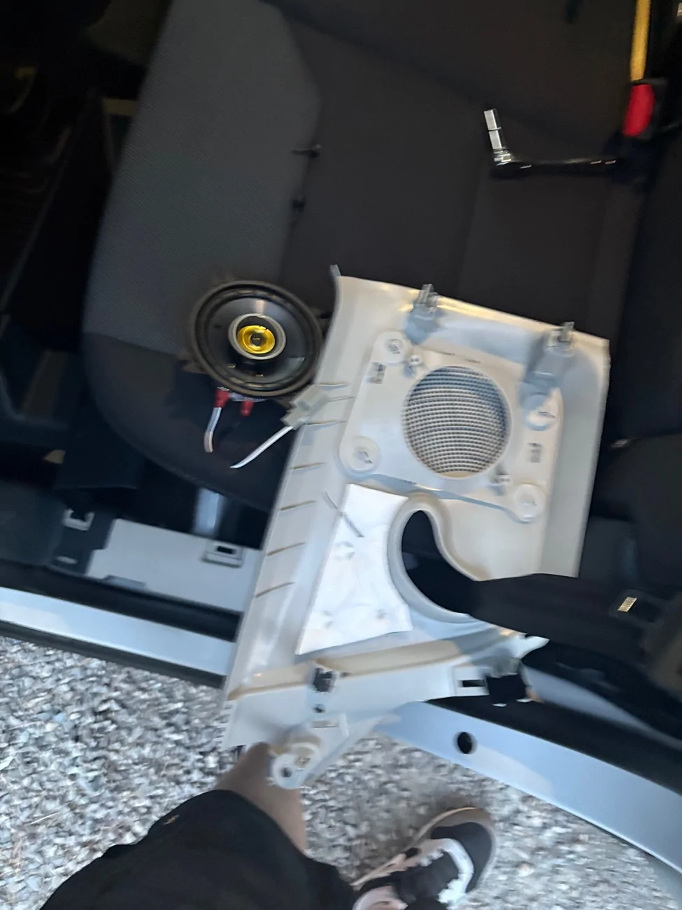

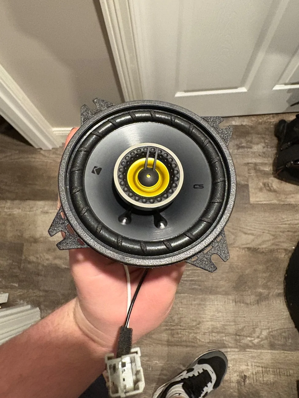

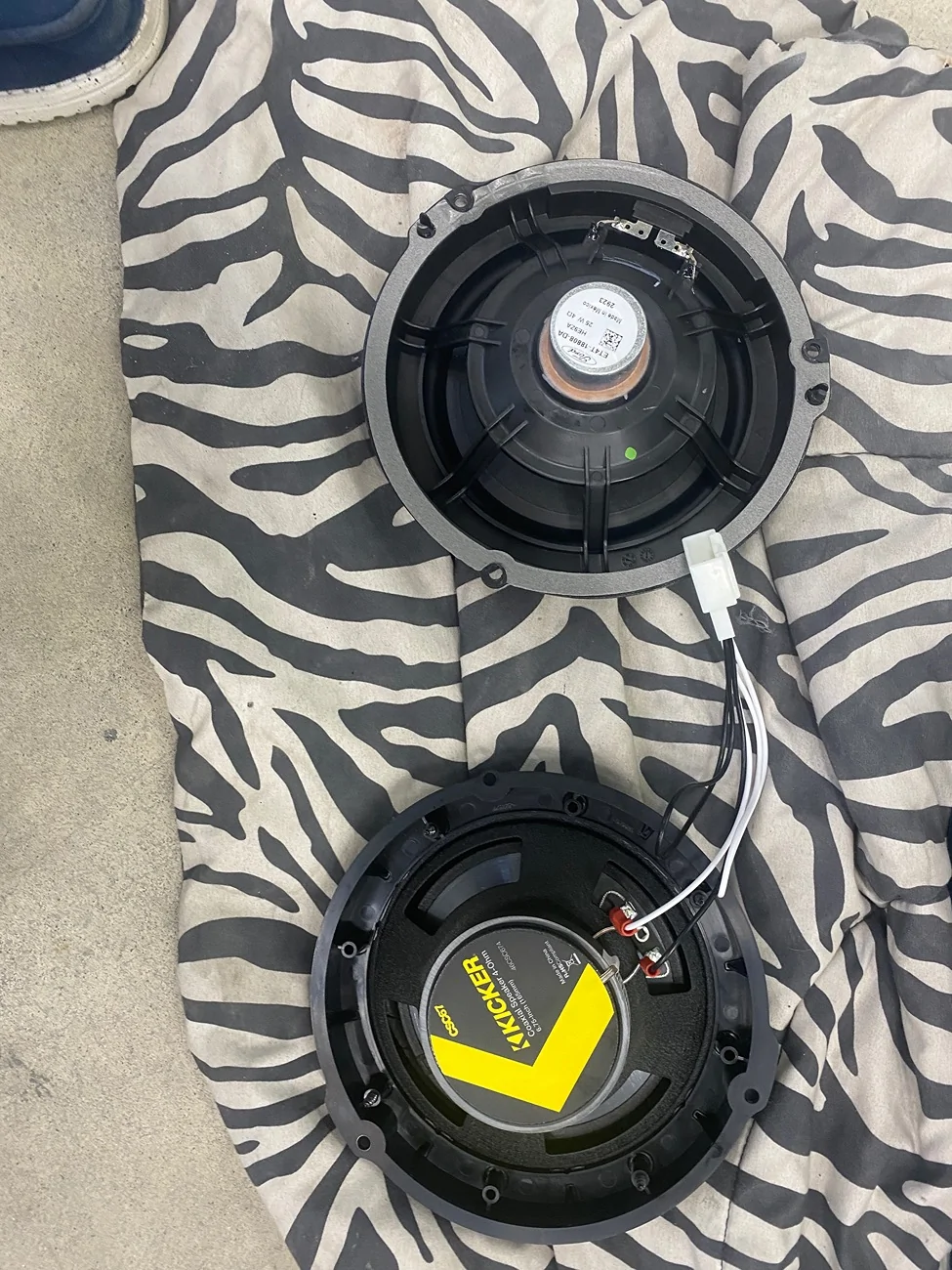

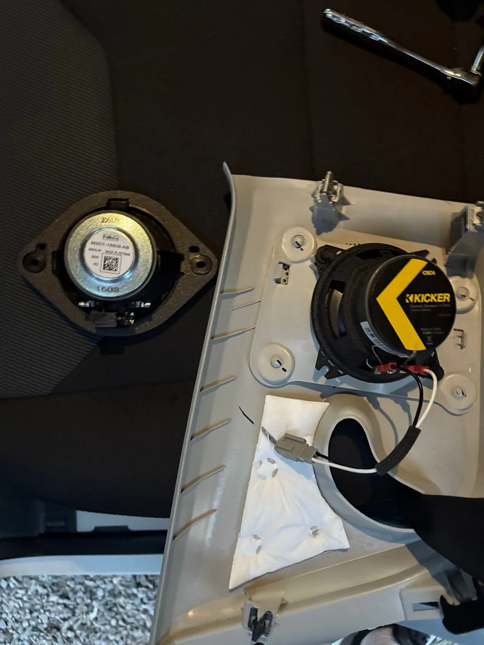

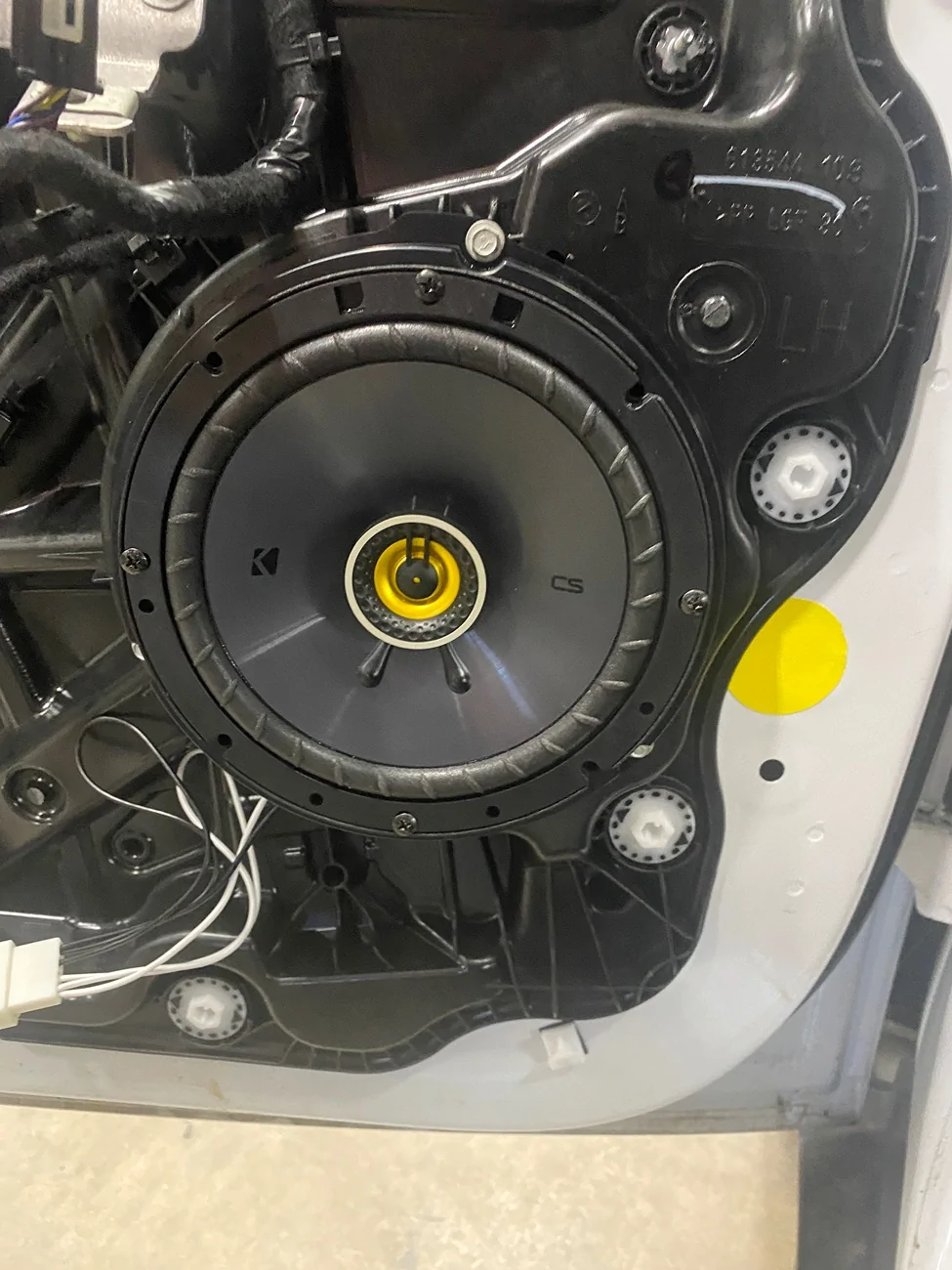

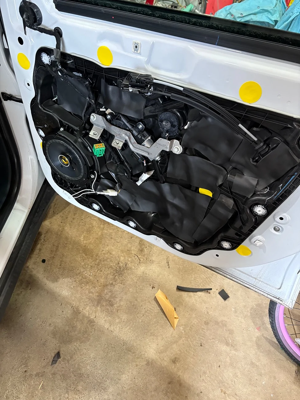

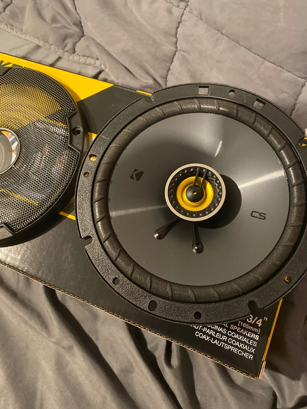

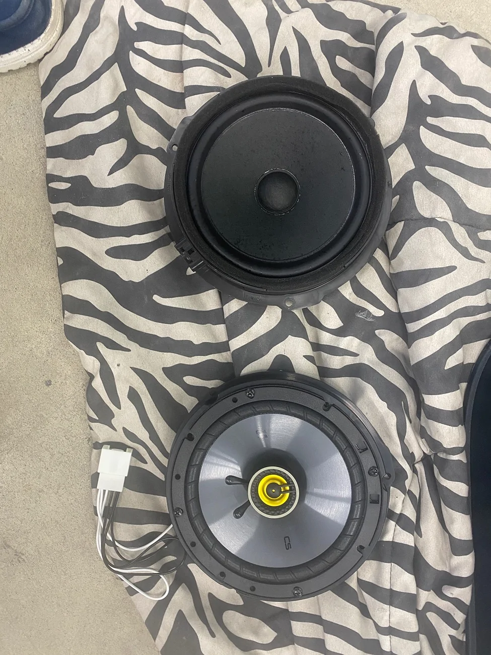

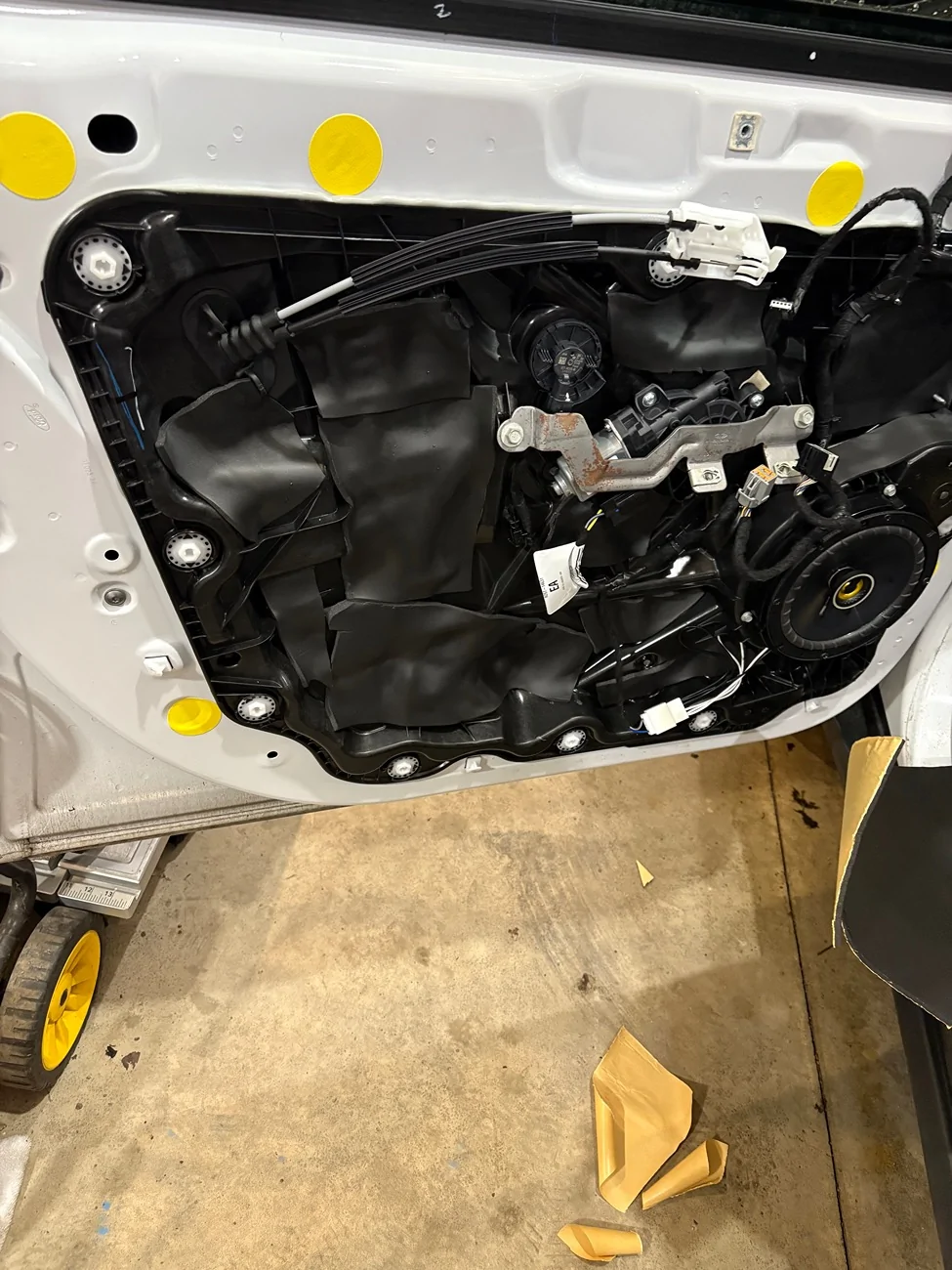

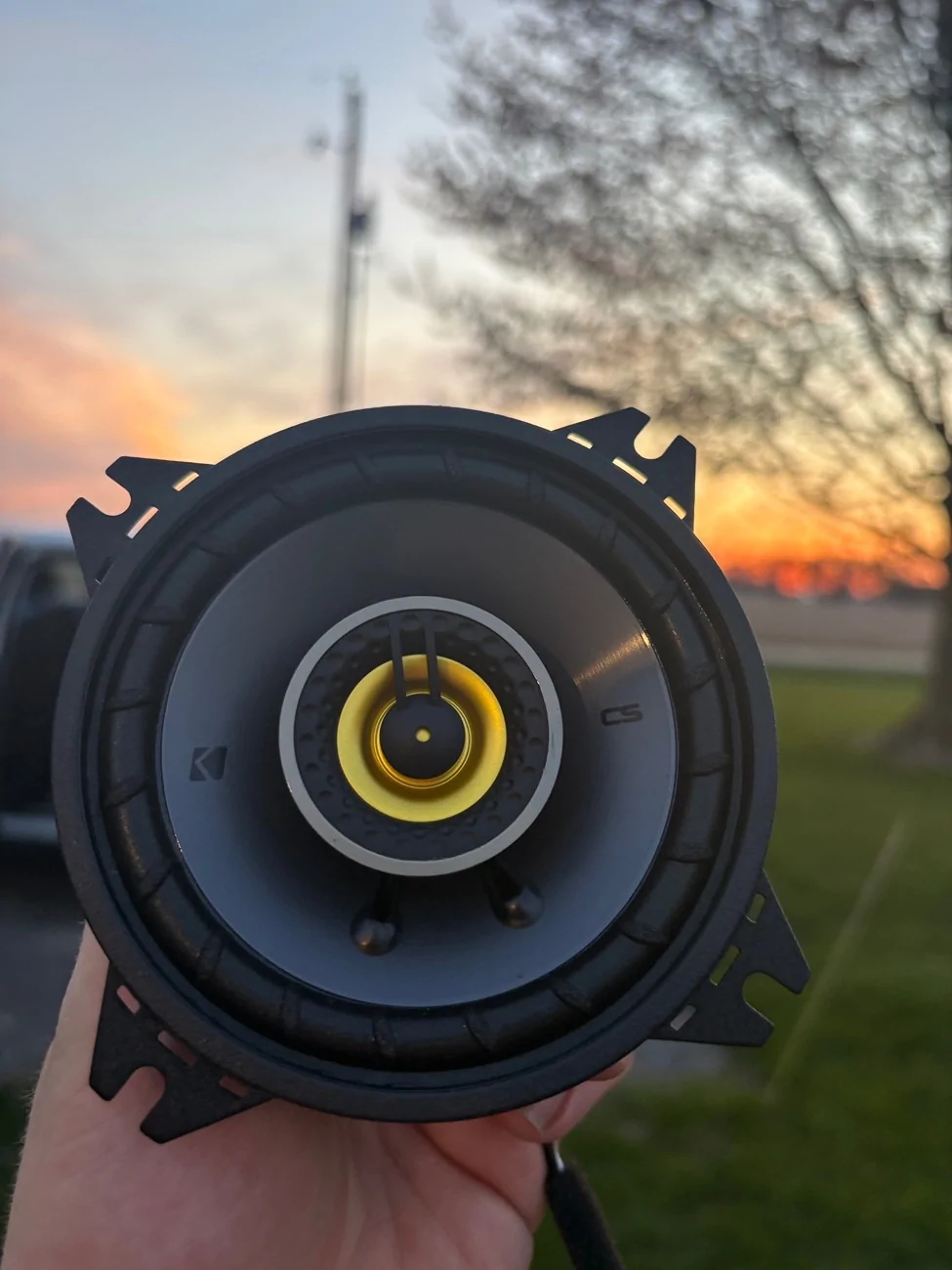

Here are the Speakers I installed, I highly recommend ordering from Crutchfield they provide you with everything you need to install. Even without an amp they still sound amazing. While installing be sure you get the bolt out of the door that is underneath the reflector. And as for the rear be extremely careful removing the speaker housing because there are 2 tabs that can break very easily. I suggest you watch a YouTube video and take a look at the instructions Crutchfield gives you.
