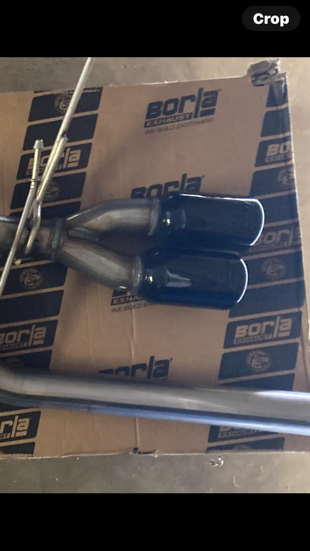

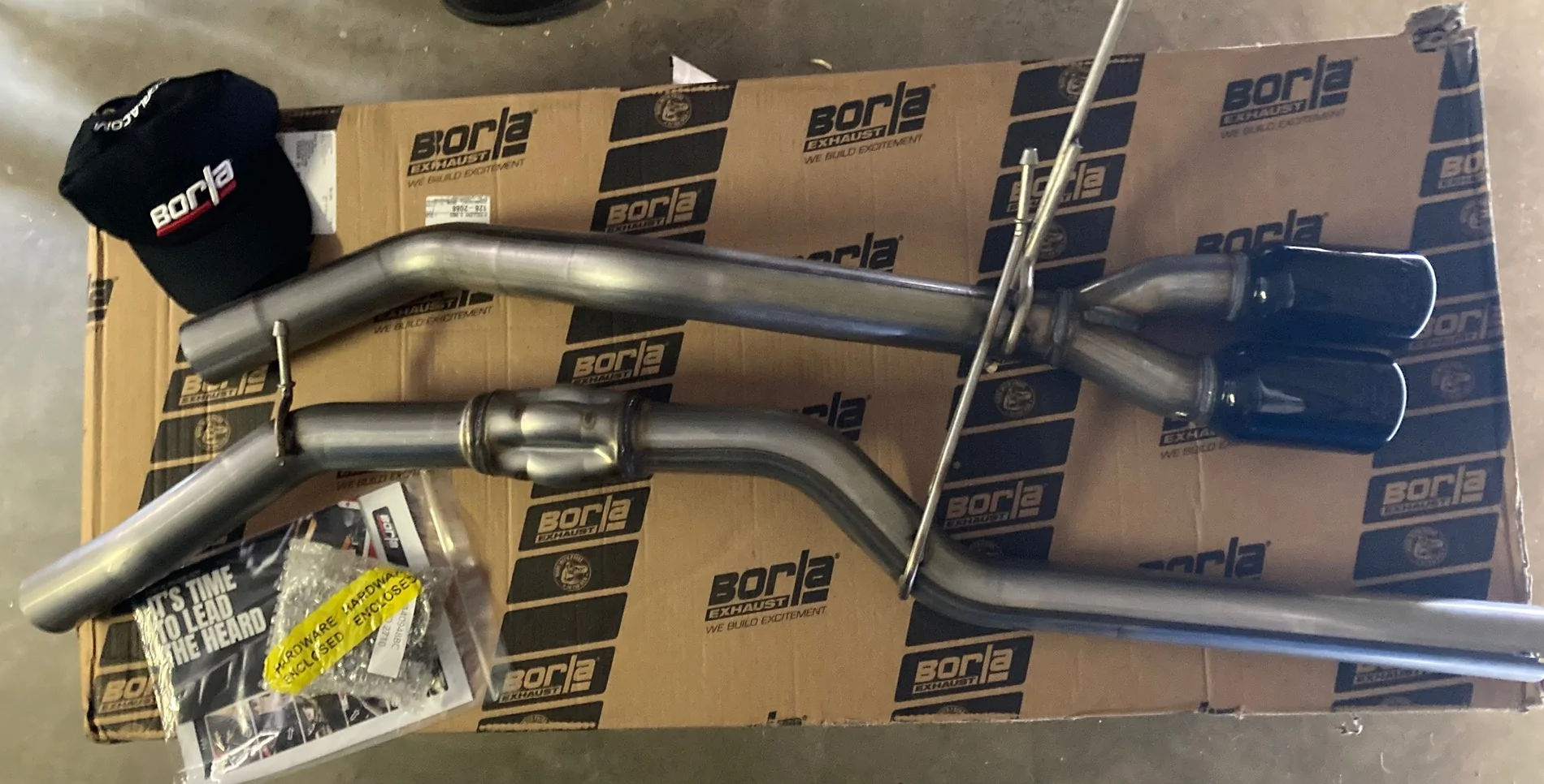

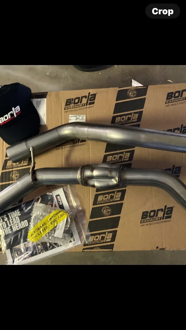

ORIGINAL POST:
Unboxed my Borla today. Check out the tiny “Polyphonic Harmonizer” muffler & sweet chromed black tips:)
I’ve watched dozens of Borla Type 3 truck install vids - but none have the shape of the Maverick’s. Weighs 16.6lbs.
I’ll bump thread when I remove & weigh the OEM - along with a sound clip of the beastly 2.0 straight piped.
Lastly, I’ll post a sound clip of the Borla after I finish install.
The intestinal shape of the “muffler” should give me melodious fart sounds!

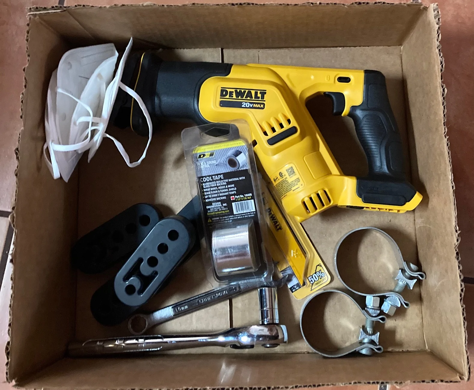

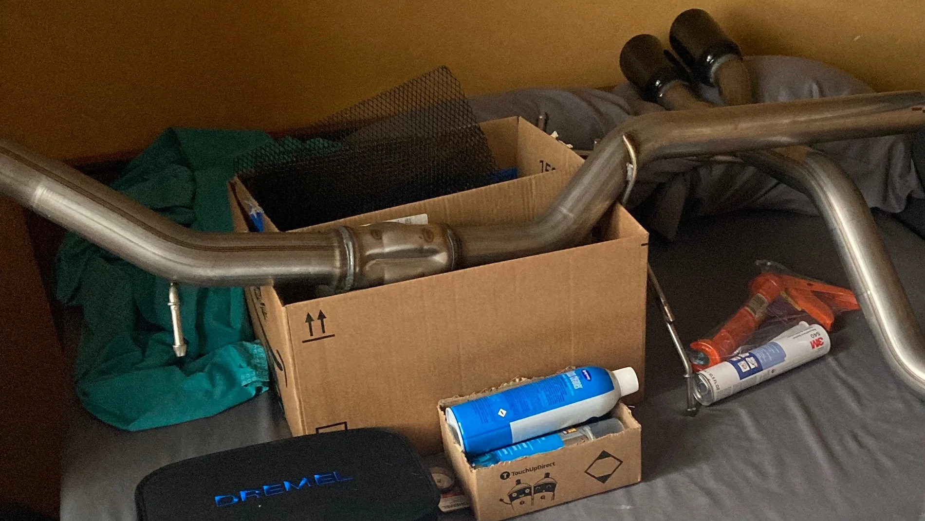

Not yet. Tools staged but Borla still in the spare bedroom resting…
Ford Maverick Borla Type 3 Catback installed IMG_9450
Ford Maverick Borla Type 3 Catback installed IMG_9453
Thinking of taking one last drive & recording cabin sound. Then back up into garage for a tomorrow or Monday install. Weather has cooled down - only low 90’s next couple days. Will post a cold start high idle after it sits overnight.
MRT is a forum sponsor I think - should have chosen them! The MRT sound clips are great. Borla was recommended by my Ford service/parts guy…I expect to like it also.

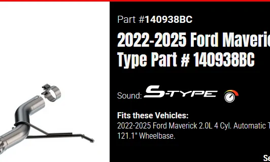

FYI - I just sent this note to Borla on their website feedback/question page.
“I recently purchased part# 140948BC for my 2025 Ford Maverick Lobo. Jim Click Ford, my local Ford dealer, recommended, ordered, and delivered to me for installation.
Upon installation, I noticed that the product did not match the pictures or instructions. I called Ryan in CS and he asked me to send pictures. Emails did not go through.
Anyway, I figured out the additional cut required & installed.
My test drive was horrendous. Incredible cabin drone that caused my dash to rattle & my ears to hurt. Exterior sound was echoing off my neighbors houses at low rpm’s. Giving it the beans was scary explosive.
