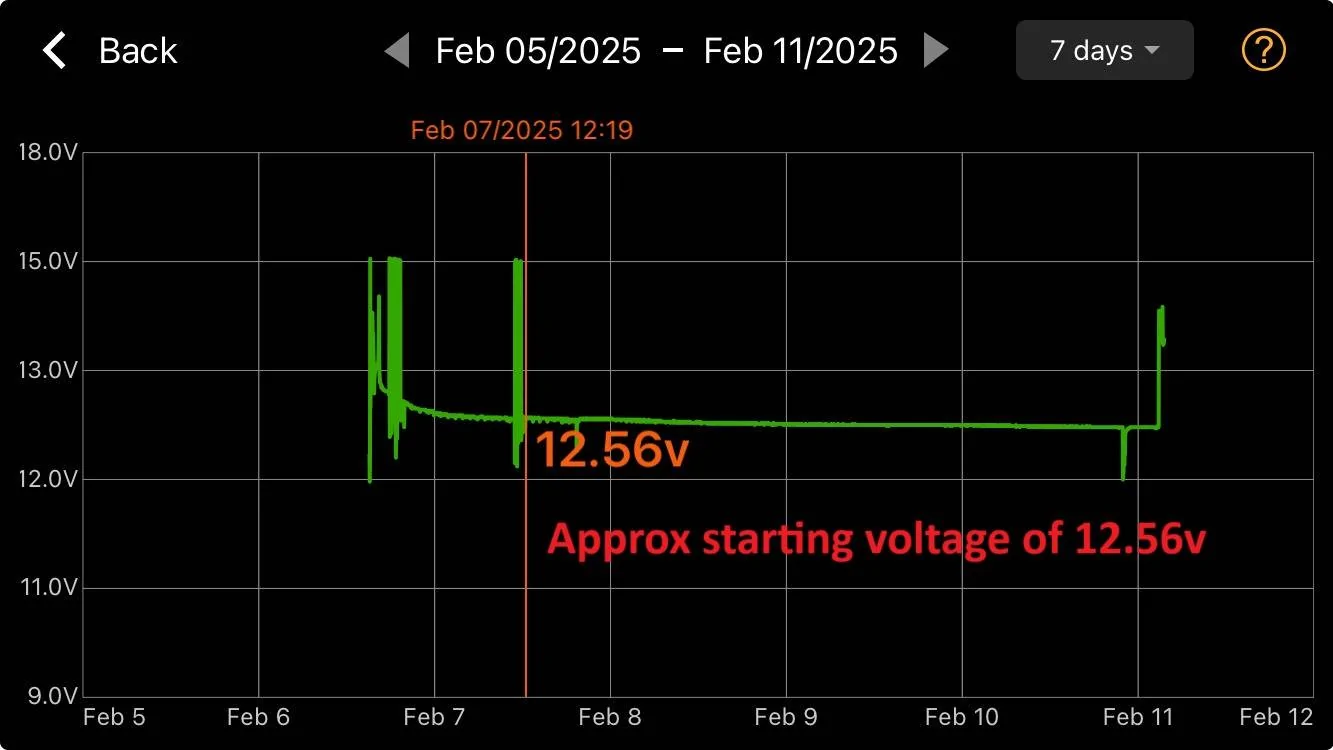

A week ago I installed a $15 BM2 12v battery voltage monitor with the intent to establish a base case and understand if telematics is what is causing the deep sleep or something else.
About truck tested:
  • 2023 hybrid XLT
  • Purchased Sept 2023 (~18 months old)
  • 5000 miles on truck
  • Garaged 100%
  • When parked for more than a few days, 12v battery tender used
Parameters for Base case:
My first case I will post is base case; base case is:
  • charged via Noco 5 the day prior and driven for a day of errands just before parking, starting voltage 12.56v
  • parked in unheated garage, temps 45°-60°
  • ALL TELEMATICS OFF on vehicle settings (but fuse still in)
  • Wifi Off
  • LOCKED, with key in faraday cage pouch inside house
  • Voltage loss over 86 hours 12.56 - 12.48 = 0.08v or 0.0009v/hr

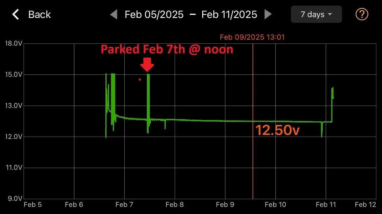

Pic 1. Can see truck parked date/time, overall average voltage level maintained of ~12.5v:
Pic 2. Starting voltage right after parking truck, with truck off/locked was approx 12.55v.

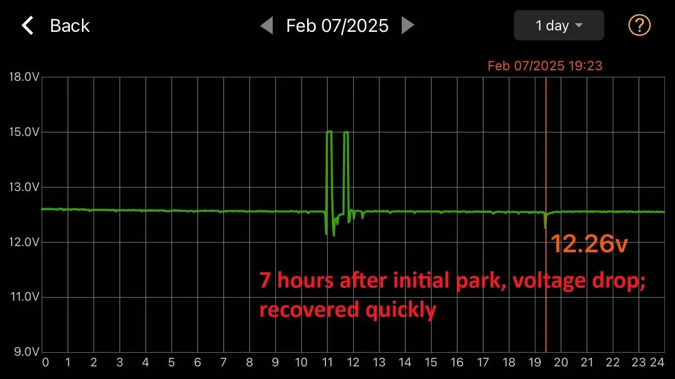

Pic 3. Approx 7 hours after initially parking, truck internally activated systems which caused a brief voltage drop. Nothing was done to vehicle and key remained inside and untouched. This was a one time event it appears.

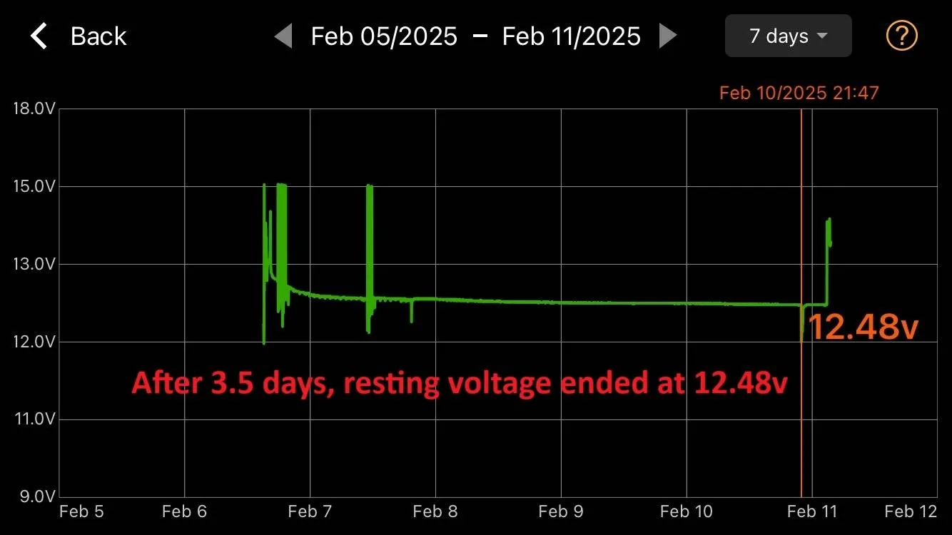

Pic 4. After 3.5 days of sitting, ending voltage was approx 12.48v, a very gradual decline. Also noted, on the evening of the 10th I took the key out of the faraday pouch and walked around the truck with it. I placed it on the drivers side window. No power draw or bootup was noted, so I do not believe the truck detects the key moving or nearby (Lariat may be different due to keyless entry).

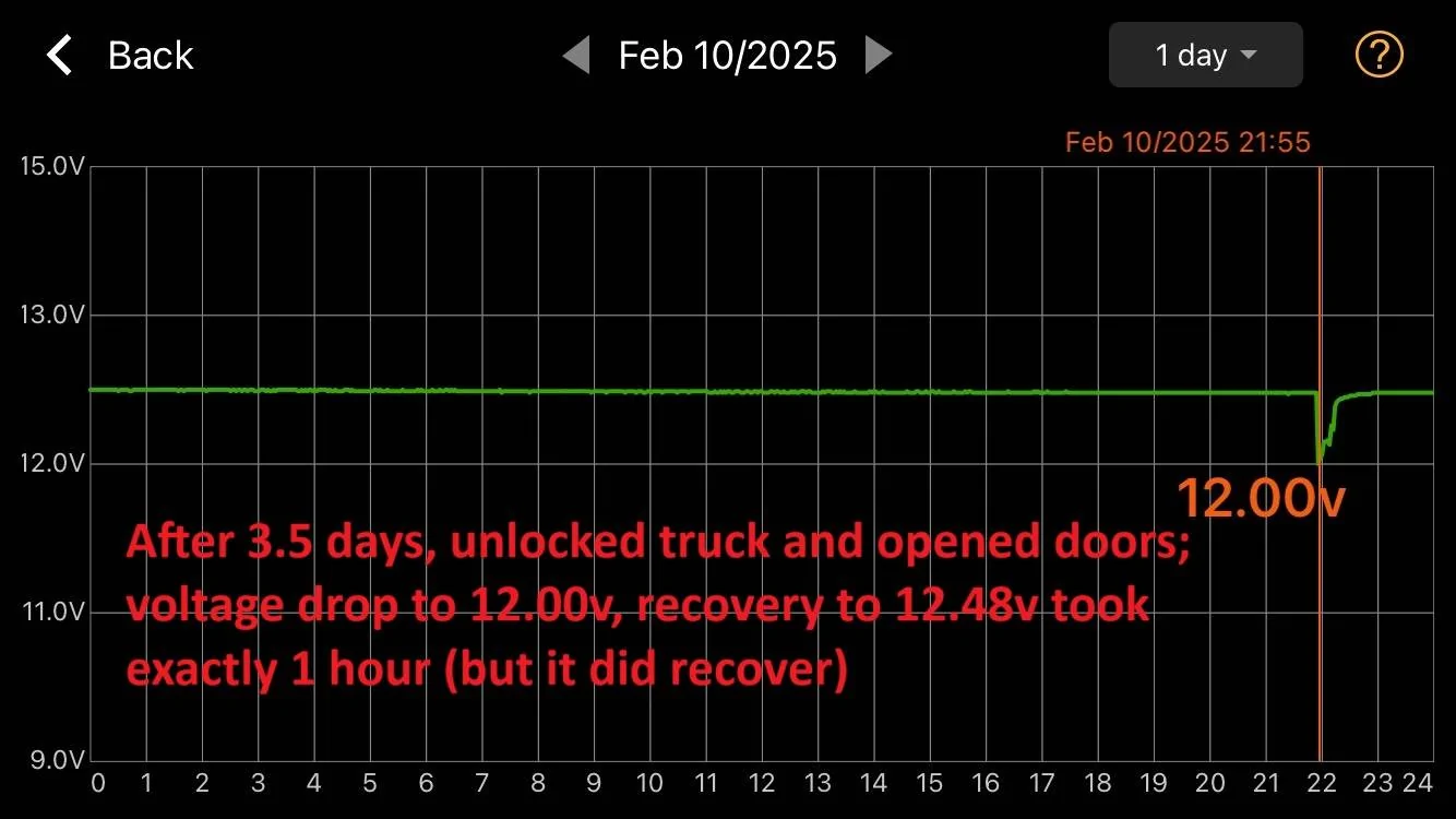

Pic 5. After unlocking and opening doors for several minutes, voltage dropped to approx 12.0v. Recover to 12.48v did occur; it took approximately one hour:

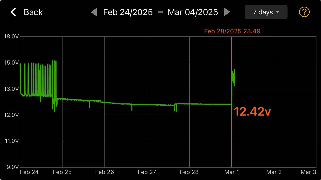

This data is with telematics ON, used for reporting to Ford servers.
Summary:
Telematics ON certainly has a slight impact to battery life while sitting, however it was far less detrimental that I thought it would be. I don't believe leaving it ON should have a big impact on if vehicle enters deep sleep with a properly charged/healthy battery.
The vehicle "phones home" to Ford servers once a day if not driven. This occurred around 6:30 pm for me and lasted a few minutes.
Of note, accessing Ford Pass during the time while sitting DID NOT pull a battery draw down on the vehicle. Of course, locking/unlocking or starting the vehicle would send signal to the vehicle and would do so.
Parameters for this test:
  • charged via Noco 5 the day prior and driven for a day of errands just before parking, starting voltage 12.63v
  • ALL TELEMATICS ON in vehicle settings (with fuse still in)
  • Wifi Off
  • 24+Voltage loss over 67 hours 12.63 - 12.47 = 0.16v or 0.0024v/hr

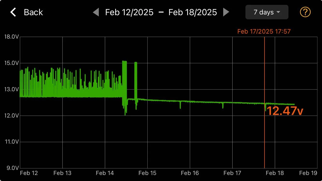

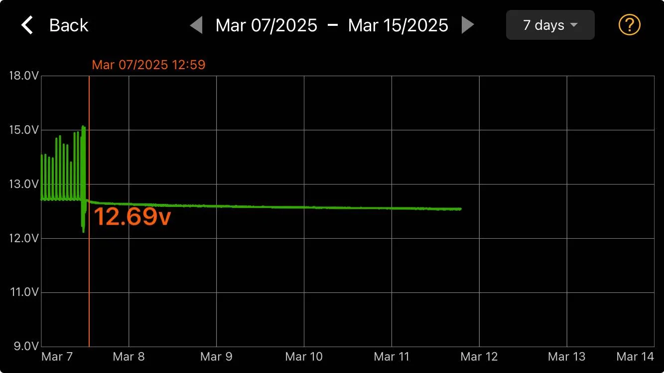

Test #1 is data is with truck unlocked, key inside cab, and telematics OFF. Test #2 is data with everything the same as #1, but telematics fuse #11 pulled as well.
Summary:
Telematics were selected off. Despite this, the vehicle was doing something every day around the same time, similar to with telematics ON. This is confusing. I'm wondering if this voltage drop is something else other than telematics at this point. Overall profile looks similar to when telematics selected ON.
***With the #11 fuse pulled, there was NO telematics comms going on.***
Curiously, voltage actually increased on the last day. This happened immediately after doing a double voltage drop.
  • ALL TELEMATICS OFF in vehicle settings (with fuse still in)
  • Wifi Off
  • UNLOCKED, with key in cab resting under center console
  • Voltage loss over ~4 days 12.63 - 12.42 = 0.21v or 0.0021v/hour
  • The bulk of voltage loss occurred on first day. After that, avg voltage loss per day was 0.02v. Minimal.
  • Voltage actually increased on the last day slightly.
Test #2 is data is with truck unlocked, key inside cab, and telematics OFF, along with fuse #11 removed from truck.
  • charged via Noco 5 the day prior and driven for a day of errands just before parking, starting voltage 12.69v
  • ALL TELEMATICS OFF in vehicle settings, with fuse OUT
  • Wifi Off
  • Voltage loss over ~4 days 12.69 - 12.54 = 0.15v or 0.0015v/hour

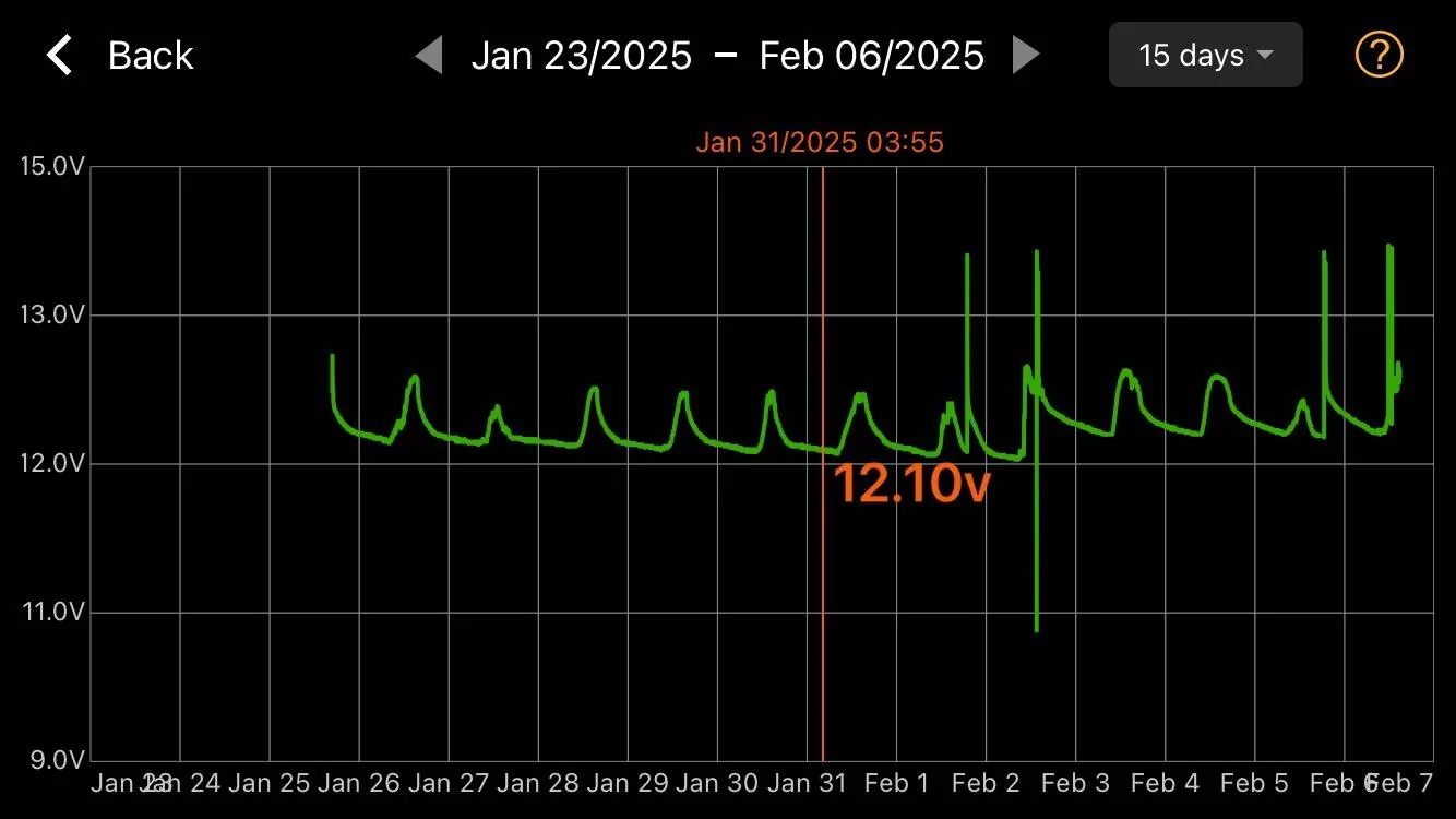

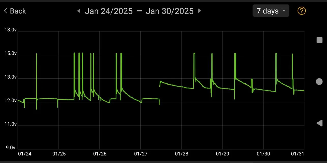

Here is an example of the flooded battery vs an AGM. On 1/27 mid-day, I changed to the AGM battery and reset the BMS per the owners manual. My concern is the constant charging rate of 15.4v which seem high and wonder how that may affect all the 12v battery and other components.
The Real Maverick
Jack
Jan 13, 2024
2,999
4,148
I have noticed the voltage of 15.x for the first hour? Or so. (Not precisely documented). Then, the rest of the time on drives longer than 1 hour it will be 14.5 volts or so.
