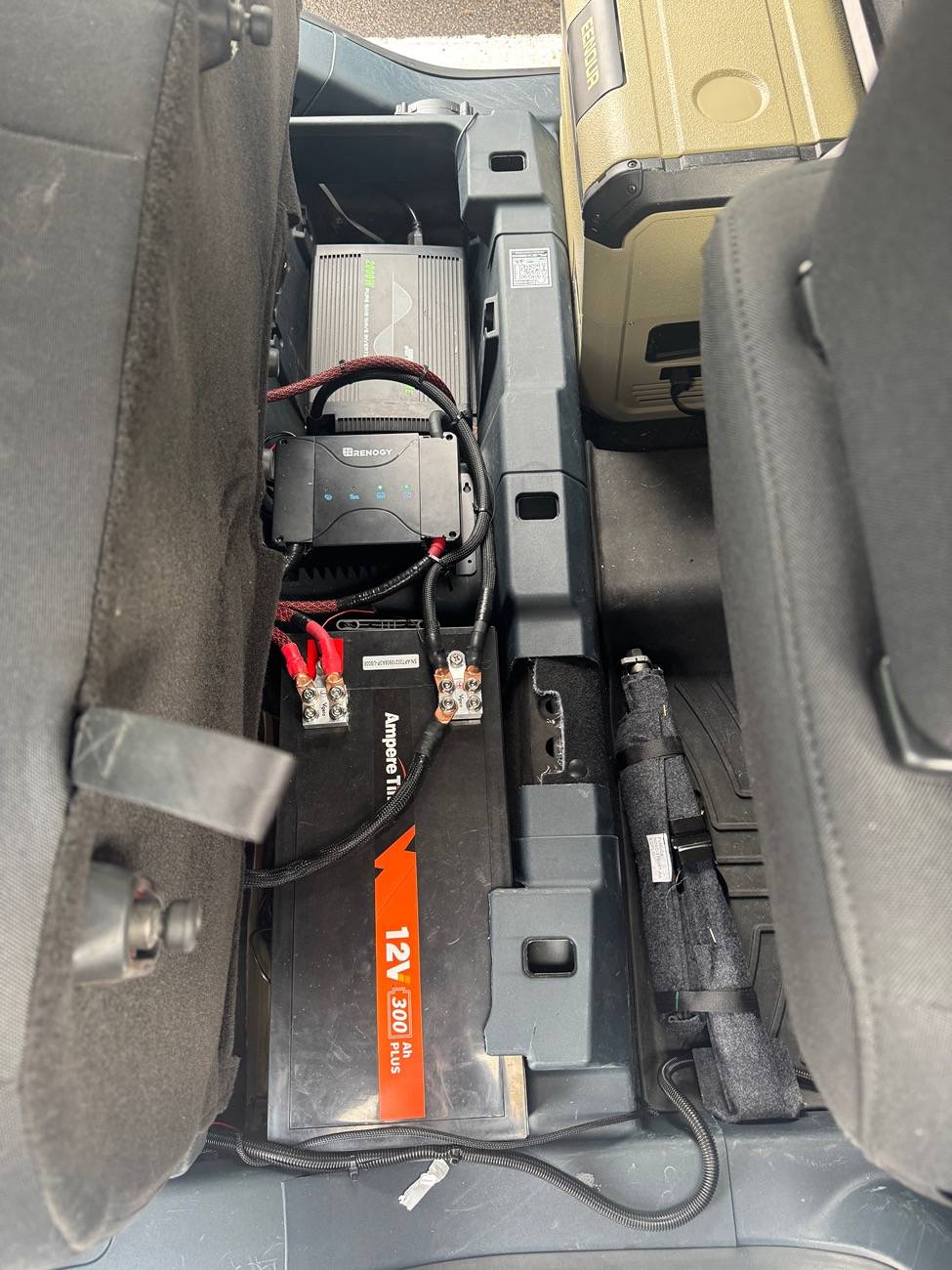

I placed all the components under the rear seat for a compact, clean setup:
  • Battery: Under the passenger-side rear seat.
  • Inverter: Under the driver-side rear seat.
  • DC-to-DC Charger: In the middle under the rear seat between the battery and inverter.
  • Circuit Breakers: Mounted behind the rear seat backrest for easy access.

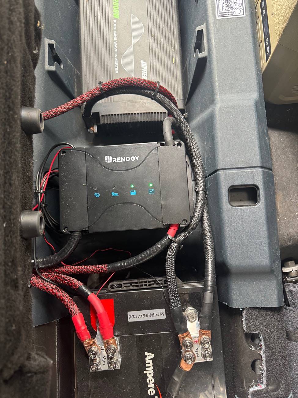

Step 2: Mount the DC-to-DC Charger
  1. Mount the Renogy 50A DC-to-DC Charger in the middle under the rear seat.
  2. Leave clearance for wiring and airflow.

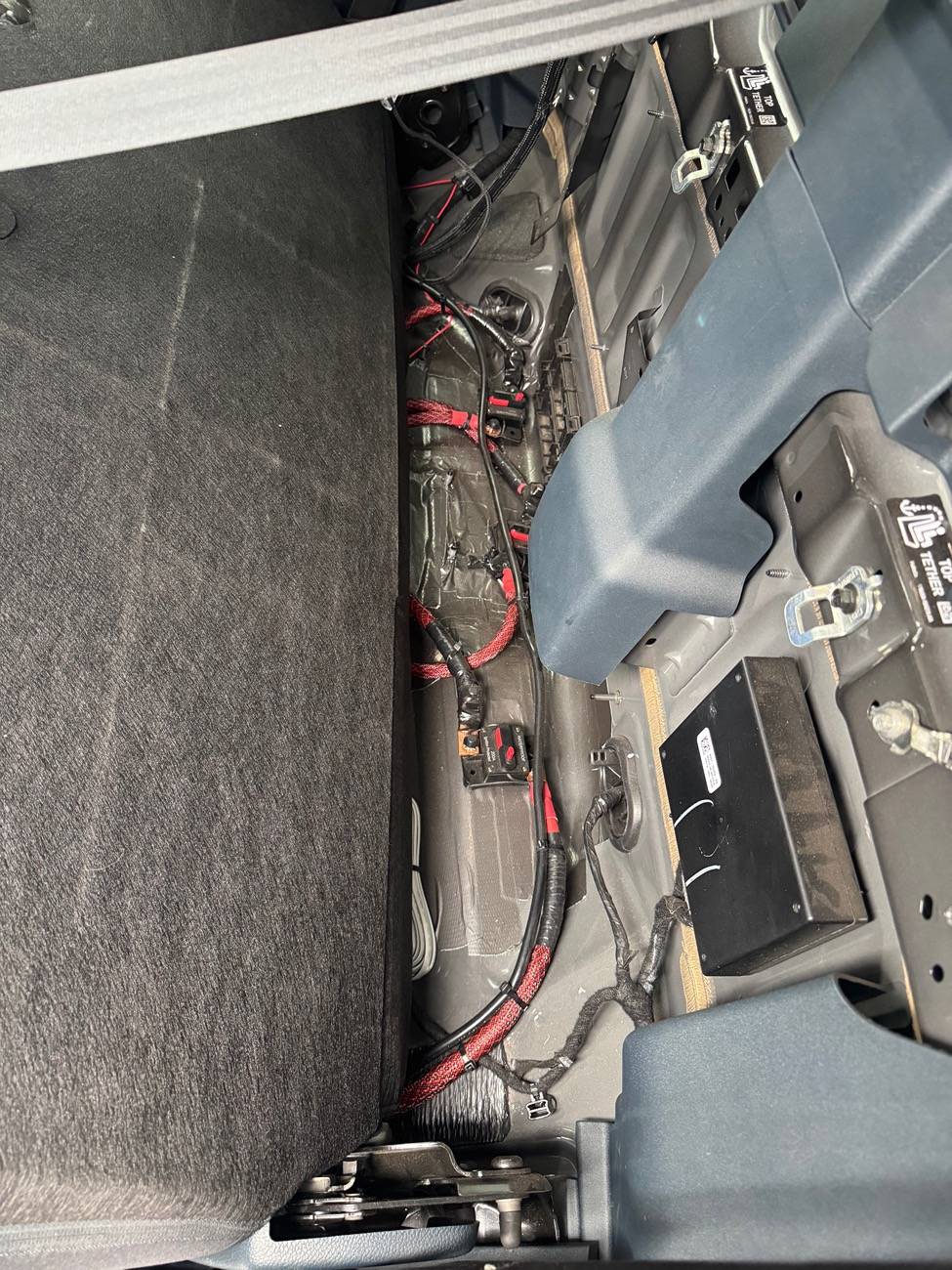

Your wiring ensures all positive connections pass through a circuit breaker before continuing to the next component, and all negative connections connect in sequence, ultimately grounding to the frame via the auxiliary battery.

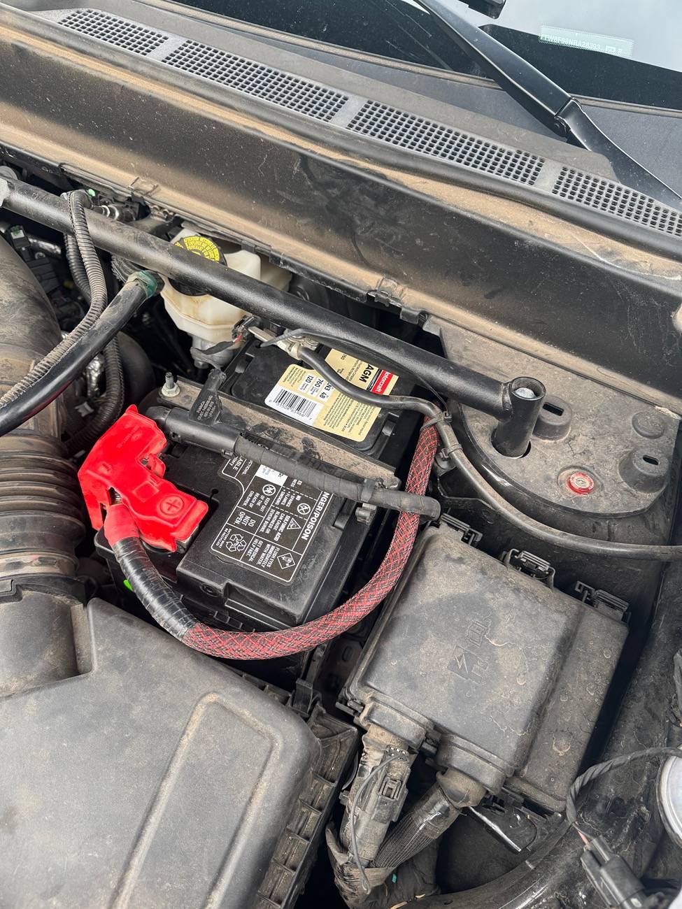

  1. Positive Connection:
    • Connect 1/0 AWG wire from the starter battery positive terminal to the input terminal of the first circuit breaker.
    • From the output terminal of this circuit breaker, connect 1/0 AWG wire to the input terminal of the DC-to-DC charger.
  2. Negative Connection:
    • The starter battery's negative terminal remains grounded to the truck frame (already factory-grounded).
DC-to-DC Charger to Auxiliary Battery
    • Connect 1/0 AWG wire from the output terminal of the DC-to-DC charger to the input terminal of the second circuit breaker.
    • From the output terminal of this circuit breaker, connect 1/0 AWG wire to the auxiliary battery's positive terminal.
    • Connect the negative terminal of the DC-to-DC charger to the auxiliary battery’s negative terminal.

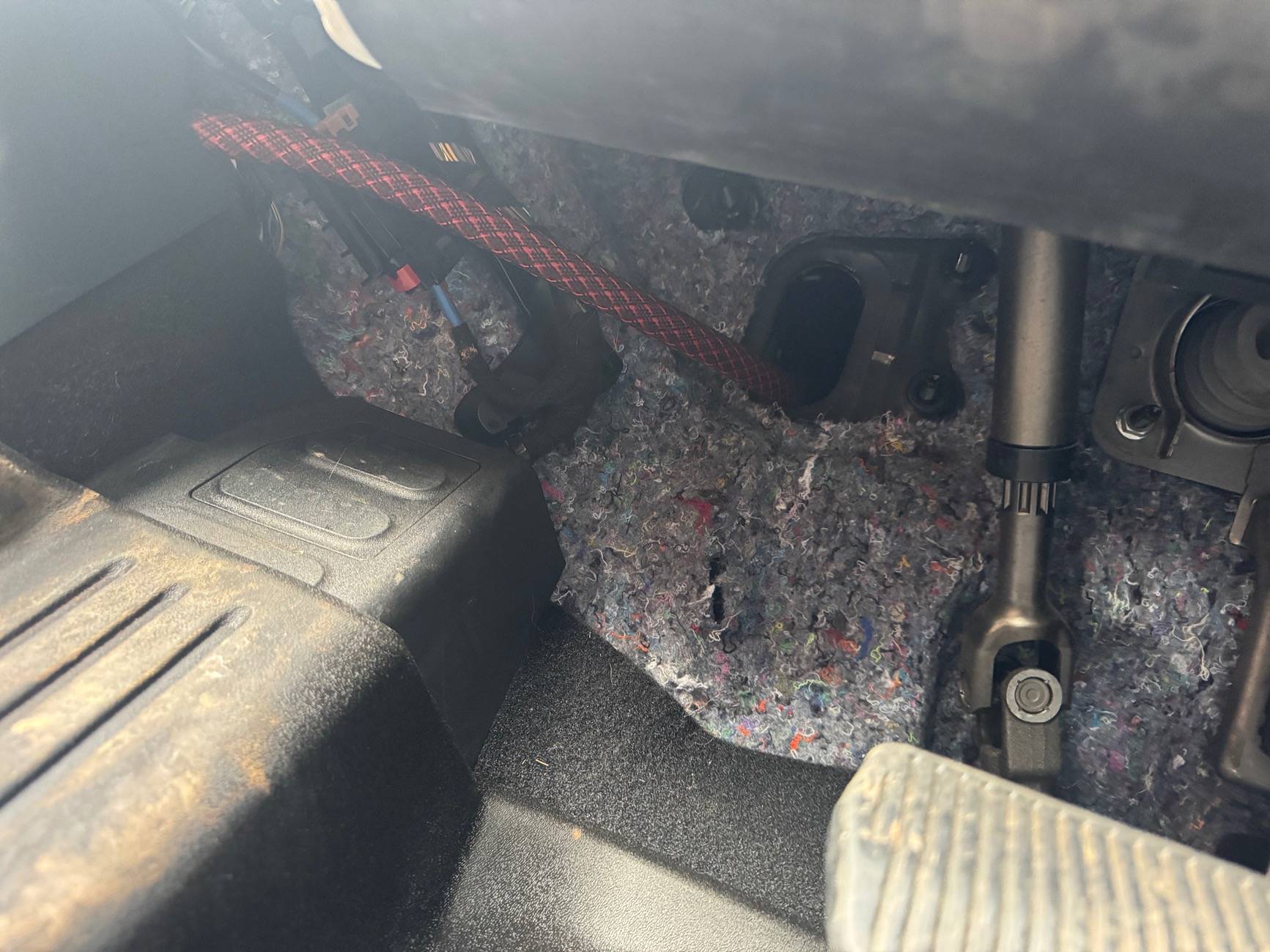

this is where you put the dc to dc alternator cable thing… not sure what to call it at this point but it is required to let the dc to dc charger know when the car is on and alternator is running. You can look in the dc to dc charger to see which fuse type they recommend as I forgot to document this piece. But with that information you google ford maverick internal fuse box diagram and pick the relevant fuse. If I remember correctly you can use pretty much any of them just make sure it isn’t one that is constantly on like even when the truck is off. And don’t use the driving sensor ones pick something like heated seats or low importance. I then went on line and got a fuse tap from Amazon they are $5. Highly recommend so it has an OEM fitment and doesn’t come loose.
Auxiliary Battery to Inverter
    • Connect 1/0 AWG wire from the auxiliary battery’s positive terminal to the input terminal of the third circuit breaker.
    • From the output terminal of this circuit breaker, connect 1/0 AWG wire to the positive input terminal of the inverter.
    • Connect the negative terminal of the inverter to the auxiliary battery’s negative terminal.

  1. Connect the auxiliary battery’s negative terminal to the truck framefor grounding.
    • Sand down the paint at the grounding point to ensure proper contact with the metal.
  2. The truck frame serves as the common ground for the entire system.
