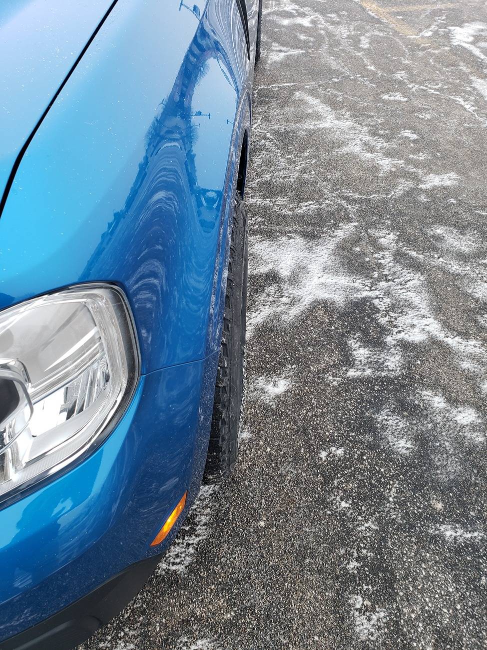

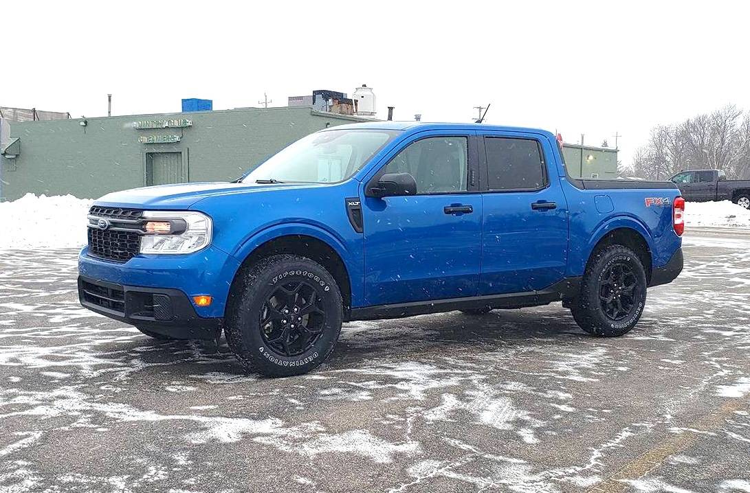

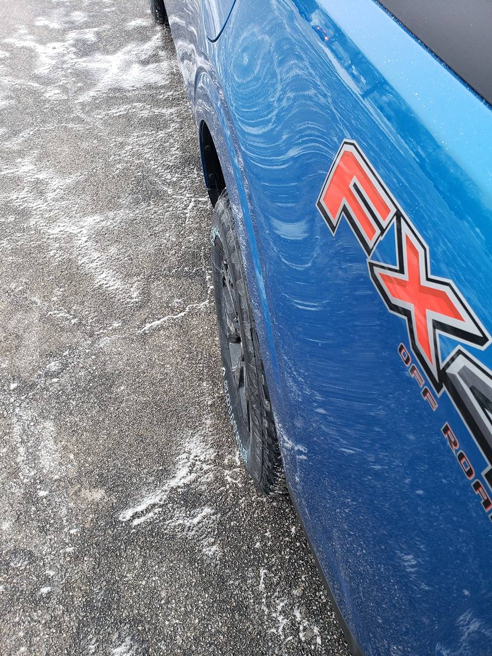

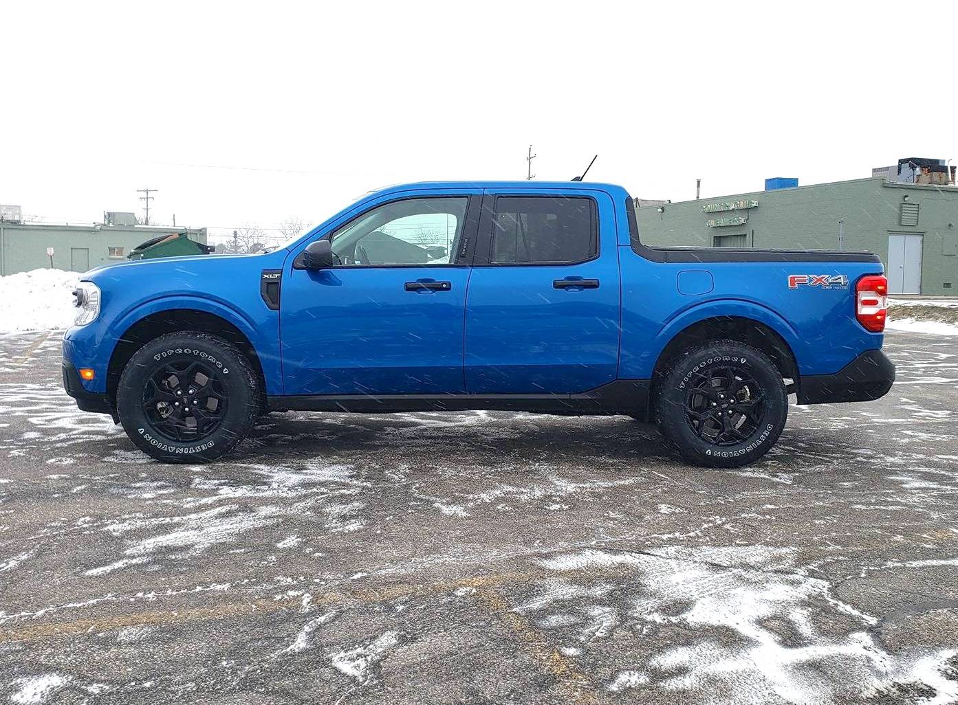

Just installed a Rough Country 1" Level Kit and new Firestone Destination AT2 tires. My FX4 had Pirelli Scorpion ATRs in 225/65-17 from the factory. I got 30k miles out of them... I went up to 235/70-17 with the Firestones. Happy to report perfect fitment. No rubbing. IMO an FX4 should have looked like this from the factory.
Speedo reads 2 mph slow on the freeway, 1 mph slow around town. I plan on adjusting the tire size in Forscan in the coming days.

Looks great and I completely agree with you on the should have came like that from factory.

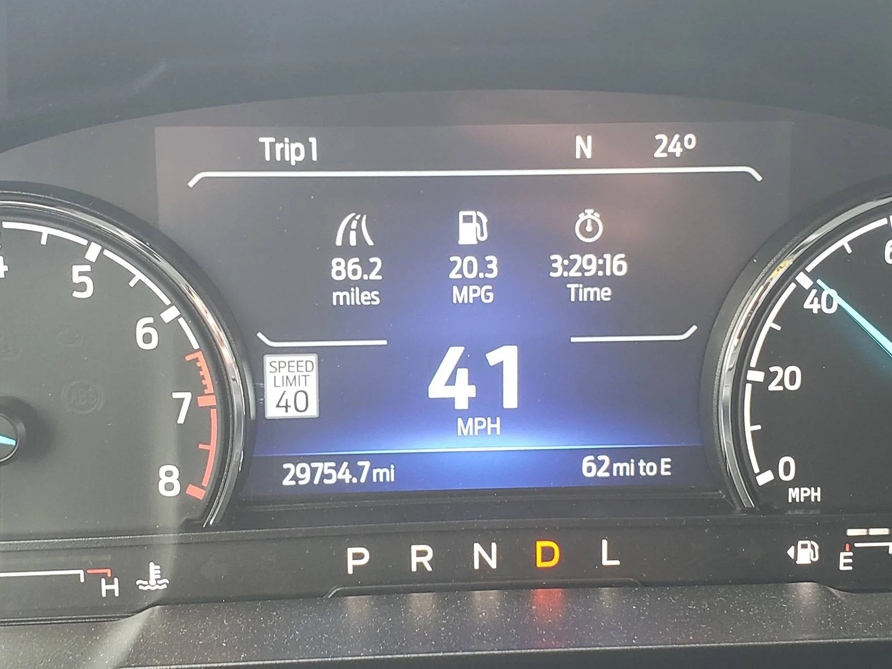

Forscan speedo update. In referencing threads on MTC, also other Ford forums, I think the upper-limit for tire circumference does hold some water. 2270 mm is commonly quoted on MTC as the max. The value in mine stock was 2230 mm.
I tried some larger values like 2310 and 2350 mm (on paper these new tires are 2390 mm), and was getting a message in the log saying "tire circumference out of range for this module" when doing the PCM relearn. Interestingly though, when doing the AWD module relearn right after, it would clear the codes and wrench icon from the gauge cluster. The speedo did NOT seem to change at those higher values though (comparing with GPS). Unfortunately, after following that relearn procedure of PCM, then AWD, I would still have a P160 DTC. I was also getting a PSCM (power steering) DTC.
I eventually reverted back to 2270 mm, did the PCM > AWD relearn, then cleared DTCs. No new DTCs came up after, so I guess it'll just stay at 2270 mm...

Also, I turned on TSR and it works great!!
