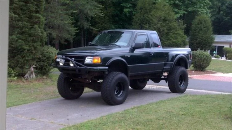

This is how I see it in my head more or less
This truck does not have IFS IRS. you can not do this with a maverick. The lift is limited by the cv angles.
If someone made portal axles you could lift it more but that may never happen.
While your point is correct. It does look like that is actually a heavily dropped TTB suspension which is independent by definition. Its hard to tell. Either it is a heavily trussed solid axle(the rear isnt shy why would it be extra trussed unless its a small D30 and the rear is a stout 8.8) or its a dropped TTB.
The real limiter on the Maverick design is the transaxle transmission style. To have an effective long travel IFS(the rear would be easy) a Tony Stark level "mechanic" could create a drop box that turns the front CVs into a stub flange, which would then be portal dropped lower and inboard underneath the transaxle. Which would make the CVs lower and significantly longer allowing for more travel arc. It would require atleast 8" to 10" of lift. Aswell as suffer, like portals, from high speed reliability.
