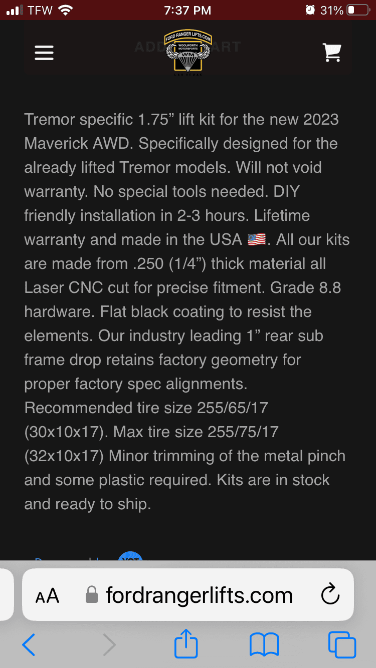

I plan on running an all-terrain 235/80/17’s with the only lift available that I know of for the TREMOR by Fordrangerlifts they’re actually 31.8’s. I figure I may have to do minor trimming even though I’m staying stock width.

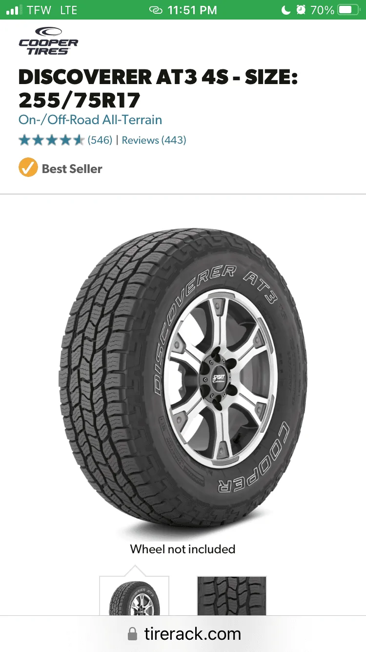

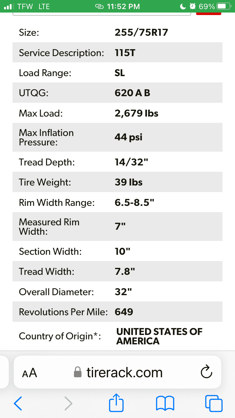

I changed my mind and am gonna go with the Cooper disco AT3 (32”)255/75R17” since FORDRANGERLIFTS.COM says I can with minor trimming. Plus they r
lighter weight than the LT’s above & have a higher tread wear warranty/rating.
