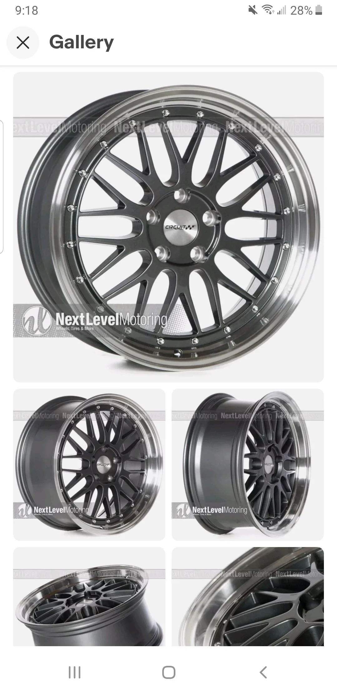

I am looking at these 18x8s with a + 35mm offset for my XLT AWD I got on order. They are specced for Focus RS. Mine is iconic silver as well. Glad to see with the lowering kit that the 18s fill out the wheel opening nicely.
Ford Maverick - Screenshot_20220104-211835_eBay

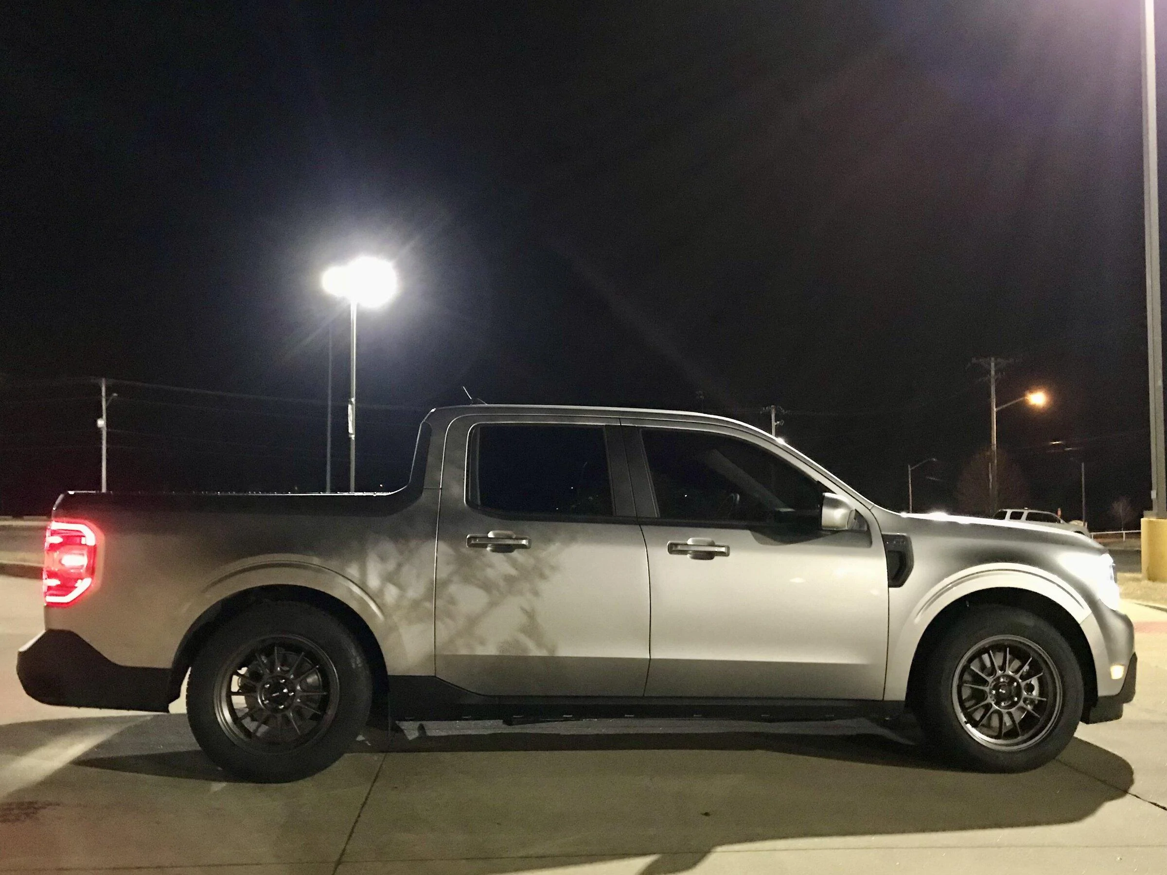

Wheels: 18x8.5 Konig Hypergram in Matte Gray with +43mm offset (~18 lbs each w/ 700 kg load rating)
Tires: 235/60ZR18 Continental ExtremeContact DWS06 ( ~28 lbs each)
Hub Centric Rings: Circuit Performance 73.1mm OD to 63.4mm ID Black Plastic Polycarbonate Hub Centric Rings
Lug Nuts: Gorilla Automotive Chrome Acorn (14mm x 1.50 Thread Size)
Rear Spacers: 20mm Hub Centric Wheel Spacers Bolt Pattern 5x108 Center Bore 63.4mm
I also have 20mm bolt-on spacers on the rear to get the fitment flush all around; the rear wheels were tucked in a bit without the spacers.
Updated with new pics after lowering, stock height pictures moved to the end of this post 👇
Pictures at stock ride height:
View attachment 19888 View attachment 19886 View attachment 19887
Mounted wheel/tire weight for those curious: ~46 lbs mounted and balanced

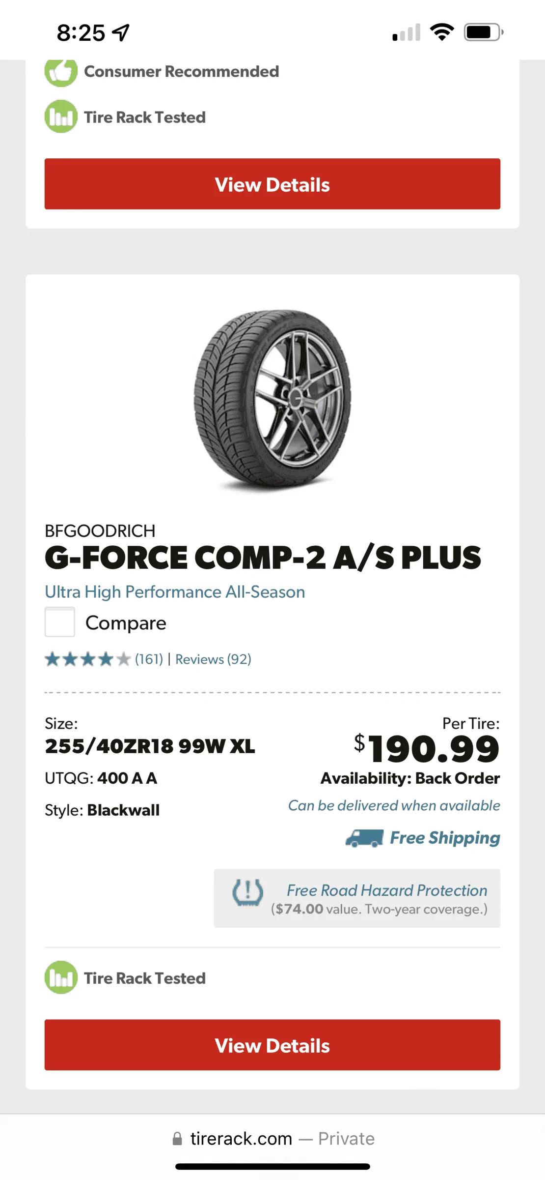

do you believe this size would work on that same size wheel 18x8.5? seem like they have alot more options i also plan on lowering truck as well. thank you.
Ford Maverick - 74CE75C3-8239-46D9-ACAD-0B5B61966BAB

Yeah, that tire size will work on 18x8.5. Depending on how much you're wanting to lower, that size may be a little small for a Maverick as it is only ~26" in diameter.
yeah thats way to small. since you got urs and its lowered would you go a little wider or anything?
