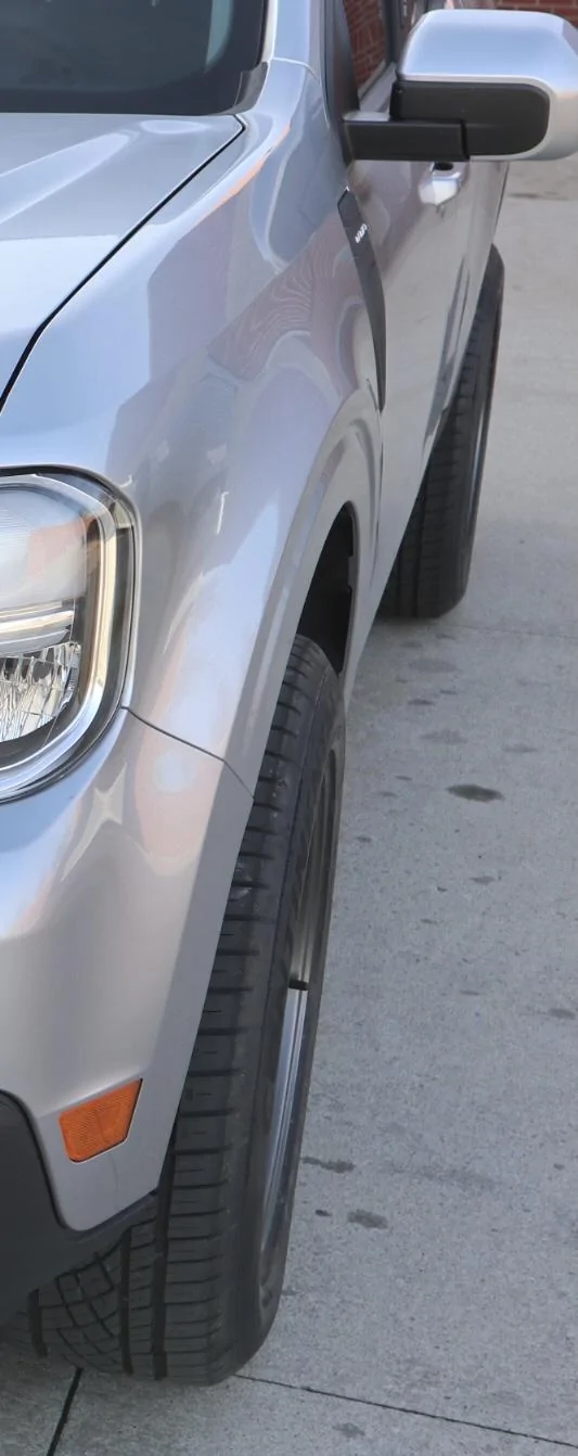

This is probably the best picture I have at the moment
I ran the offset calculator on the wheels and they show 24mm more toward the strut (mostly negated by your 20mm spacer) and 14mm outward, which is a lot more given your spacer.
I just wanted a clean shot of it. That worked perfectly. A bit much ā€œpokeā€ for me, but maybe with some flares…..

You had me curious so I just went and put a flat board across the side walls to measure; the front poke is right at 3/4", and rear poke is 5/8", so the front is still further out by ~1/8". Assuming the scrap board I used is relatively straight lol.
Lol. Thanks man. Think your the first I’ve seen try a spacer. I’m gonna be running spacer adapters with some TE37’s but don’t want to wait for the truck before ordering the adapters.šŸ˜….
I wonder if maybe measuring from outer wheel to outer wheel in the back then the front give a better idea?
