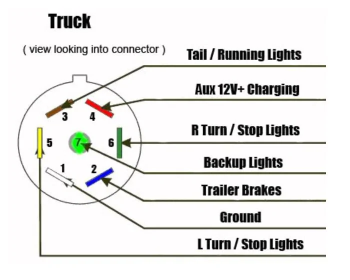

There is no +12V constant power on a flat-4 socket, but the RV-7 has one.
HRG
Thanks for the diagram. Do you happen to know the wire gauge for that red #4 pin?

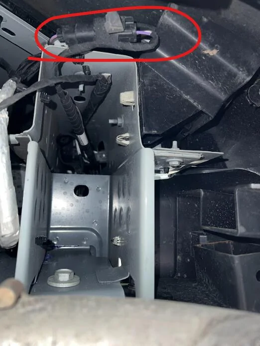

I want to keep the wires under the bumper area. Is there a way to snake the flexbed wires down under the bumper without them showing on the outside of the truck?
You can either snake it down, or trace the wire to where it plugs into the main harness under the truck.
This view is under the bumper, looking up at the tail light area.
Great, I will take a look. Is the purple 12v and black ground?
Yes. And can confirm that they use 16AWG wiring.
Just keep in mind that the Flexbed (rear powerpoints) remain engaged based on a Forescan setting, which defaults to 90 minutes unless the truck is in power saving mode.
