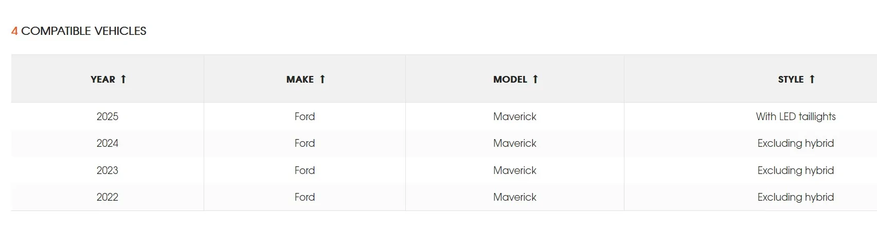

Thanks. Curt's website only shows '25 compatibility with LED taillights, other have reported that the #56477 kit does not fit your '25 XLT. If it does, great, but when you go to install, please snap some pics.
Supposedly, they are creating a new kit, #56567, for '25-26 non-LED applications.

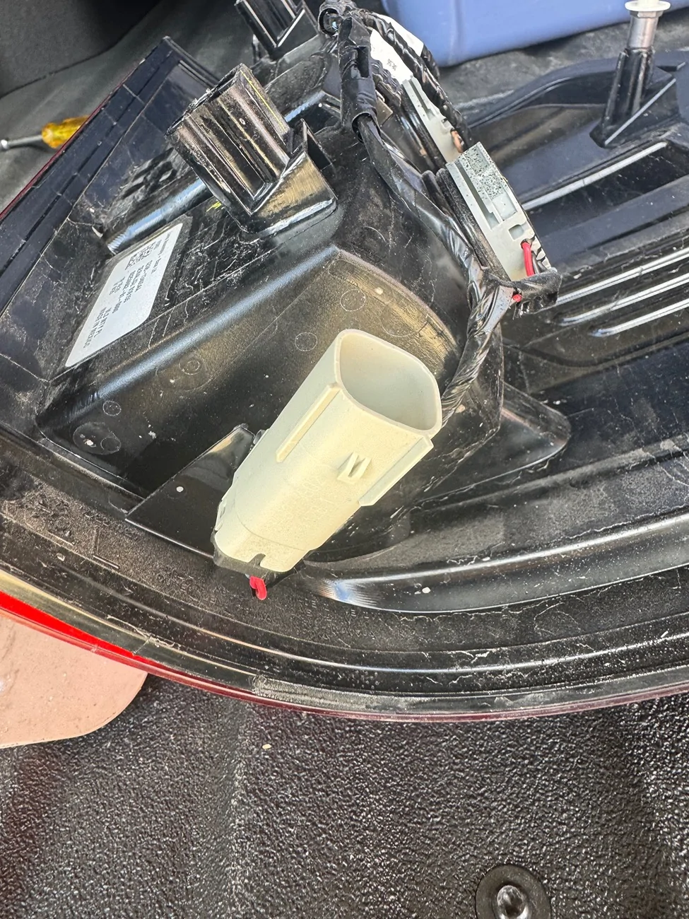

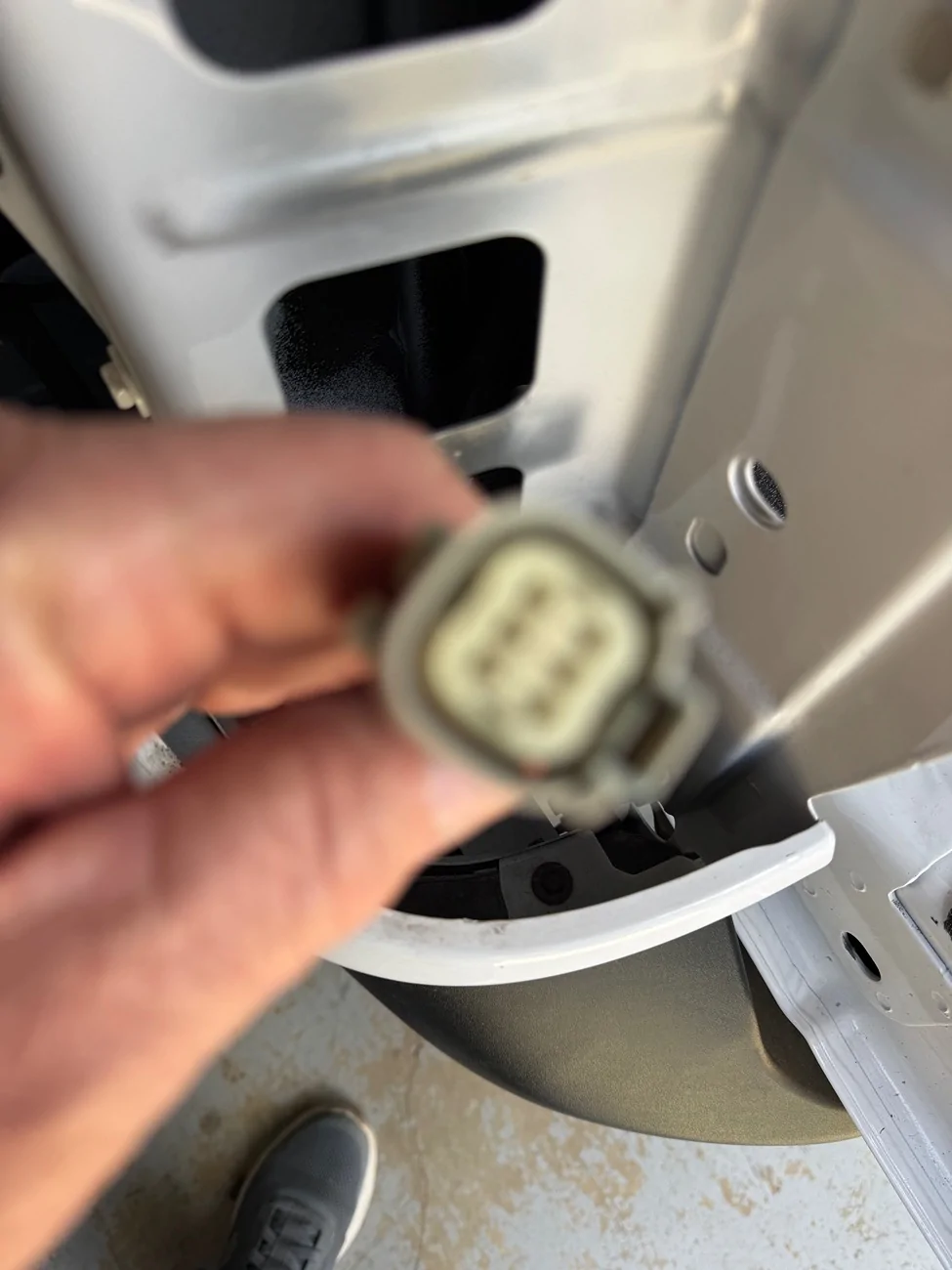

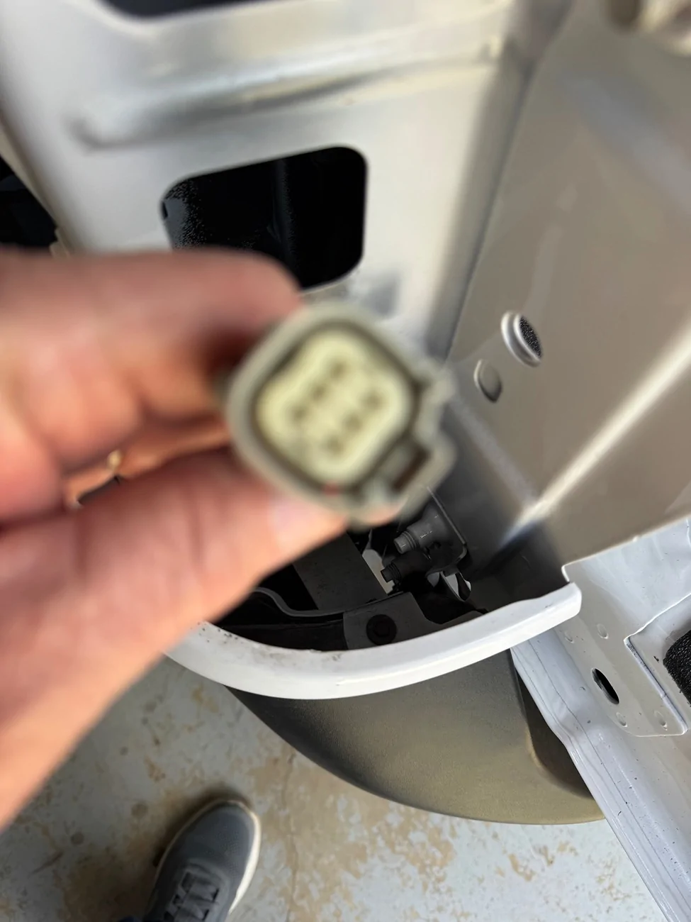

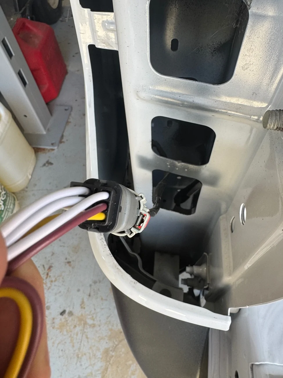

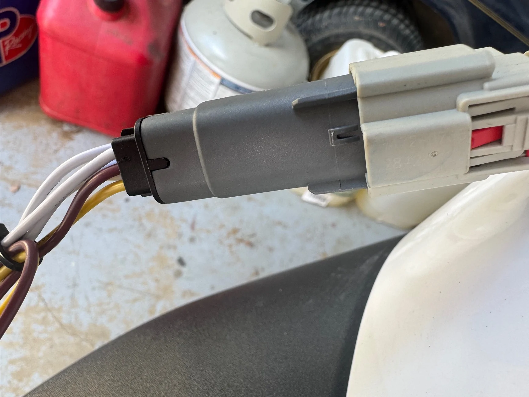

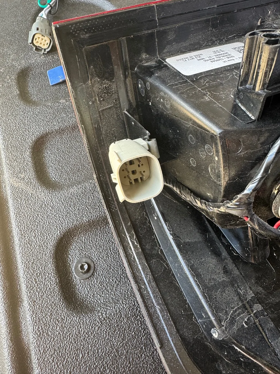

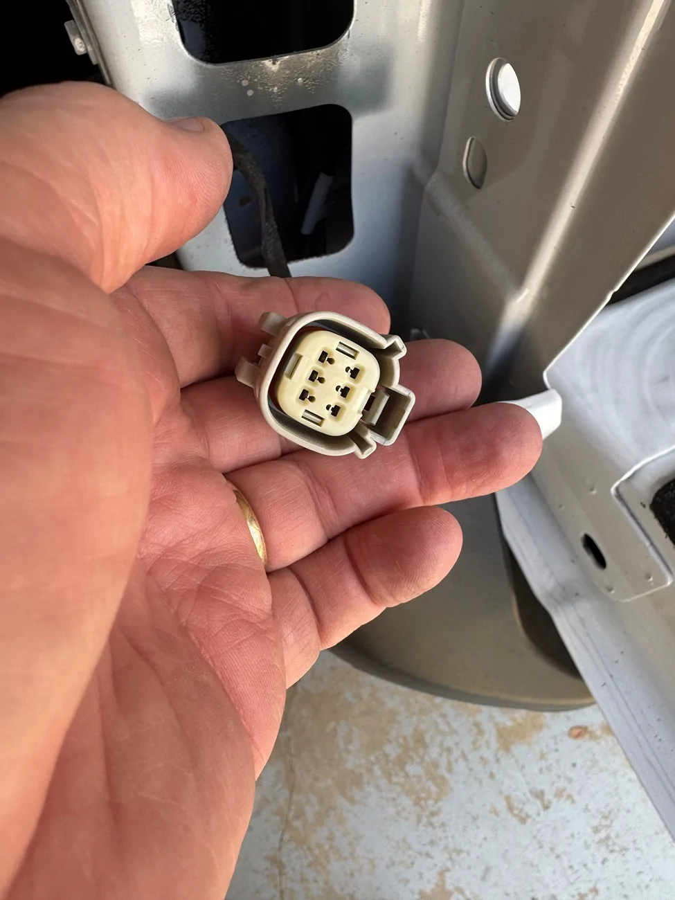

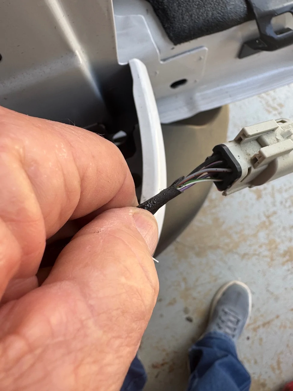

Well you are correct, 56477 is close but no cigar. I took pictures but it is tough to tell they don’t fit, they are that close.

@dsweet3331 Awesome, thank you. That confirms what I've been reading, that the 25/26 XL/XLT is using a Molex keying option "B", rather than the previous option "C".
