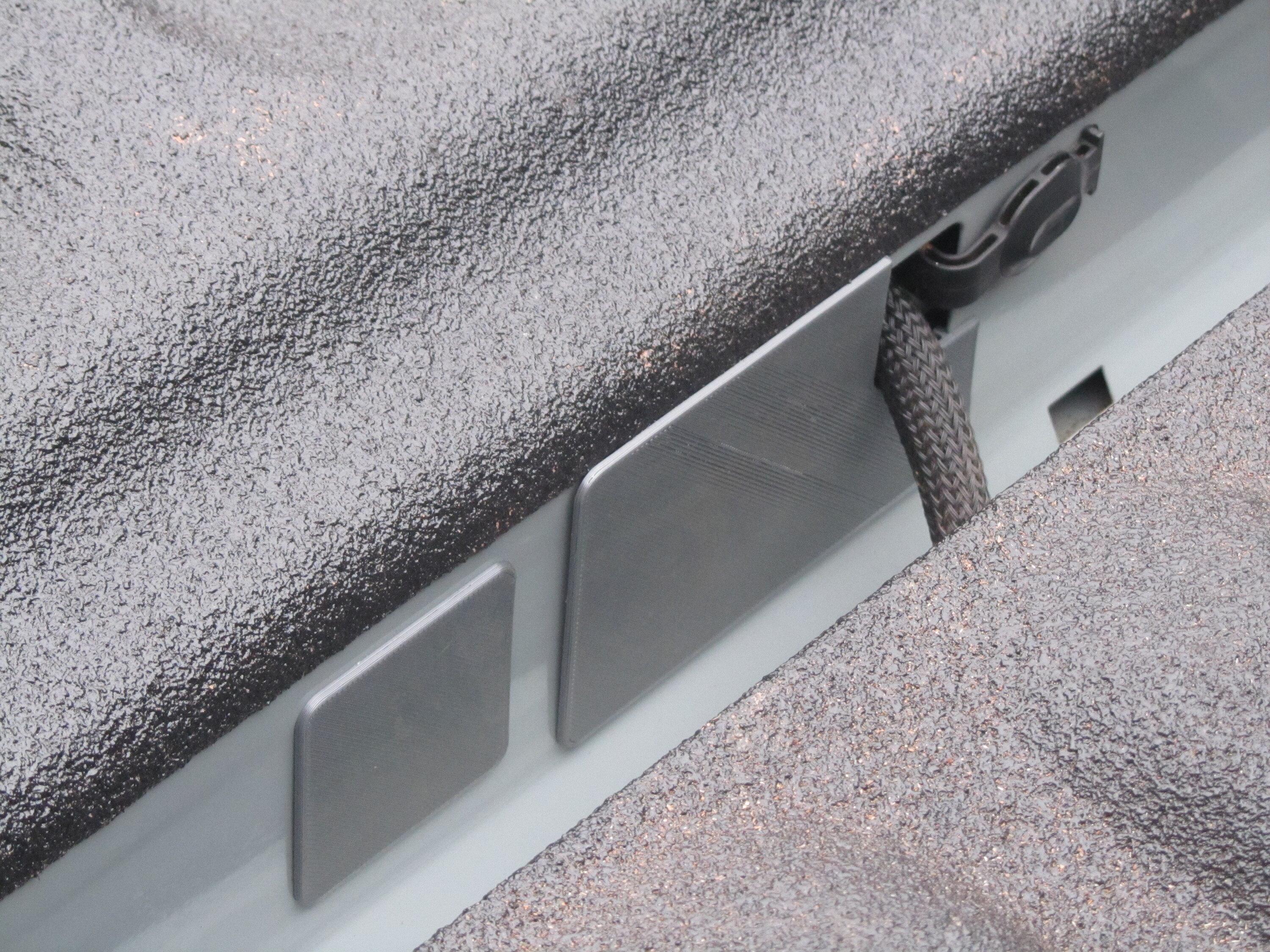

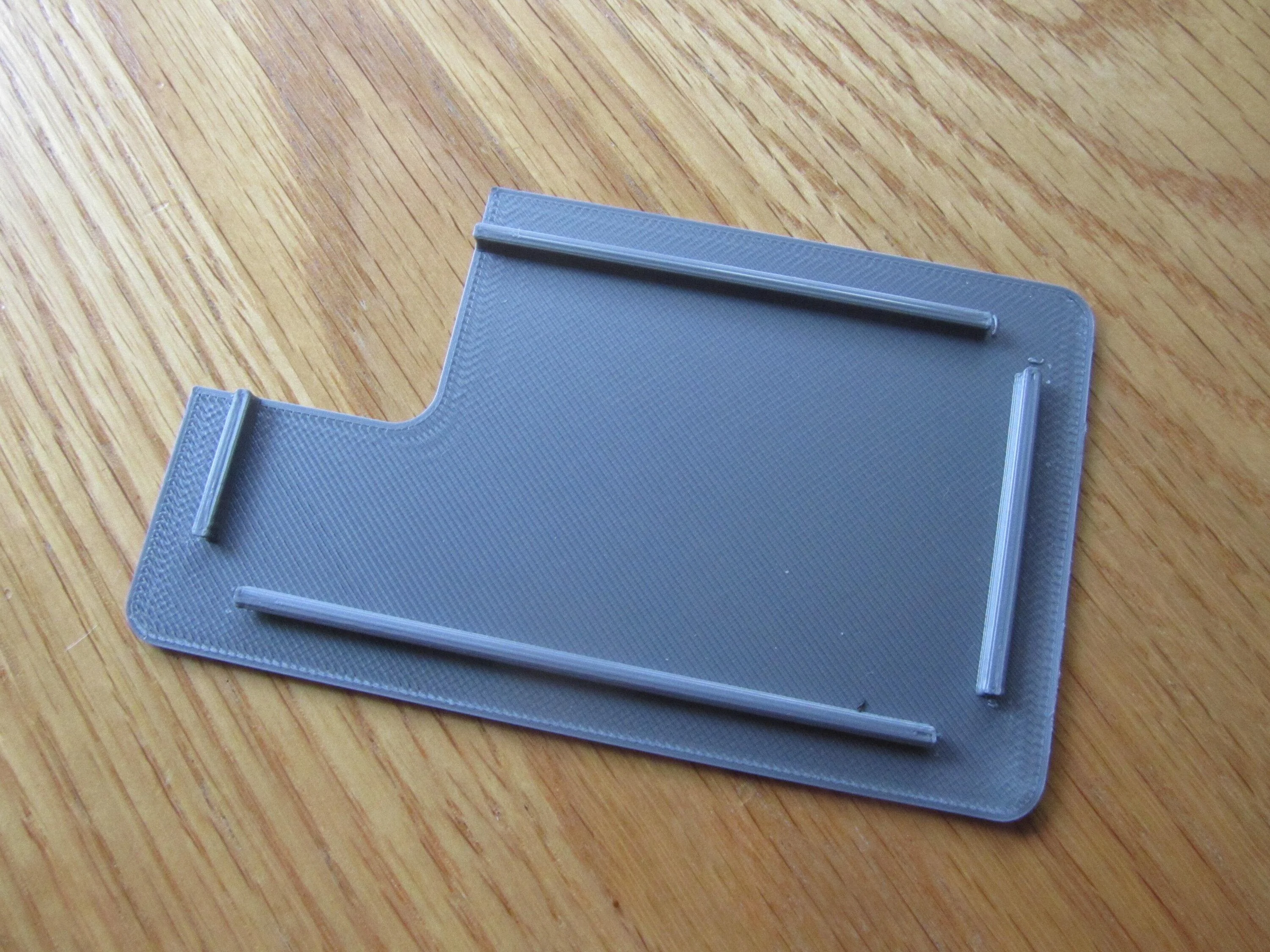

I printed these yesterday and they are a perfect fit. There was a thread a while back where someone had mentioned hauling some pea gravel and some got into their tailgate through these openings and it rattled every time they would close the tailgate. I found this file on a Facebook group with the link to Thingiverse. Printed in Black PETG and took right at an hour. Very practical print and I have not seen anything like this being sold aftermarket.
This is the link if anyone wants to print it themselves.
https://www.thingiverse.com/thing:6265706
Printed out perfect in PLA for a test I will now print in ASA for long term. Thanks for the awesome design!

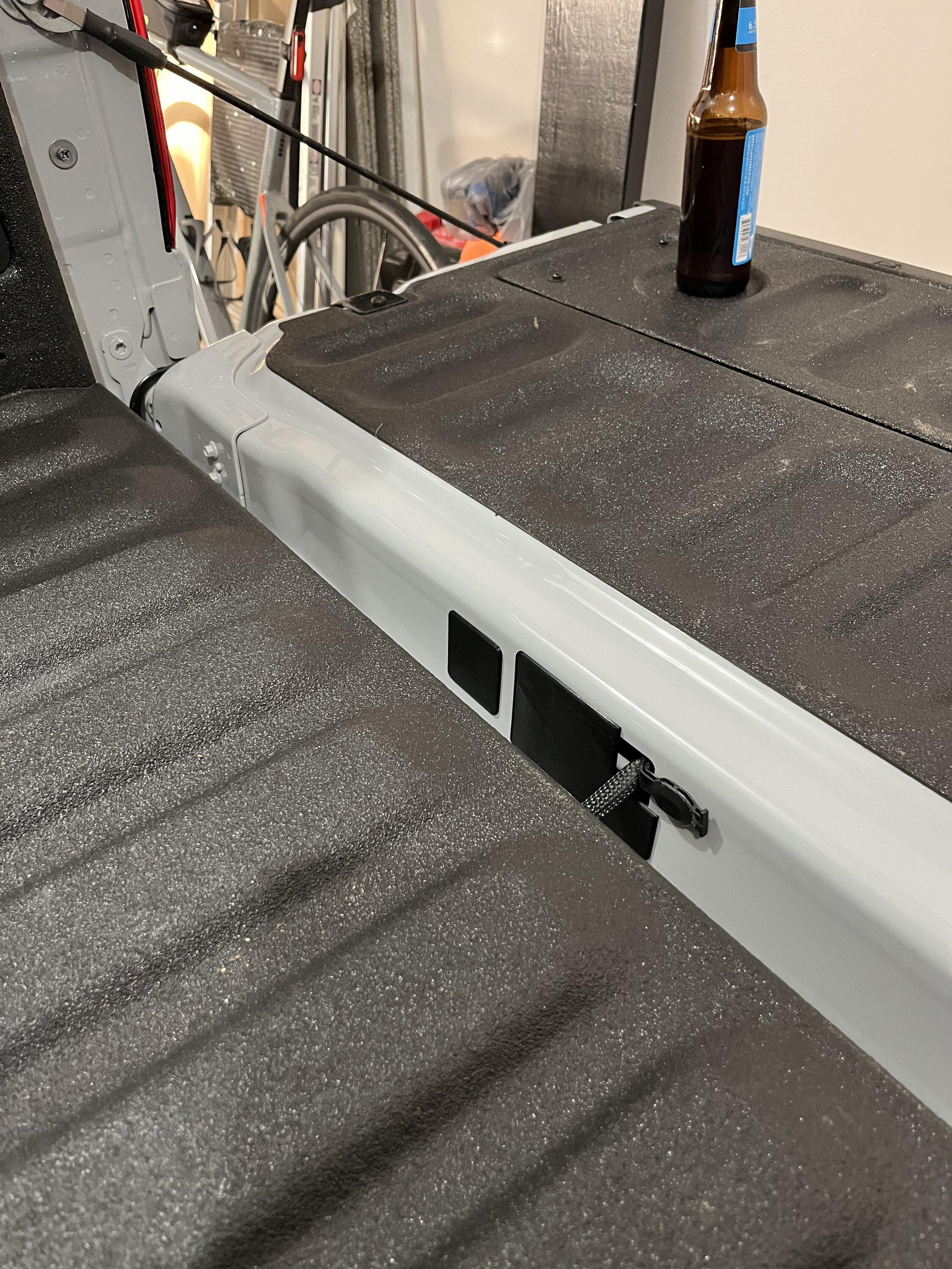

Not sure what settings or plastic or whatever my brother used but I think they came out nicely and snapped into placed like they were OEM.
Awesome design. Nice upgrade for free!
Thanks, Kris Kelley, for posting these files. I had a local community group 3D print them for me and they fit perfectly! It cost me a whopping $2.45 (and that's Cdn) And they did it in a colour very close to my Cactus Grey....real bonus!
