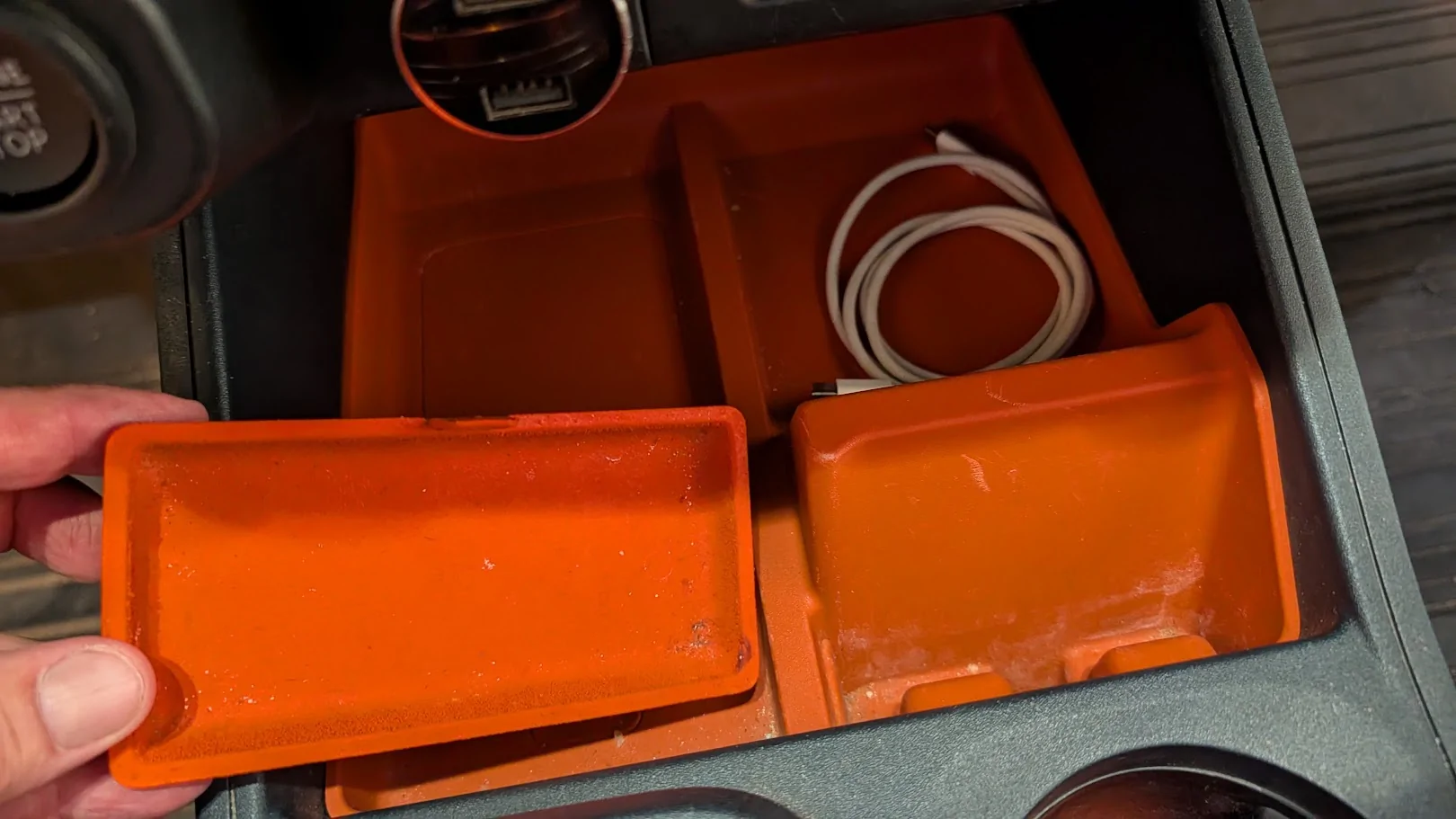

Maybe a little too much red- Here is the stock phone storage tray and the little console
mat I painted with the Hugger Orange-
I felt like the GM swatch of Hugger Orange looked too red as well which is why I wanted to check. I'm going to do a little more accurate of testing to see how close I can get to the right color.

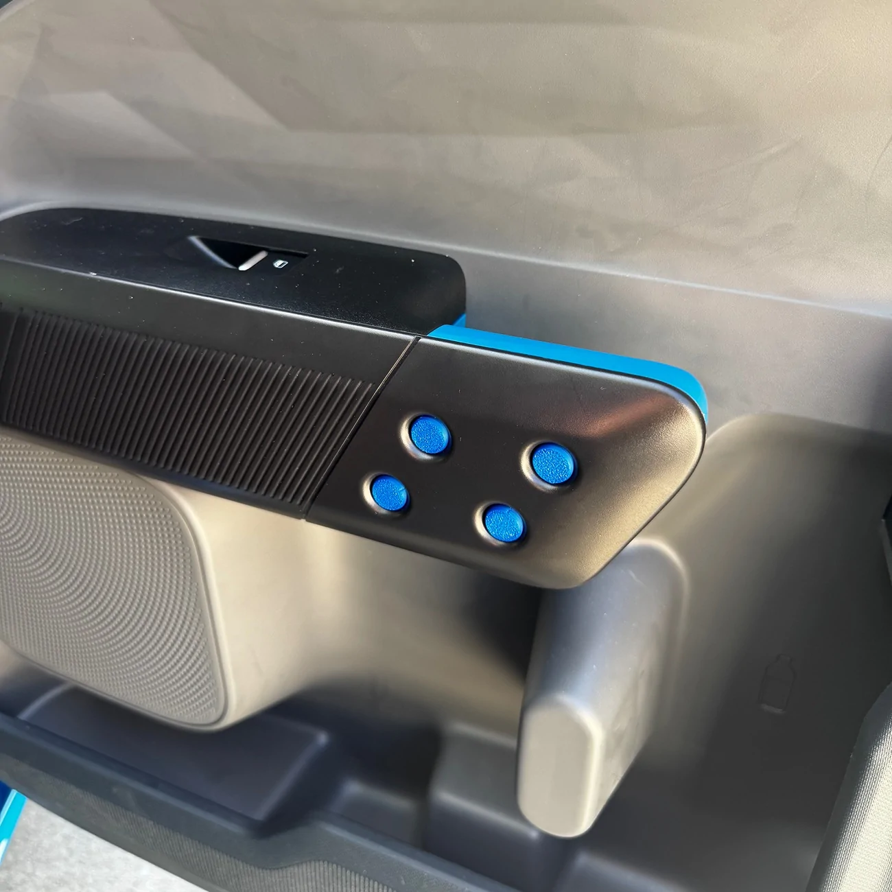

Finally got mine printed. Perfect fit!
Ford Maverick 3D printed caps for interior door handle bolts IMG_2100
Printed on Flashforge Adventurer 5M with Amazon 'royal blue' PLA filament at 220°C and a 0.4mm nozzle.
Looks great! And while the blue isn't a perfect match I think it looks close enough that most people wouldn't notice it without looking closely.
