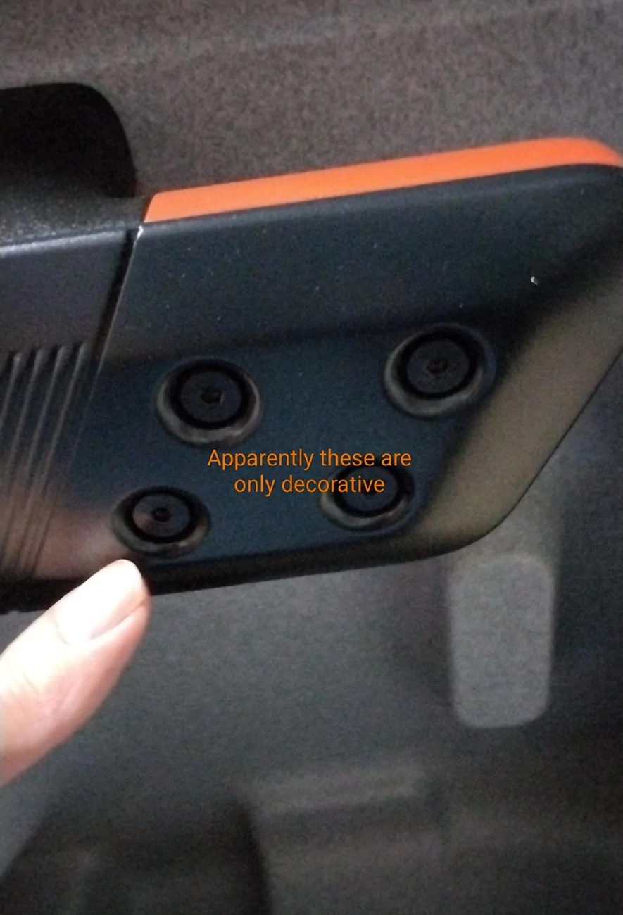

ok the interior door handle covers on the front drivers and passengers door, once the 4 bolts are removed how does this piece come off? are there clips? i have trim tools just dont want to break anything if anyone has done this before. thanks in advance

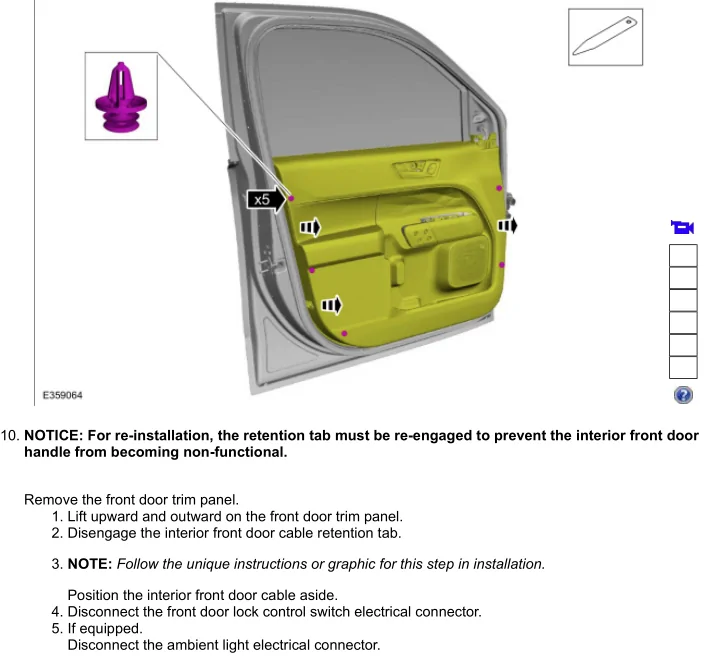

Not a fan of the Orange? They don't come off without removing the whole panel.
