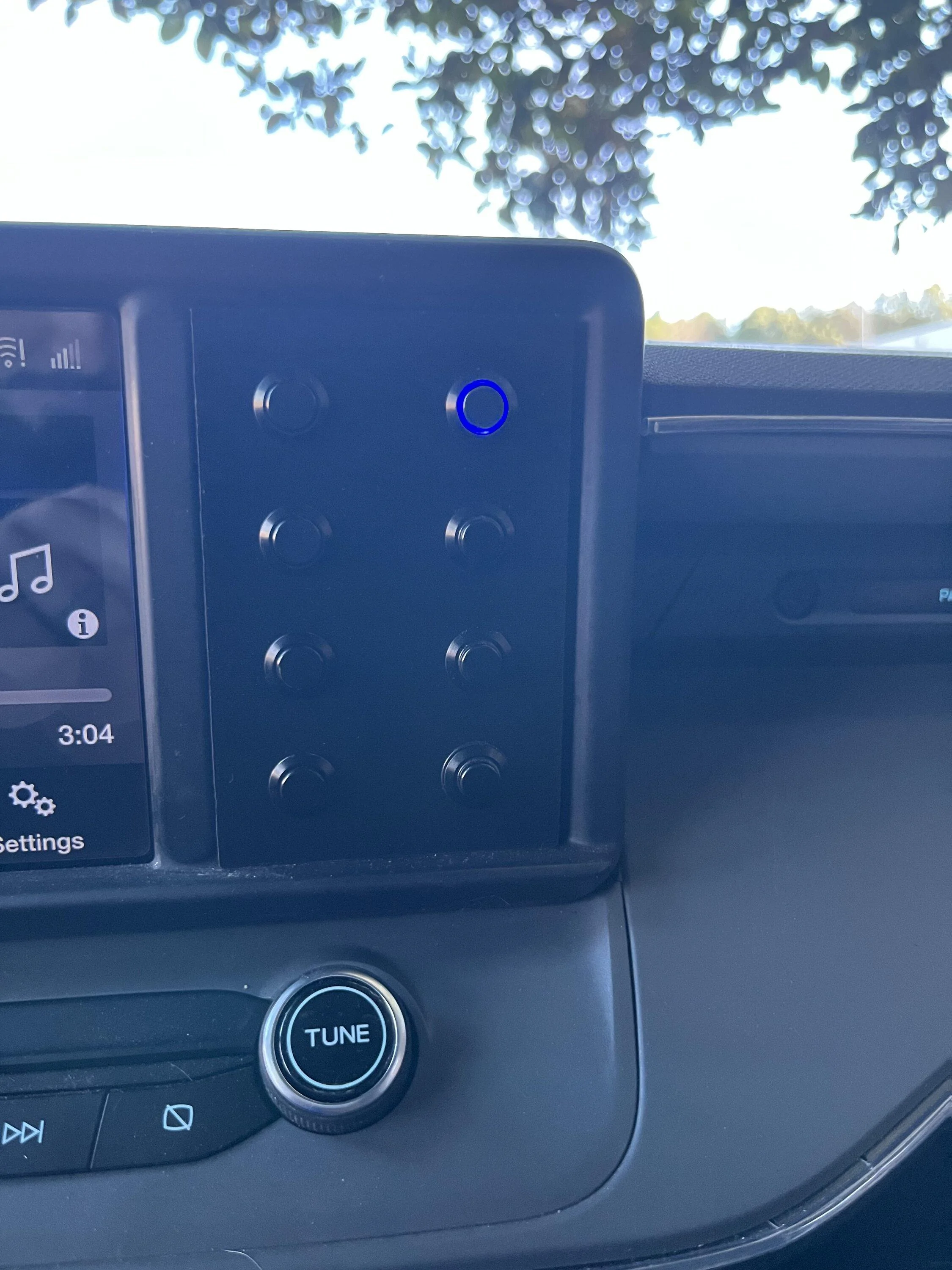

Co worker made me this switch holder for the cubby slot. I have 4 momentary switches on the left and 4 latching on the right. I have the wires going to relays under the passenger switch and then to the accessories. Accessories I have on it/ working on -
Momentary switches- garage opener 1, garage opener 2, school bell ( yes I mounted a school bell and it is hilarious), last one will be train horns button.
latching switches- baby monitor on/off, rear bumper LED pods, work strobe lights, last one will be foreither an LED bar in front or pods.

I like this. How did you wire up your garage opener?

I drilled a hole in the back right corner for all wires to come down. Garage openers are double side taped in the glove box so they don’t move and I just soldered the switch wires to the open/close button

That’s clever. Thanks for the idea.

Those are some masterful electrical technician skills right there! Skills that I sorely lack. Lol
