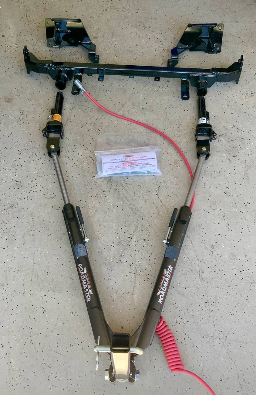

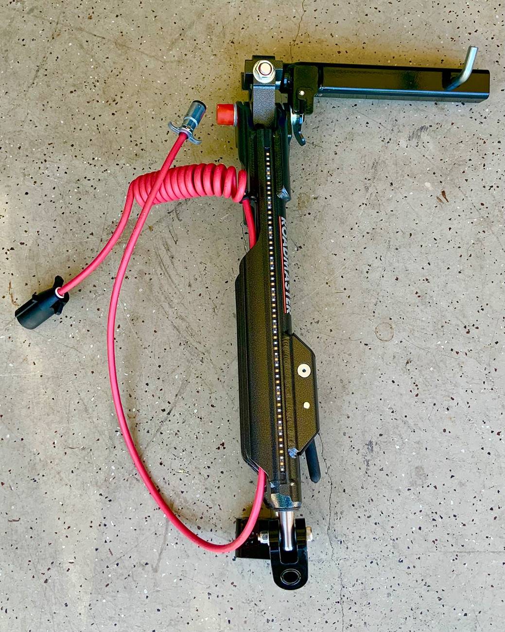

The choices are Demco - RoadMaster of BlueOx I flat tow my Jeep Wrangler TJ using a BlueOx setup - I chose the RoadMaster Nighthawk Towbar and the RoadMaster baseplate which I will install on Saturday
I also purchased the charge line to maintain the battery on my 2025 Maverick Lariat AWD Hybrid

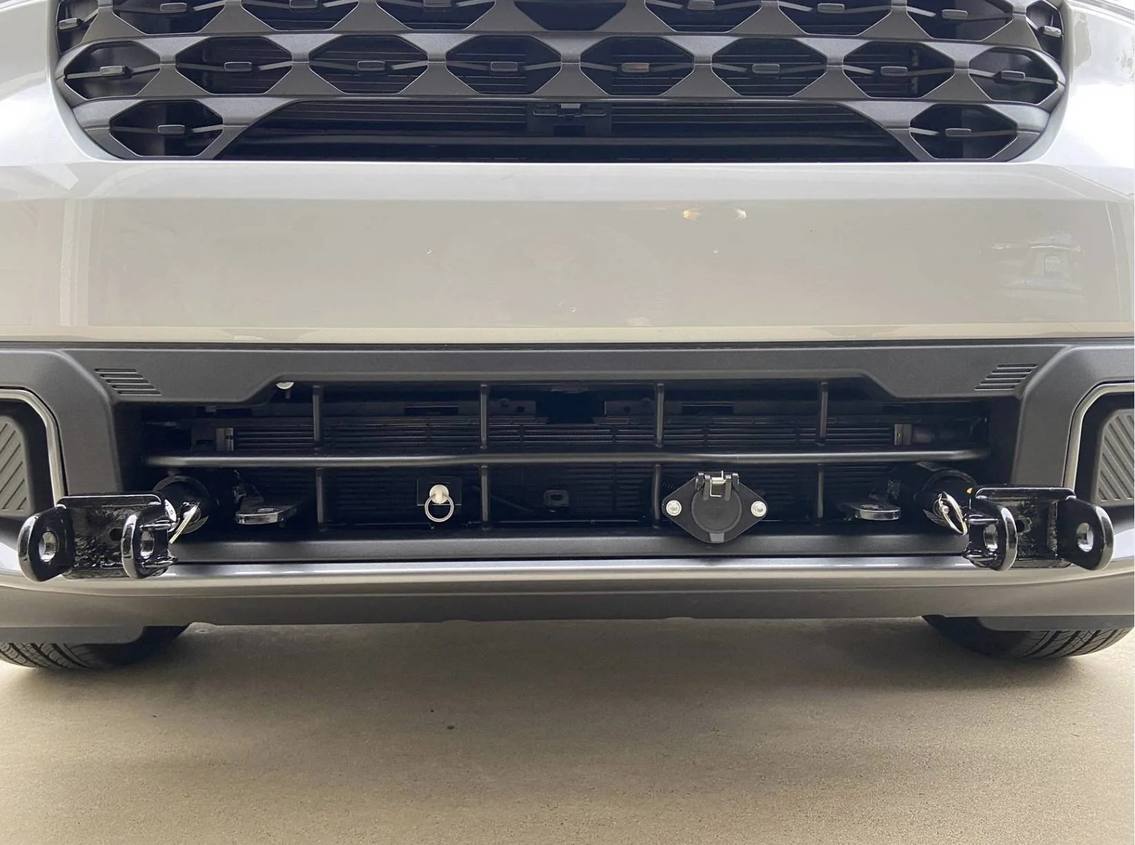

Yeah I really like my new Nighthawk Tow Bar can’t wait to use it in a few weeks - here’s a pic of the install on another 2025 from RoadMaster so it doesn’t look as destructive as I first thought I will know in a few days
I found the install to be pretty easy - very similar to previous one I did on a 2006 Honda CRV. Tows easy like the CRV also!
I think you will love it!
