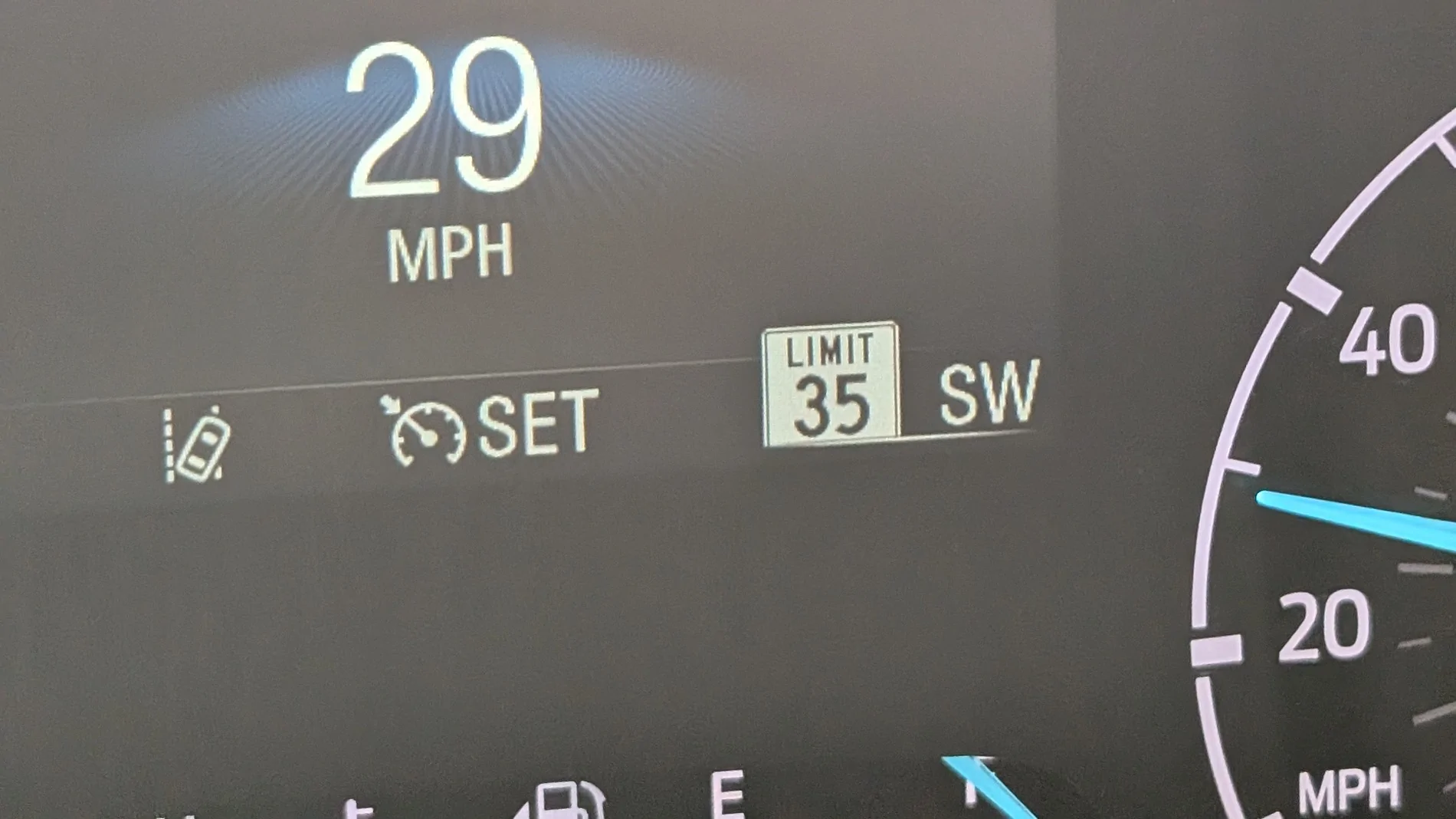

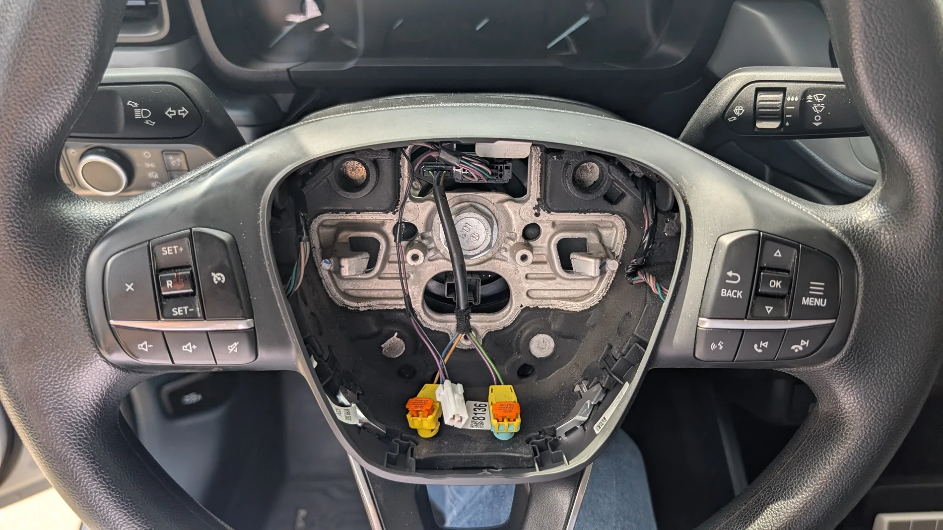

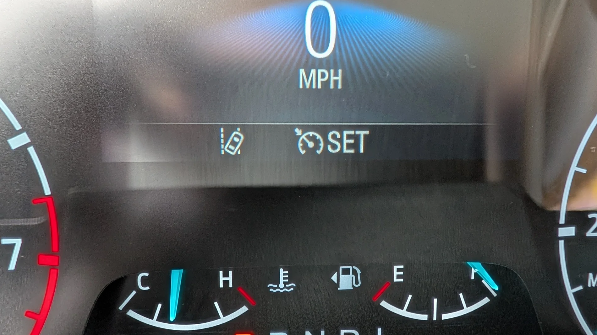

Looks like I'm gonna do cruise, LKA, TSR, and a few my view enhancements.

Enable TSR (Traffic Sign Recognition). I'm not sure what trim level that requires though.

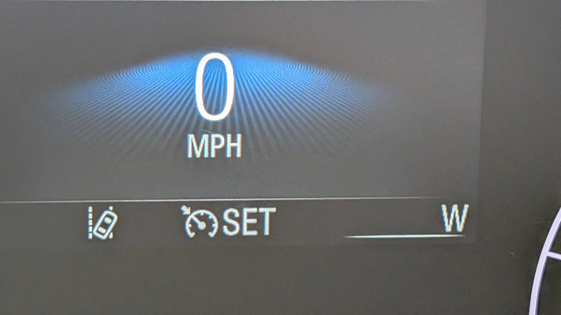

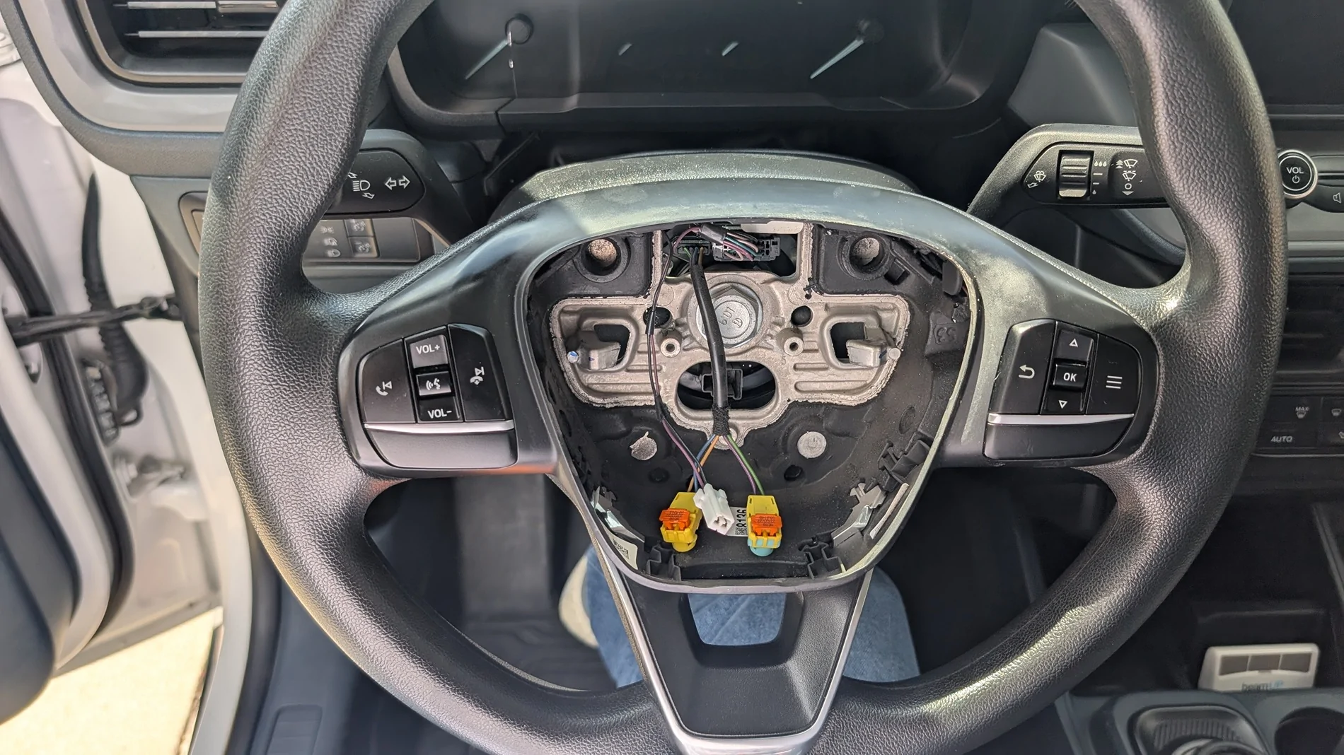

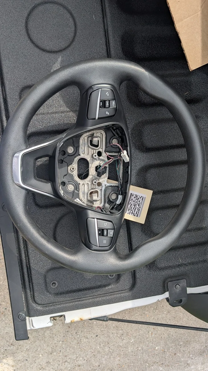

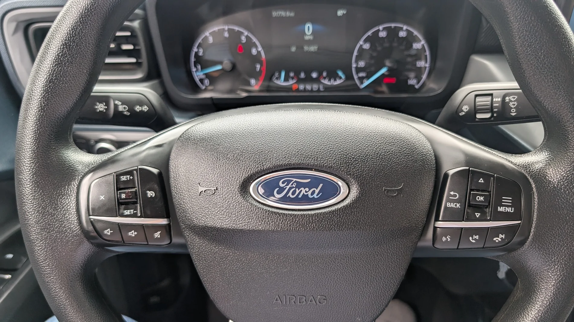

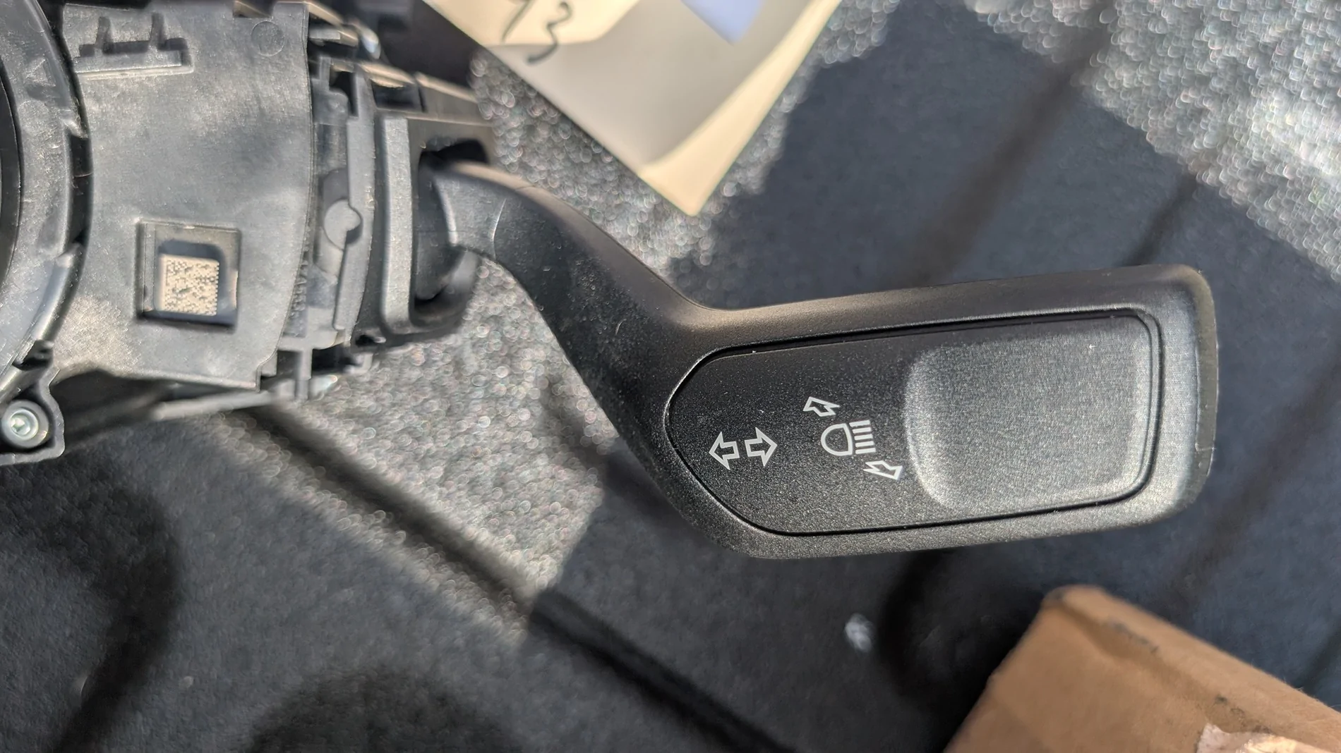

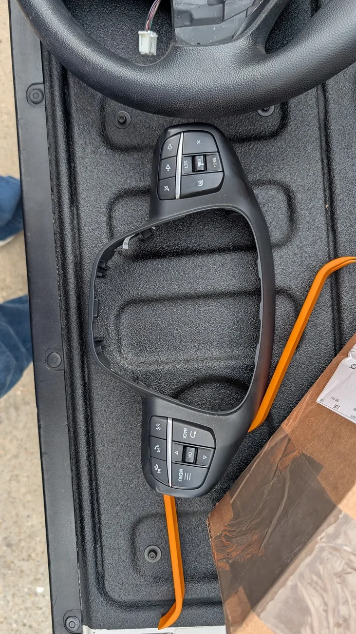

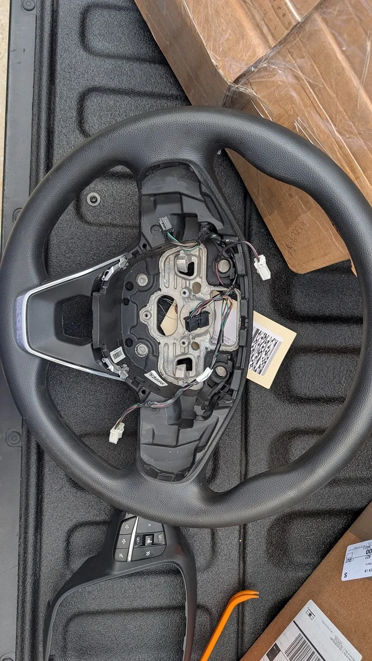

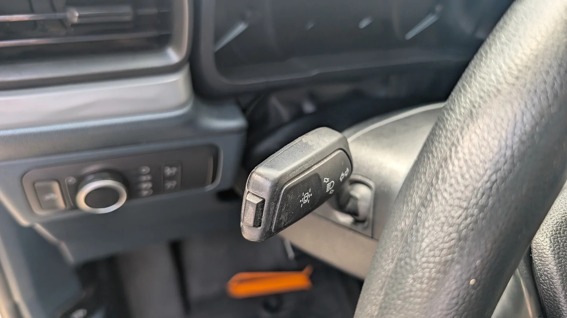

Well this is what I did:
program cruise
program LKA
program TSR
program eco mode, sand mode, mud mode
unprogram sport mode
program eco coach
changed battery charge limit to 95%
