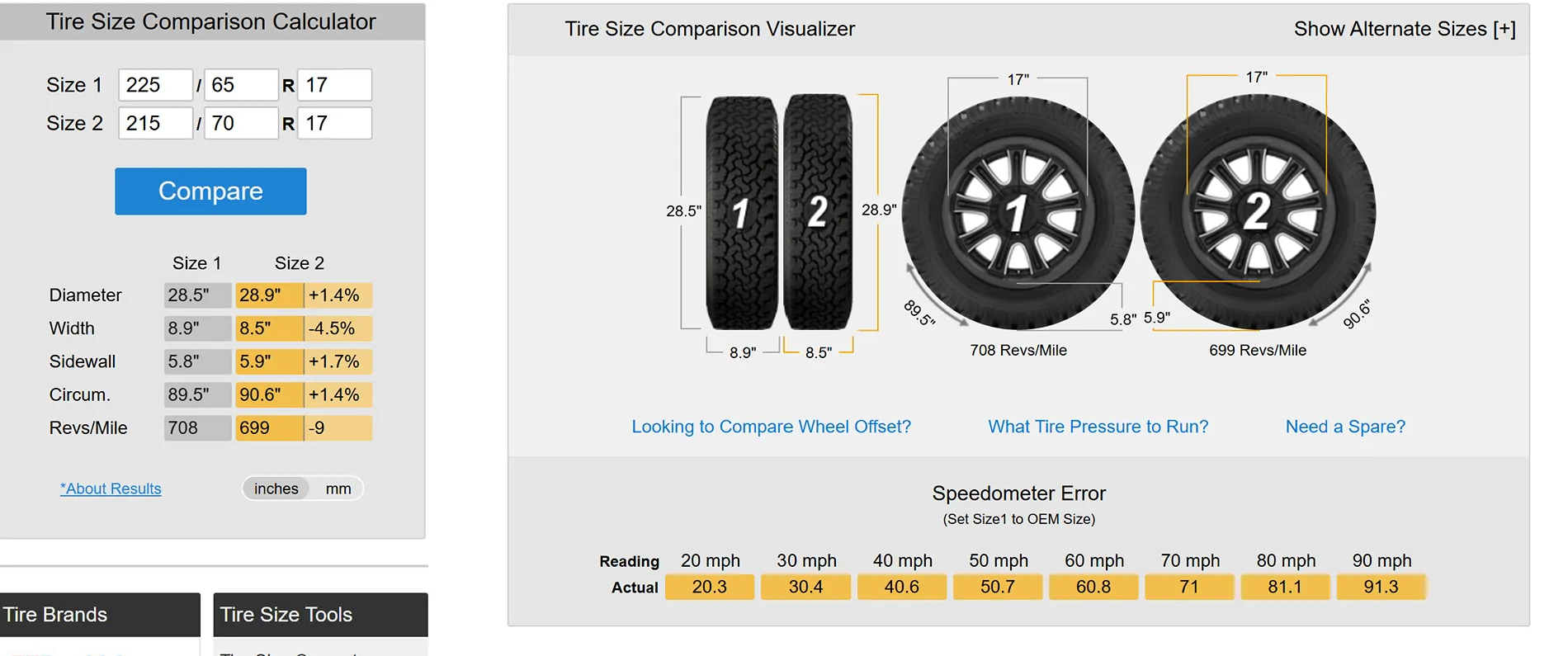

Is any one using 215 65 R17 Tires. If So any Issues? I am asking because I went to a Skinner tier on MY 05 ranger and got a Bump in MPG on it , My 225 65 R17s are fine right now but I am looking at the 215 65 R17 when the time comes. Just a Idea Right now.

Did you re-calibrate your speedometer/odometer to compensate for the smaller diameter tire?
Your odometer would have been reading high, so maybe you thought your were getting more mpg's.
