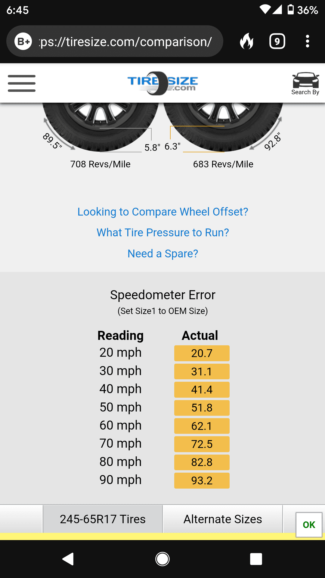

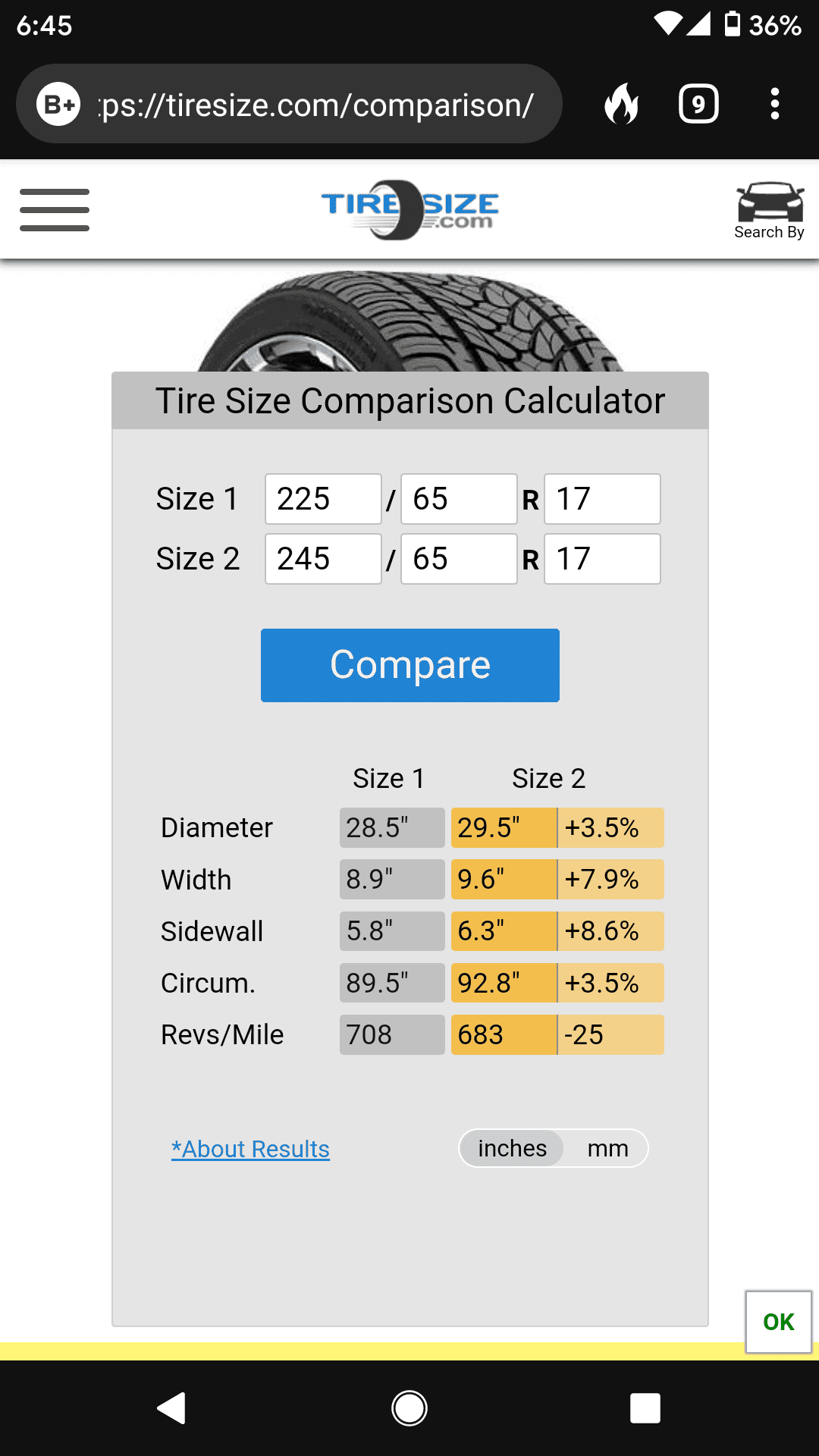

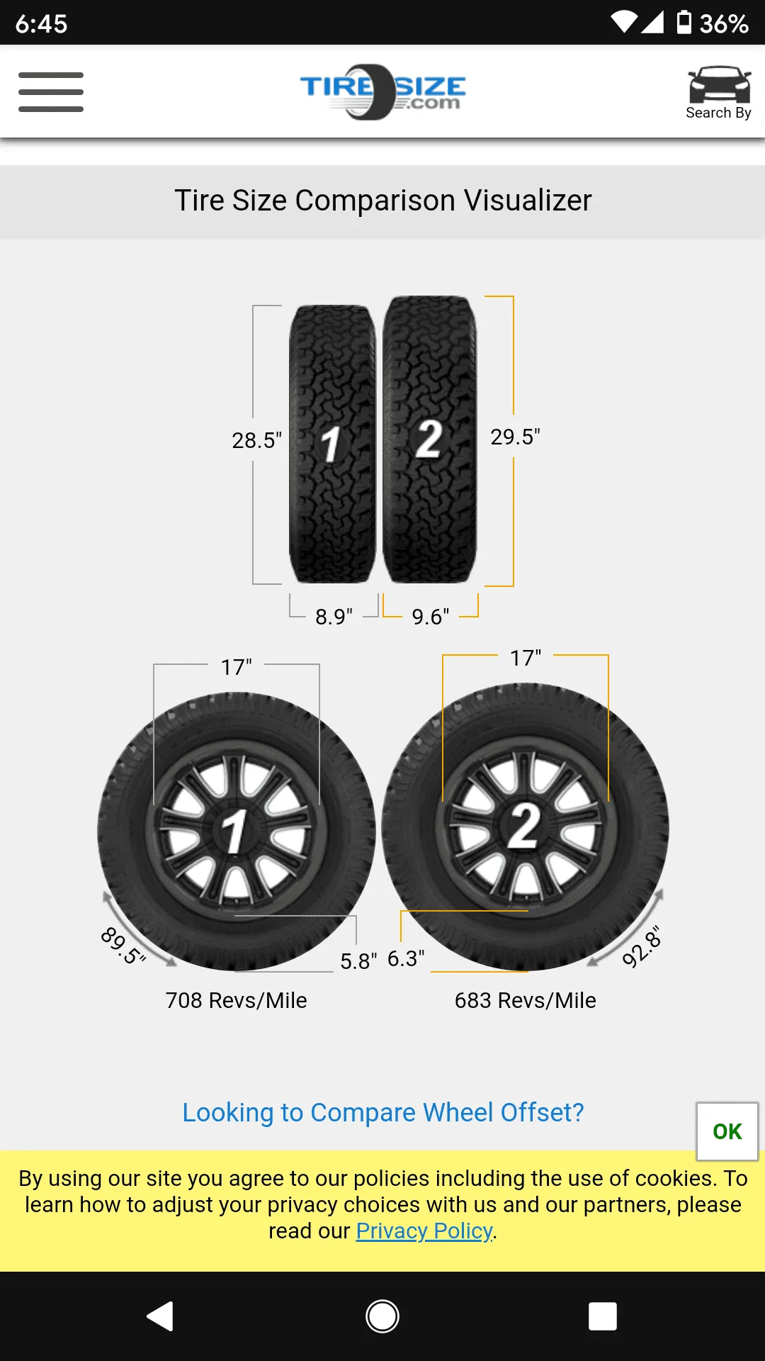

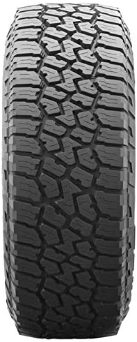

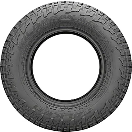

Looking at Falken Wildpeak AT3W All Season Radial Tire-245/65R17 111T for a Tremor
Little more money than KO2s but a half inch taller and wider while five pounds lighter @ 39# according to Amazon.
On my second set of KO2s on the Raptor and know those tires pretty well and know they're not the greatest on snow while the Falkens have a better snow rating.
Planning on swapping them out at delivery, I have an inside guy .
Question to y'all is, any rubbing from width during turning or in articulation?
