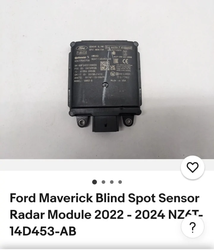

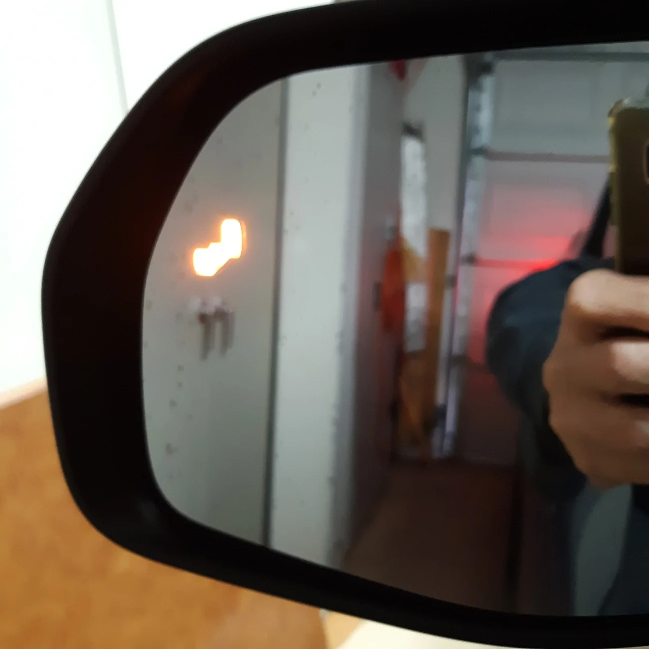

Unfortunately adding the BLIS system to your Maverick is going to be involved and expensive.
Just thinking about the parts makes it quite involved and economically quite expensive.
You'd have to replace both outside mirrors with ones that have the lights in them. I have no idea what those will cost$$$
You'd have to get the the two units that go in the bumper. Used these are anywhere from $100 to $200 a piece, plus wiring and programming if possible.🤷‍♂️
