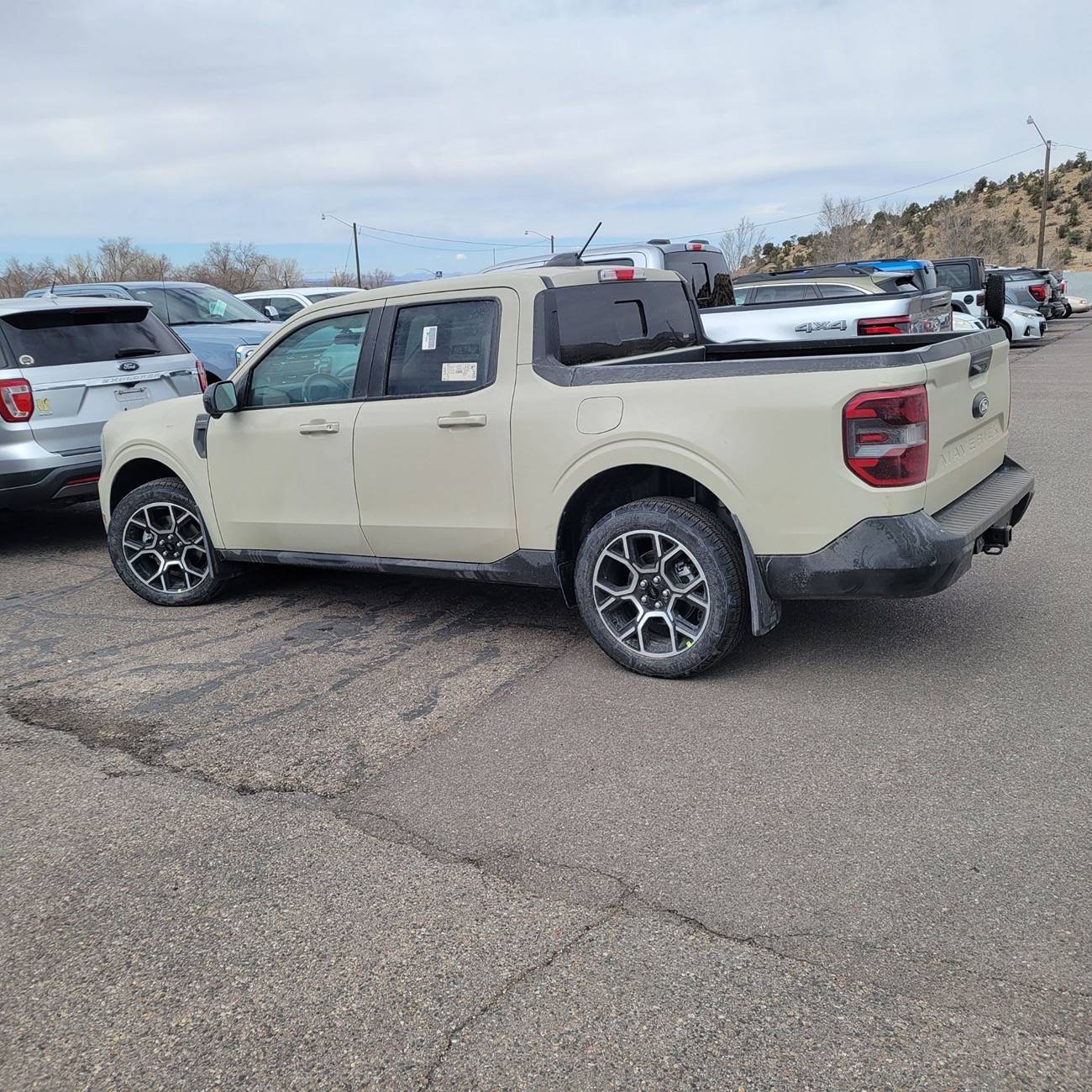

Really like the stance with those tires! Just bought my Mav and first mods will be a lift and tires and rims. Can you share the tire size and rim offset? Im planing the leveling kit right now thats 1.5 up front and .9 rear
Falken Wildpeak 245/65 17, purchased complete from the Tirerack. Stock offset

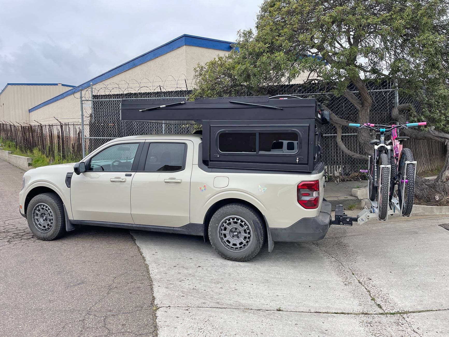

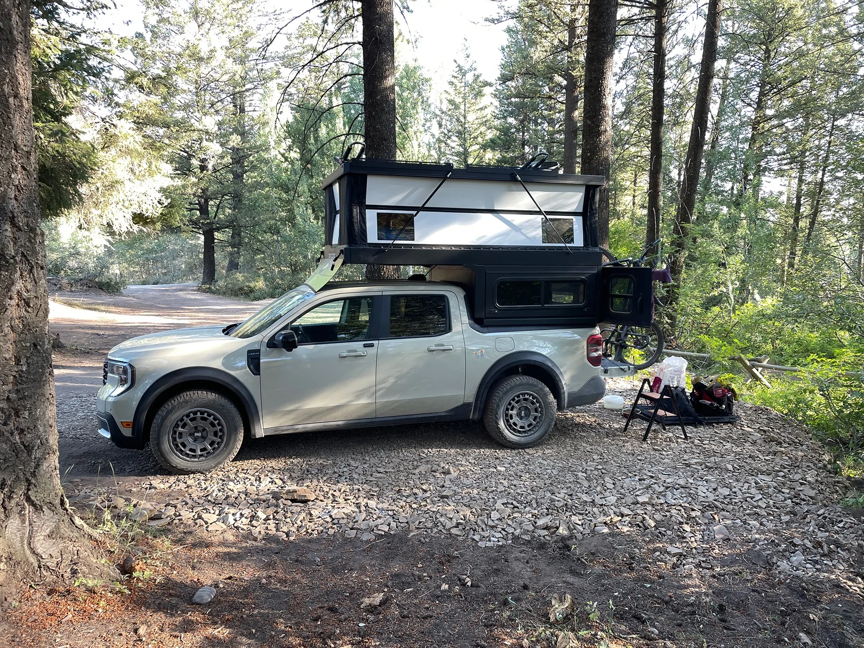

Finally got my suspension installed, 2” lift with overload springs and damper adjustable shocks (Flatout GR Lite) and Tmbren Jouncers.
Ride quality is excellent, just a little firmer that stock, tight handling, feels great!
Before adding the lift, I was arse down a couple inches with a full bike rack, now it sits even rear to front when loaded.

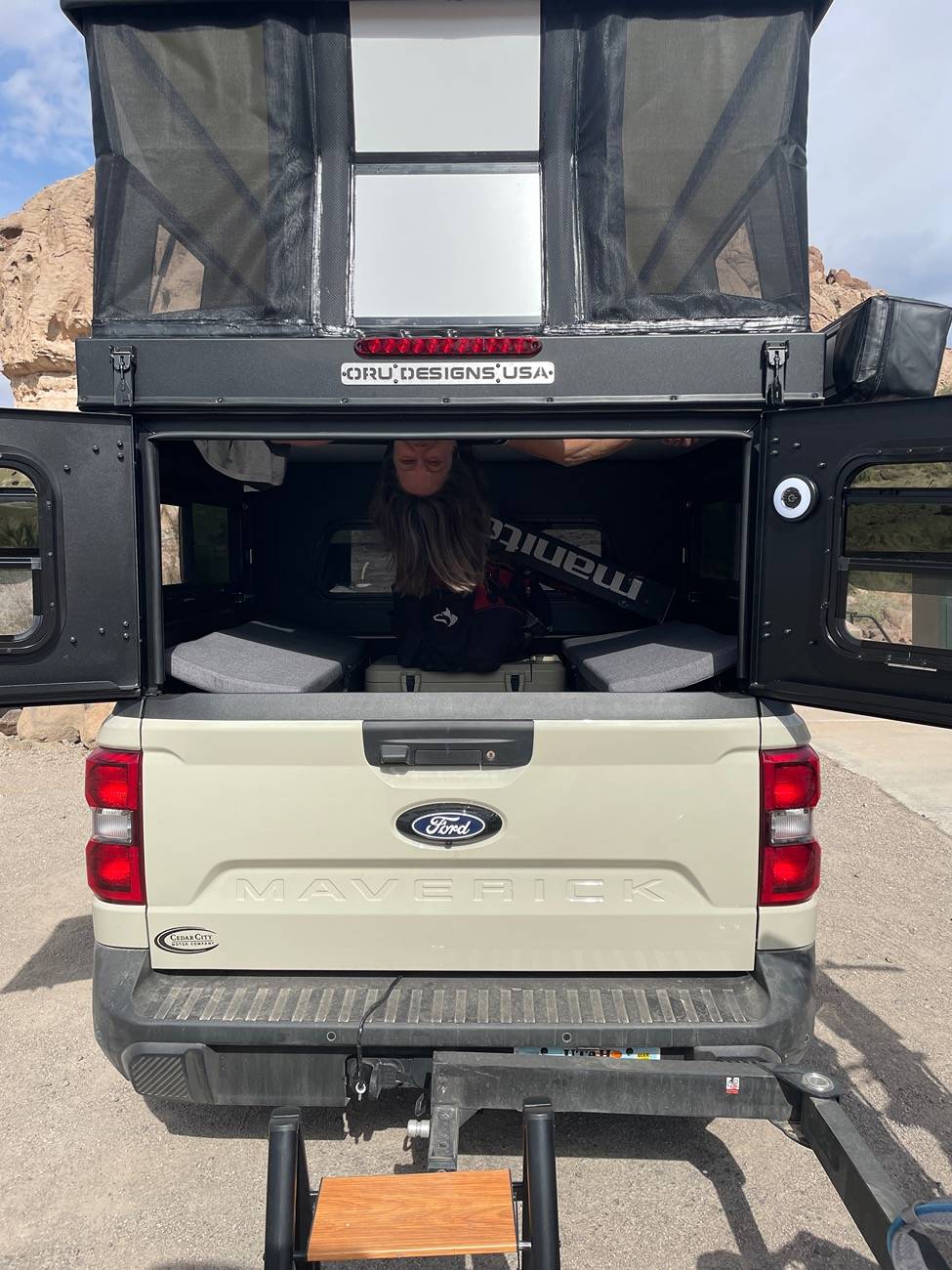

Oru camper works great, mattress is an RV Queen, lots of room popped up, had to swap to stronger struts once I added solar and paddle boards.
In the bed I built cabinets over the wheelwells, storage and water on the drivers side, lithium battery and diesel heater on the passenger side.
The base camper is #350, the rack and swingaway add 75#, solar is another 50# with cross bars, bikes and SUPs add 200#.
I like it better than the Scout Tuktut, more head space, bigger mattress, half the price, and I can park in the garage 👍
Before:
After camper
After lift kit
Full Monty:

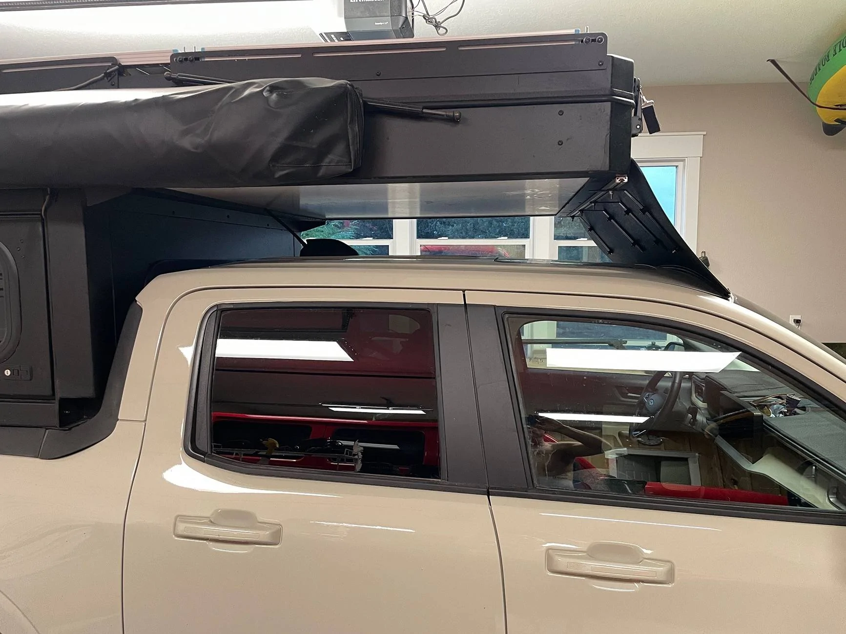

Nice setup!! I was interested in getting an ORU until I saw how high above the cab they build it, why on earth did they do that!?!?
Agreed, what an aero trap that gap is.
BenK
Ben
Mar 19, 2025
43
63
Utah
2025 Maverick AWD Hybrid
You know what they say about six inches ... :crackup:
So yeah, dropping the camper six inches would make it tight for head room, and you'd still need an air dam.
The reason the gap "seems" so large is the cab height is so short.
I'll take head room over aesthetics, but if I was into looks I'd get a color matched shell and pull a camper.

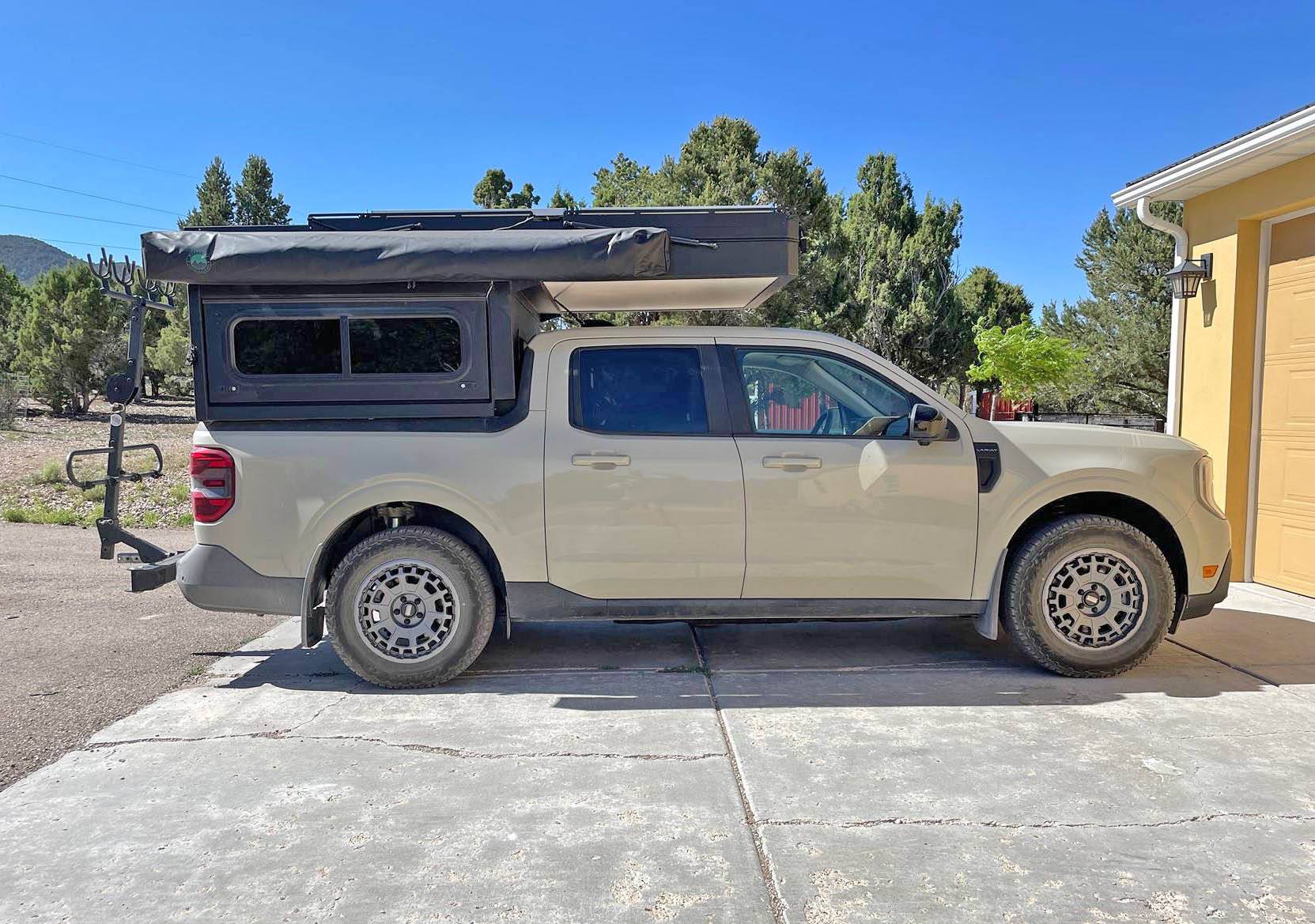

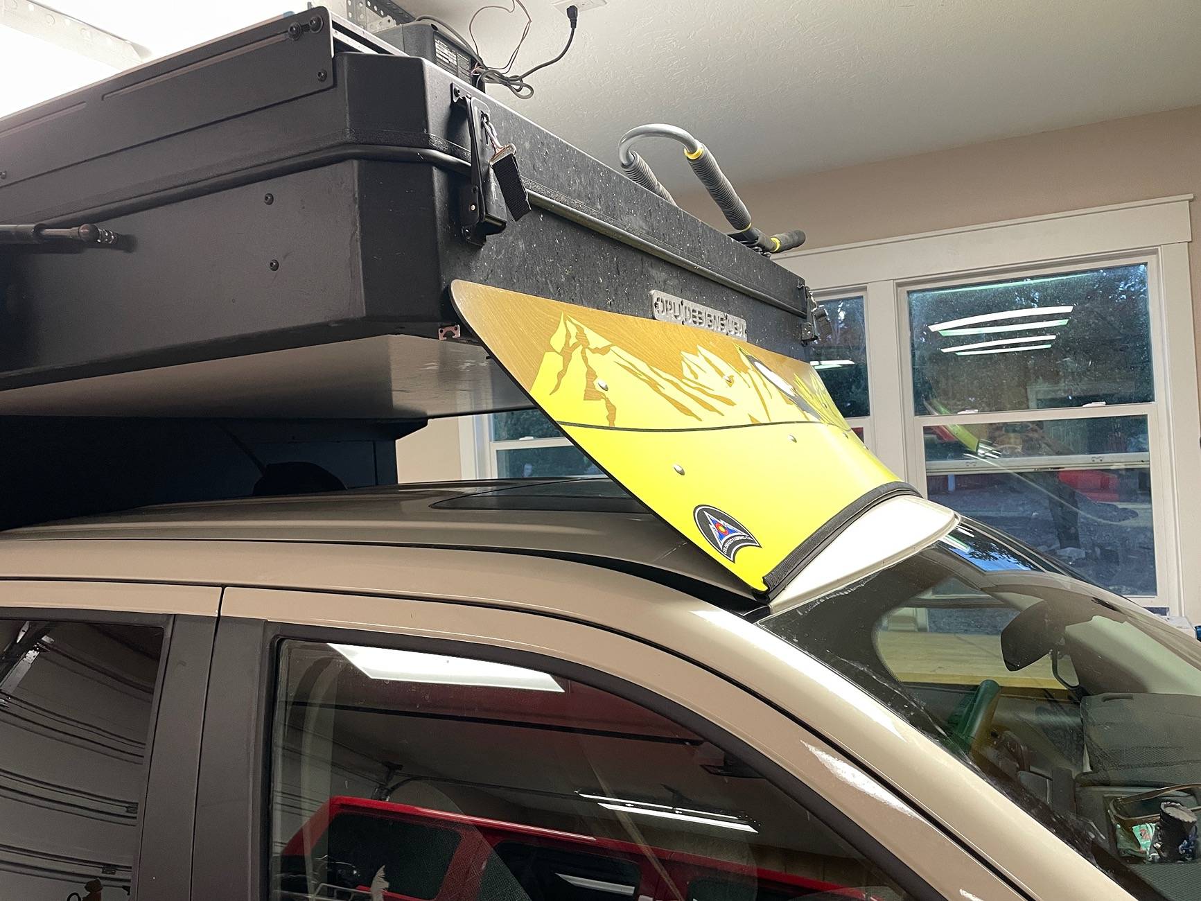

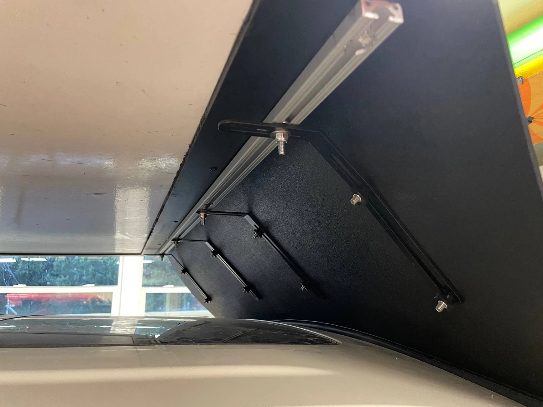

Colorado Air Dam mounted, used a simple L track and T bolts, riveted and bonded with silkaflex, much quieter, mpg up to ~ 26 mpg freeway, 28+ in town.
It’s still less than I’d hoped, but it beats anything else I’ve built for camping including a Promaster Diesel 118.
The more I drive it, the better I like it: super comfy, pop top with a queen 6” mattress is the cat’s meow, and the all wheel drive is at least as good as a RAV 4 or Subaru.
Granted, it’s not really an over lander, but if I have that in mind I’ll take the wife’s Jeep Wrangler 😆
Ford Maverick 2025 AWD Hybrid + Oru Camper + Flatout Lift Kit IMG_8557
Ford Maverick 2025 AWD Hybrid + Oru Camper + Flatout Lift Kit IMG_8559
Ford Maverick 2025 AWD Hybrid + Oru Camper + Flatout Lift Kit IMG_8558
Next up: increase lift 1” front/1.5” rear, it’s currently sitting at stock. The lift kit has adjustable spring perches, so you can add lift up to 2.5” with the same set of springs.
