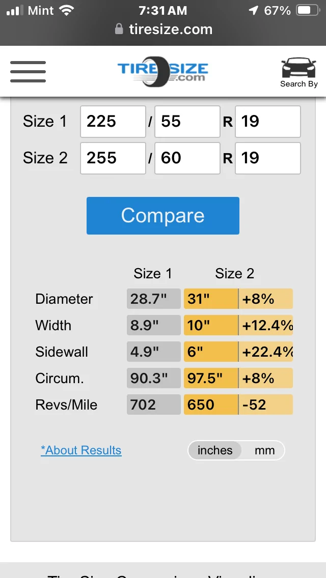

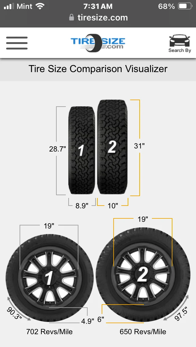

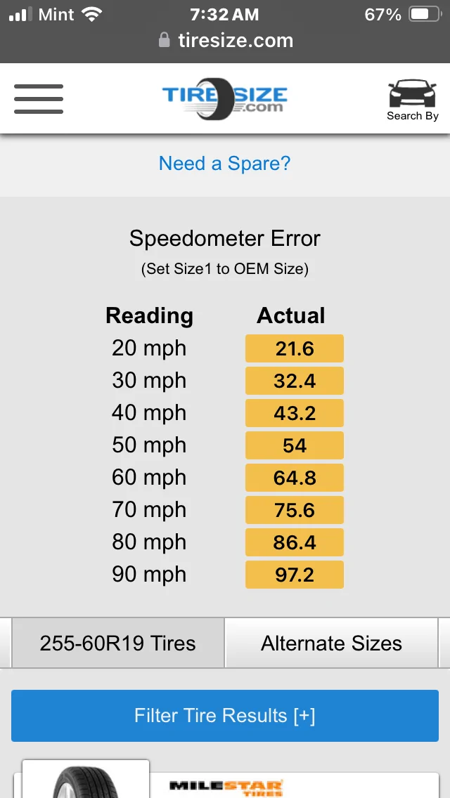

255/60 R19 would be sweet!
Am I dreaming?
31" diameter is too big. About 29.5"-30" is the limit.
Edit to add: they do also appear to come in 245- or 255/55R19 which probably might fit.

It's a hybrid so much larger/heavier wheels will affect fuel economy more than they would on an ecoboost.
Your stock size is what? 225/55/19, right?
I'd say 245/55/19 is the biggest you should go otherwise you will just be killing the fuel economy way too much.
