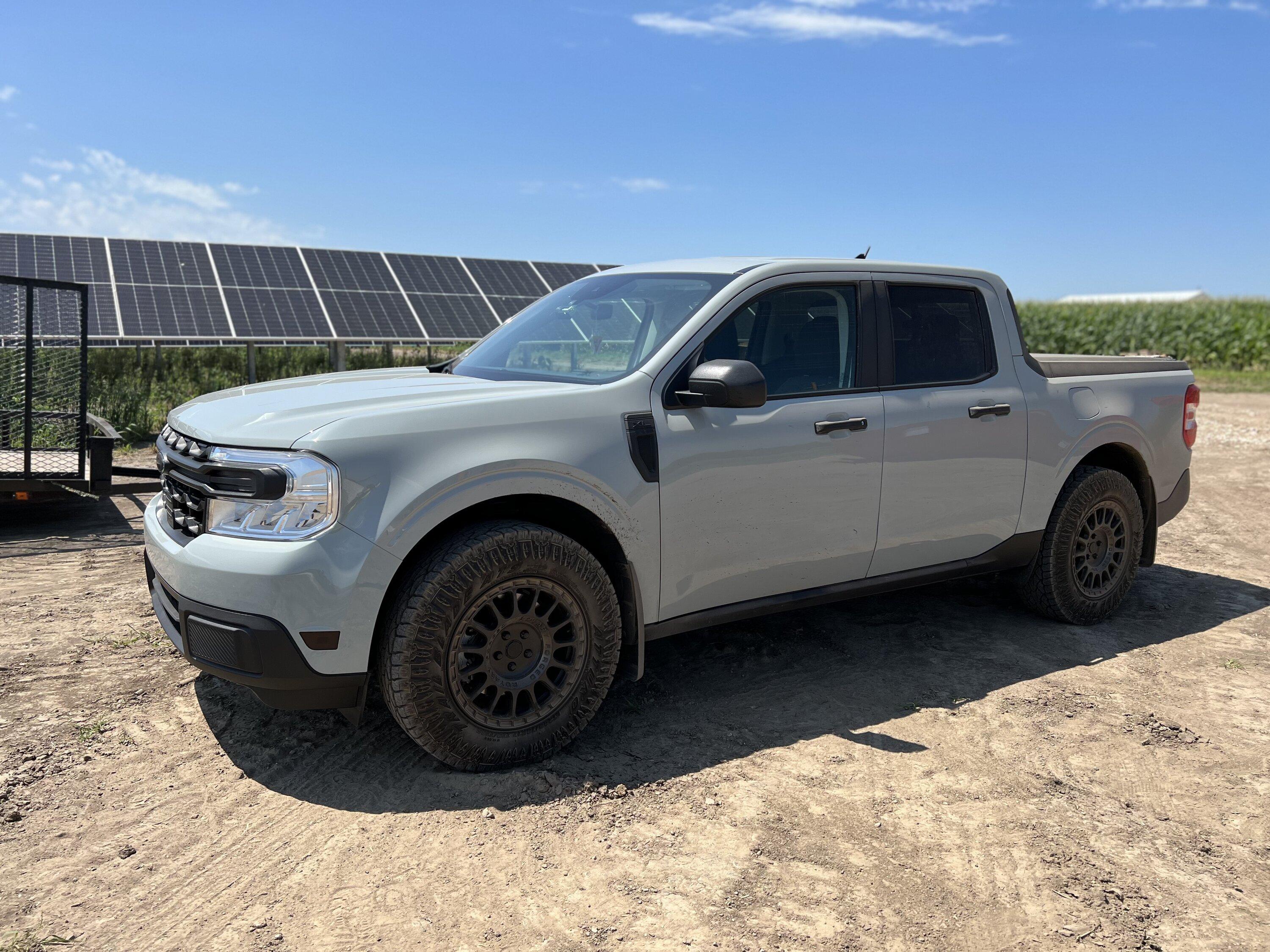

I have 245/70/17 on mine on stock suspension and I do not rub. I think that same size with 2.5 lift would look pretty goofy. I want to go with bigger tires next time.

Wow 245/70s without a lift?? Well I must be able to go bigger with 2.5”s of lift…..
Damn good looking truck!

Not any that I've noticed, I have 23k miles on my Mav with this wheel setup. Some tires will have a more aggressive tire pattern which can rub on the felt fender liners like the Toyos, but mine didn't. It is really close though.
When I go bigger I will probably grind the pinch weld and lift it 1" once there is a good shock/spring lift.
I have Atturo Trail Blade ATS in 245/70/17

Thats good to hear. Our Tremor should take the 245/70r17 Maxxis Bighorns with ease then.
