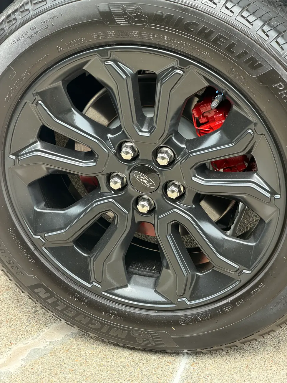

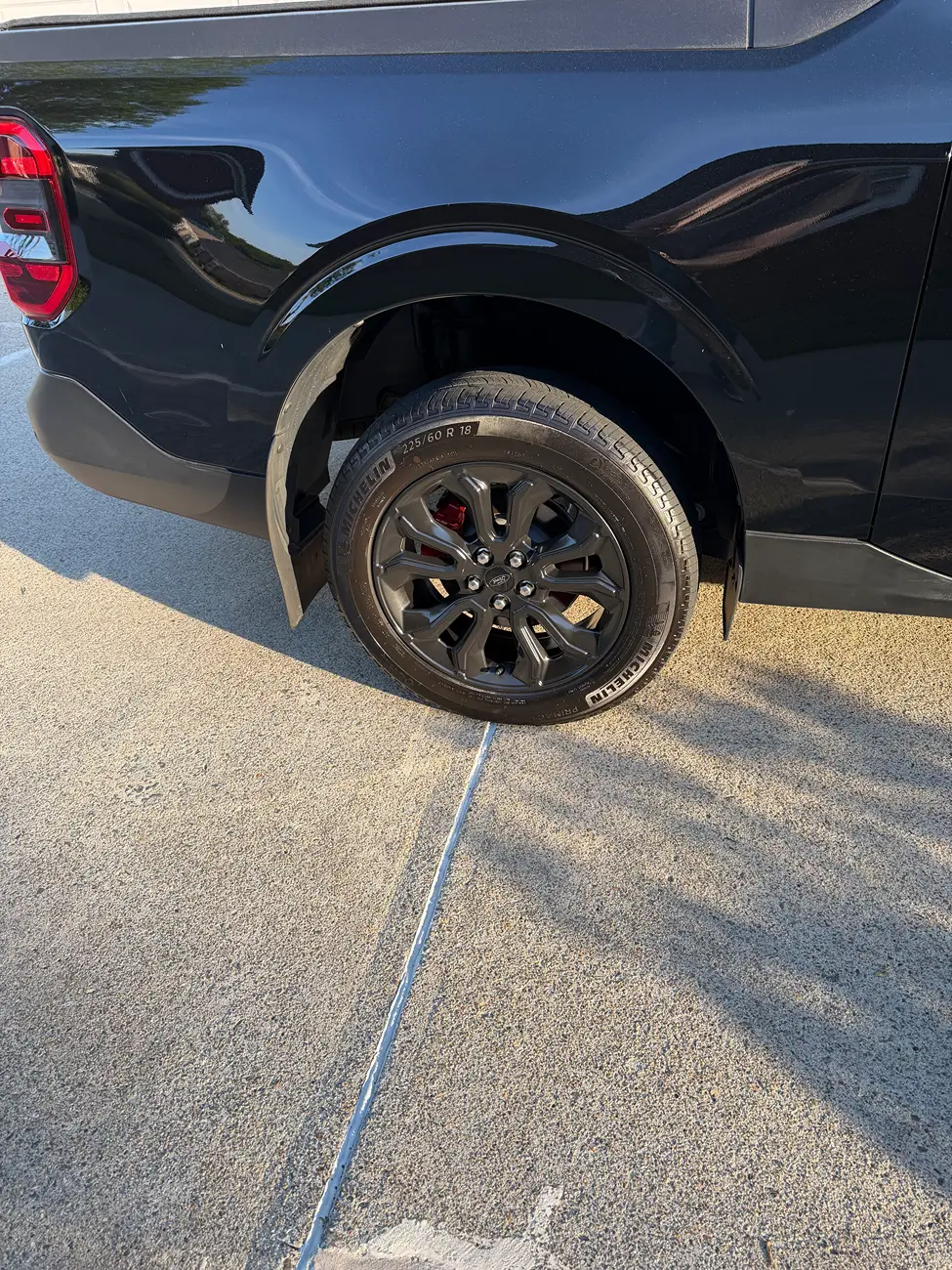

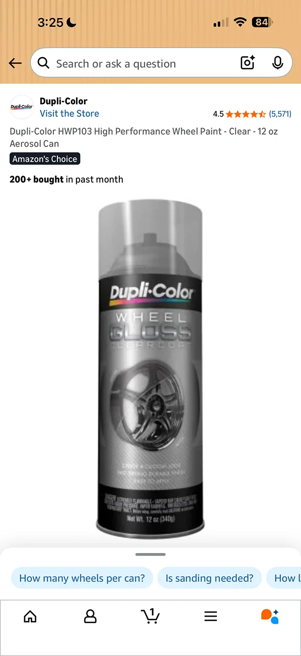

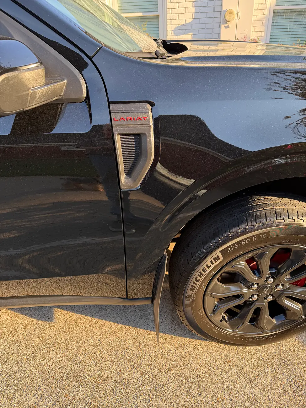

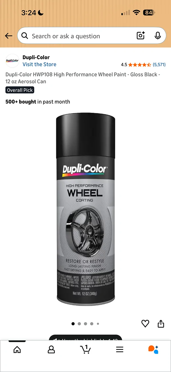

I decided months ago that the stock 2024 Hybrid Lariat of mine needed gloss wheels instead of the satin black factory look. I jacked the truck up using a bottle jack, one corner at a time. Used 2 and 3 ton jack stands to mount the Maverick off the ground. Worked great. Removed all wheels. Scoffed the rims with 3M green Scotch-Brite #96 pads or you can use the same thing found in grocery stores as a scouring pad or at Home Depot or Lowes marketed as a sanding pad. I primed the wheels with Rust-Oleum primer and used Dupli-Color high performance wheel spray gloss paint. Turned out great but the photos do not show how great they look. The Dupli-color spray paint is awesome, gives a super fine spray with no orange peel. Top coated with Duple-Color Clear finish. Painted the calipers red with Rust-Oleum caliper spray paint and painted the "Lariat" on the fender badge.
