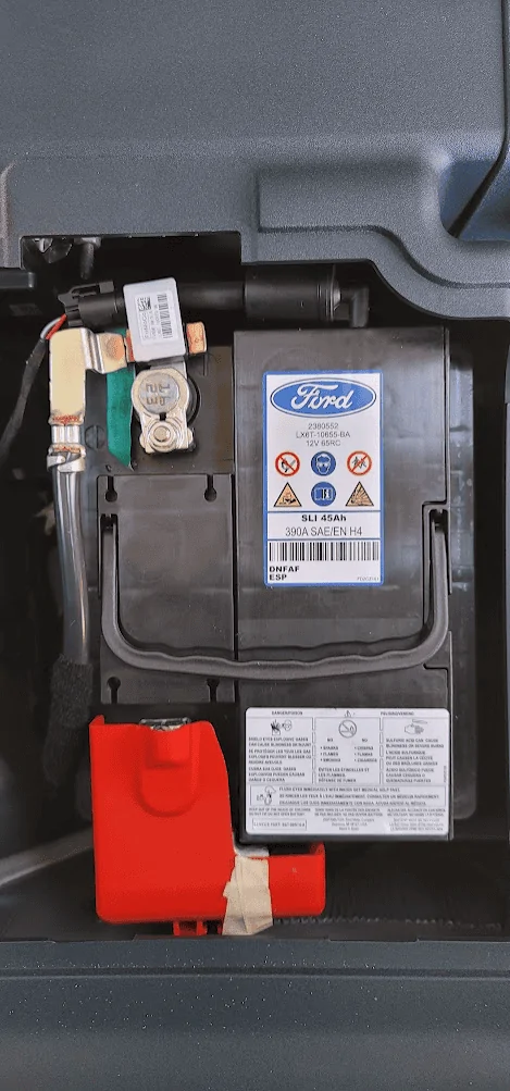

Bummer, I was hoping the AGM battery was more robust than the flooded battery they put in the Hybrids (BXT-99RT4-A). I guess I'll keep trickle charging every month or so just as insurance for not getting stranded and get a 3rd party battery later. Unless it is just a bad batch of parts like the CV axles.
