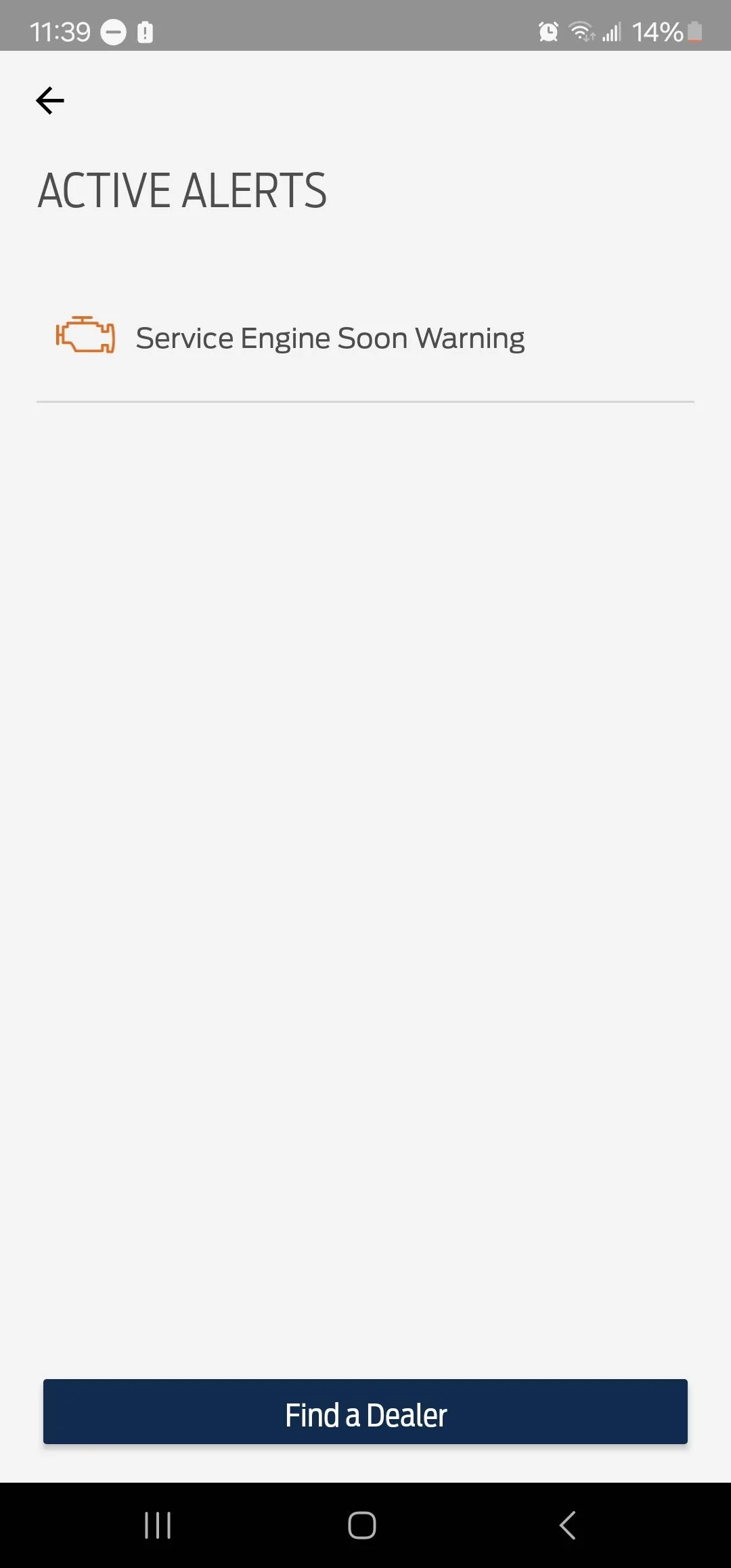

When ypu first had these problems, did your engine make a diesel-like sound? Like on my vid:
Ford Maverick 2023 XLT Hybrid gas engine won’t start Screenshot_20240309_233916_FordPass
