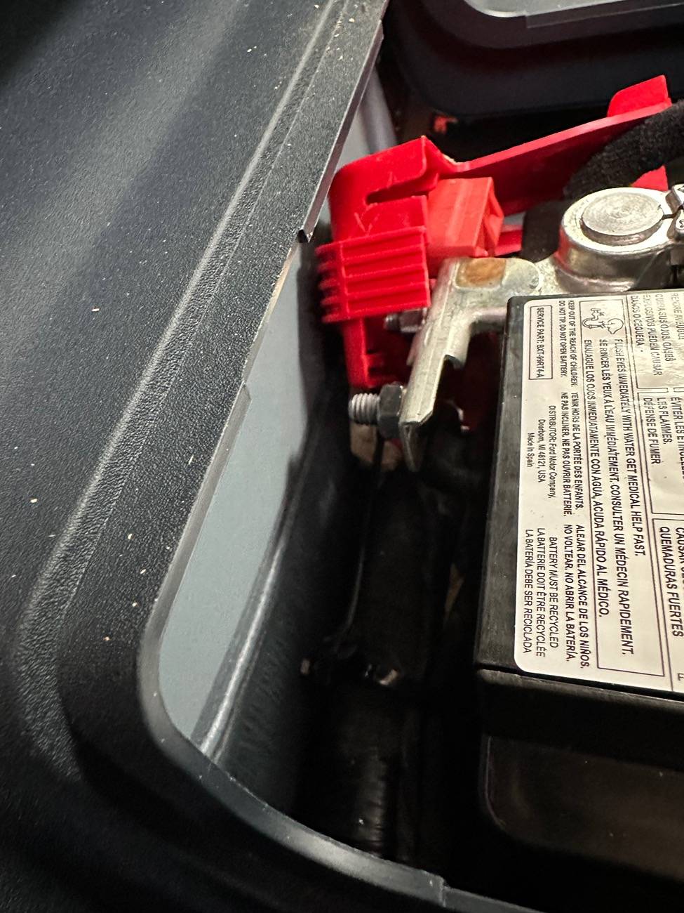

Bad or weak or poor quality 12 volt battery under that back seat.
Talked about 1 million times. Funny, they have only sold 350,000 vehicles so everyone talks about it at least 3 times.
Fix: buy a better name brand battery or an AGM battery. More expensive is usually better.

I would know because the interior lights would not come on. Something just isn't right, and it is not okay, yes I would rather it go into sleep mode before complet failure, but me driving 30 miles a day round trip, and going to sleep an hour later is not okay. I had an appointment with Ford, took it in, and the guy wanted to keep it for 4 days. He acted like he had never heard such a thing. I asked why did I need an appointment to drop it off, and why they would need it for 4 days. He said were really backed up, and would not be able to get to it right away. So I would be out of my vehicle because there wait time of getting to it. I passed. I will just buy a new battery, and move on.
