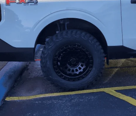

Why is the rear wheel/tire not centered in the wheel well? Are all models like this? Maybe the larger tires are just making it more apparent since there's less wheel gap? Can this be fixed?
Looks like maybe an inch of clearance in the front and probably 2-3 inches to the back.
Good eye, I was just going to post about this. My guesses is it's due to the large lift with this type of suspension. I could see how it might cantilever the geometry.

That's what I was initially thinking, but the rear suspension on these should truly only travel up and down via the independent rear suspension.
It's an independent rear suspension, but it's built primarily around a trailing arm. So as the suspension moves downwards (or is held extended by a lift kit) it tends to rotate forwards.
There really should be no forward to back movement from changing the suspension height like a solid axle rear of say an F150 might have. My best guess is that all AWD Mavericks are like this and the large tires are just making it more obvious. The camera angle and the little front mud flap parts may be playing tricks on the situation visually as well, and giving it a more distorted view from reality.
Hummm good point. My wife has a 2018 Escape, turbo which we really like. Now I will have to give the rear suspension a closer look.
