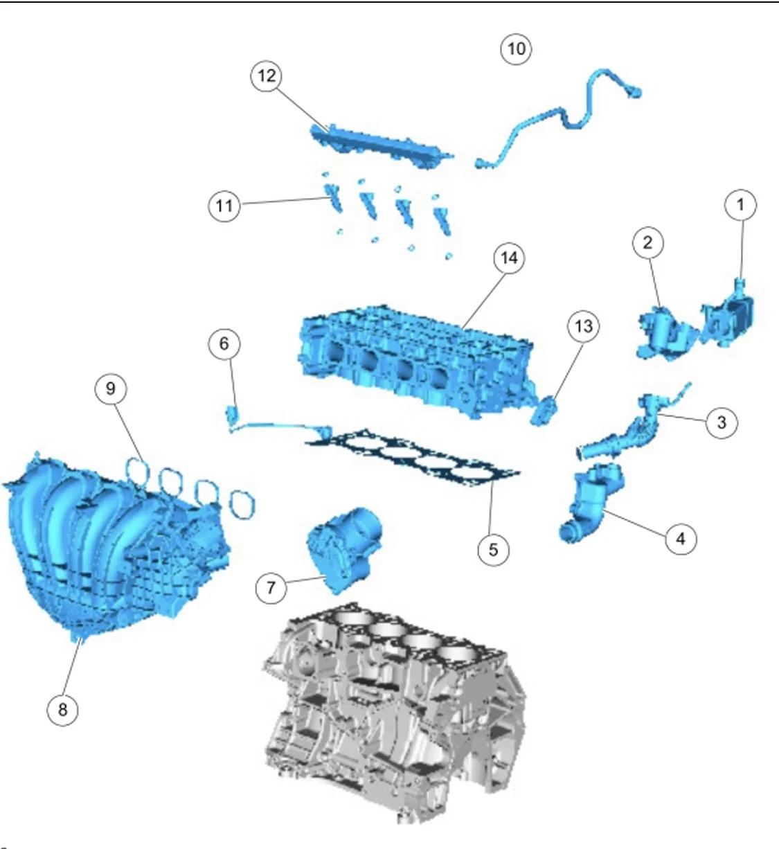

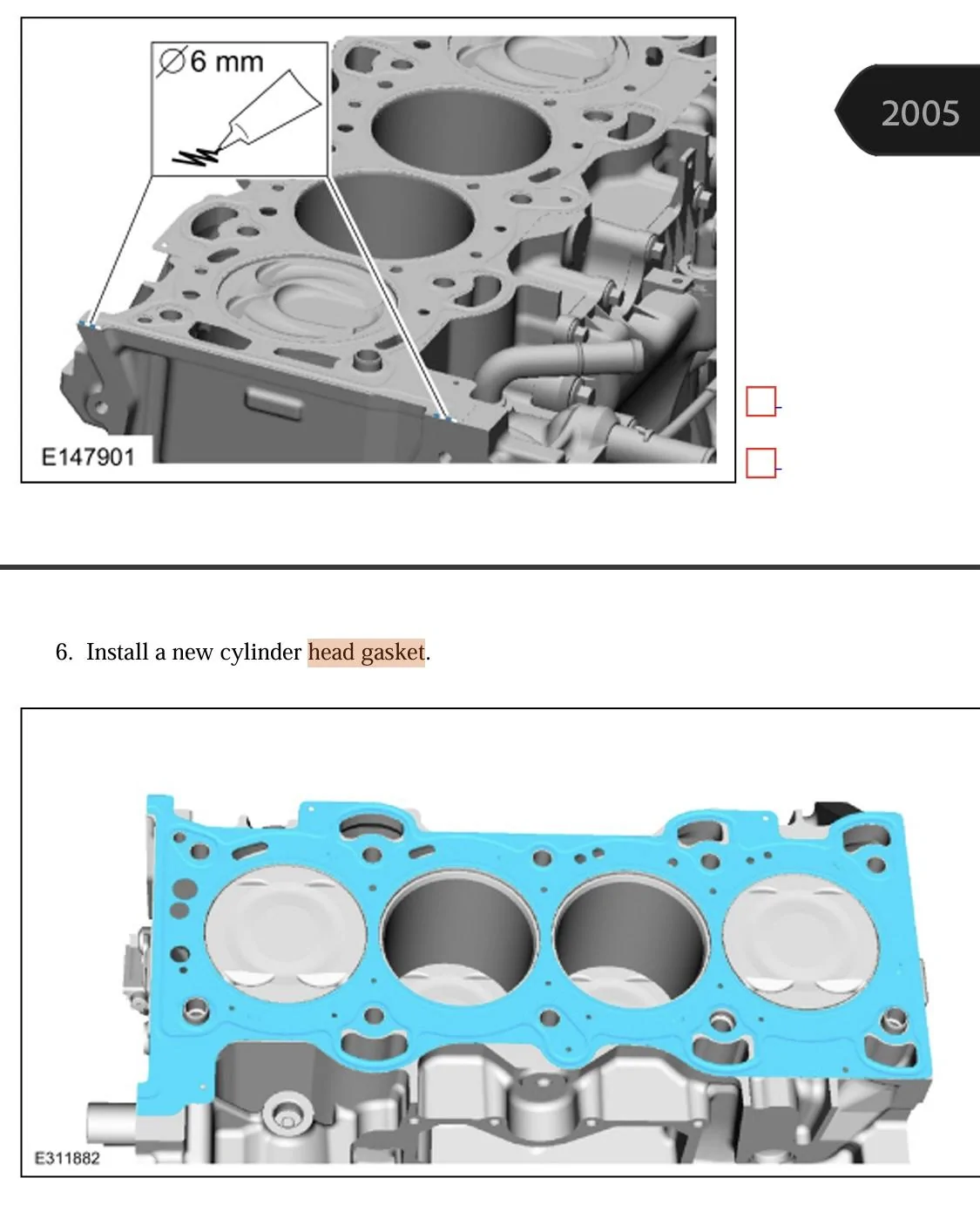

Is this detailed enough?
Ford Maverick 2.5 block design? IMG_8579
Ford Maverick 2.5 block design? IMG_8581

It's going to be a closed deck design since it's a low power output engine. The open deck blocks are usually going to be boosted engines that need the extra cooling around the cylinder walls.
How sure are you about that?
Internet says the opposite.
Low Horsepower & Naturally Aspirated is most often open. Better cooling, but cheaper to make and weaker design.
Semi-closed and closed: much stronger design, can tolerate turbo boosted engines, much more expensive to manufacture, run hotter but are designed for it.
🤷🏻‍♂️ I'm not an expert. Just reading about it since someone brought it up.
