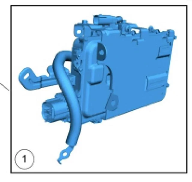

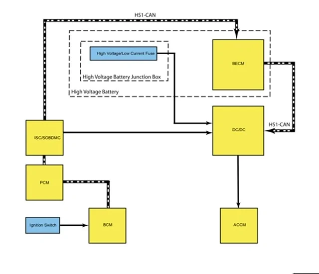

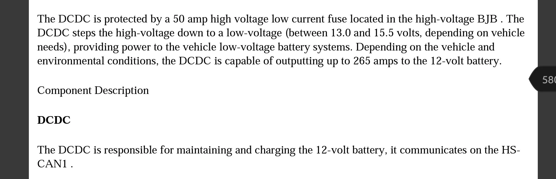

eagerly awaiting the schematics
Here ya go:
Blue thingy is the liquid cooled 265 Amp DC/DC converter that replaces a traditional alternator and is capable of feeding the 12 volt system 265 amps.
265A x 13.5v = 3577 watts.
Attach your 3000 watt inverter and have 577 watts to spare
How many amps is the alternator in the EcoBoost? Bet ya a box of Krispy Kremes my alternator is bigger than yours. 😎

nice block diagram but hardly a schematic. problem is I stated I wanted to run off the HV battery not the little wimpy 12v in the hybrid. running consistent 3k watts is likely to burn it out as it's right on the edge of 12v x 265 amps = 3100 watts.

It's not really different if you pump water from the lake to your swimming pool then to your house; or pumping directly from the lake to your house.
One has one pump. One has two pumps. Both provide basically unlimited water.
Beats the wimpy EB alternator now doesn't it. 😎

you win, bigger alternator
now how about that schematic?

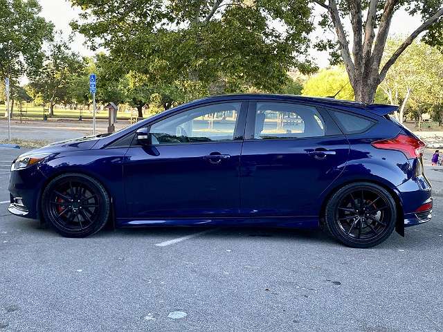

Focus ST with a bed....that's why I bought it.
WTF R U smokin?
I see no resemblance (on the outside).
Are you "juicy"?
