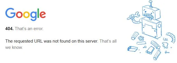

Do not now if you know this, but I got this when I clicked on the link in your post.
Ford Maverick 2.0 EcoBoost engine -- overall feedback? 1730502860952-xa

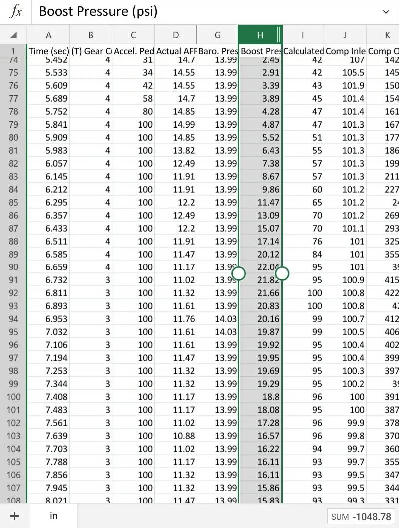

several people have told you it isn't turbo lag, it's the transmission. you aren't listening so I'll show you. this is how fast it makes full boost.
cruising in 4th gear, full throttle let's call it 5.6 seconds of the log (first column) and about 4 psi boost. this is a pain on my tablet so forgive the sloppy work.
Ford Maverick 2.0 EcoBoost engine -- overall feedback? Screenshot_20241102-010756_Excel
my truck hits 20 psi in under a second (row 89). about 150 milliseconds after that, it downshifts from 4th to 3rd.
your truck might not do exactly this even in sport drive mode with premium fuel. but whatever you're perceiving is not turbo lag. there is effectively none.

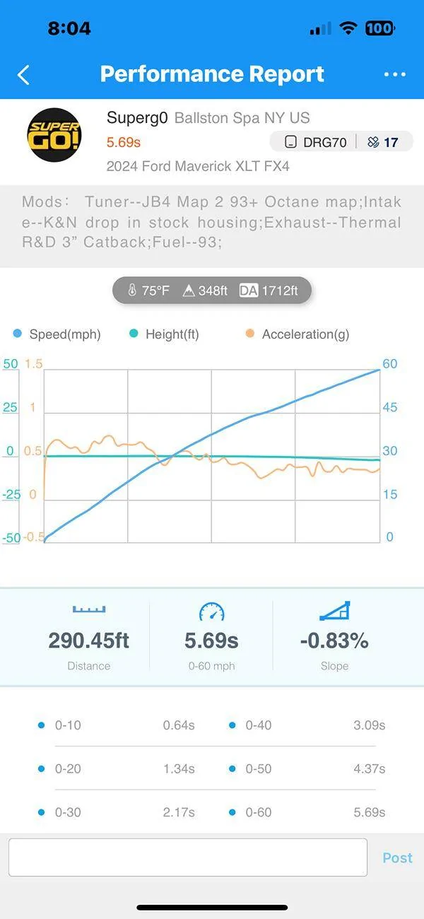

There are not many trucks that can 0-60 in under 6 seconds. Those that can will cost you twice as much as a Mav
Ford Maverick 2.0 EcoBoost engine -- overall feedback? thumbnail_IMG_0309

No. Off idle they always increase lag. Some of the power has to get diverted to spool up the turbo. Are you telling me that my lived experience is somehow wrong? Particularly when I have other non turbo vehicles that do no experience that lag.
Ford has certainly tuned things so as not to overstress the transmission but there is no need to do so at low rpms. The curves clearly show the torque is no where near the limits for the trans in that range. A turbo I-4 simply does not produce much power at the low end - they shine when it revs up. Everything is a trade off.
Why is this fact so hard for people to grasp?
Yes you are wrong. Turbos do not rob power to make power. They are not super chargers. They don’t need to take power to make power. Lag is just the amount of time it take from throttle input to the time it takes to make boost. Is lag a real thing yes. Is it a real thing with a tiny turbo we have in these trucks no.
Not in the sense of lag you are trying to describe. What you are more that likely feeling is the tuning. As other have stated the time it take to go from 0-18psi is almost instant. Maybe 1 second. That is not what most would call lag. What you are feeling is fords trq per gear. They limit the power in the first few gears as to help drivability and ease on gear box.
What they do is limit the amount of power being made with boost and timing as to not have a massive amount of power sent the instant the turbo lights up.
This is proven by the fact anyone who has tuned the ecoboost knows they can hit the throttle and power is very fast. Fast enough that my wife’s 2.0 edge tuned can chirp the tires on a launch being awd like our maverick.
It’s either trans tuning or fords power per gear you feel not lag.
What I find hard to grasp is the fact that you simply don’t seem to have ever tuned or looked at the data coming from a tuning session to know what you are feeling as lag. The fact the is making a vast amount of its power by 2k rpm when 1200 is the staring point for a launch tells me it’s making boost right off the line. And lots of boost before 2 k. That’s not considered lag.
