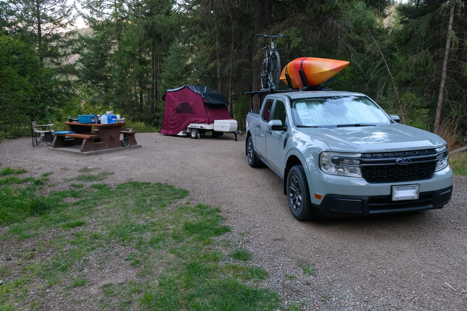

There are lots of sub 2000lb options. There are dozens of brands of tear drop trailers, low weight Boiler type trailers, pop up tent trailers of various types, A liner type hard sided pop ups (base models for weight usually). If you really don't need anything fancy you can even look into tent trailers designed for touring motorcycles.
I use one of the motorcycle types, perfect for solo and couples camping.
