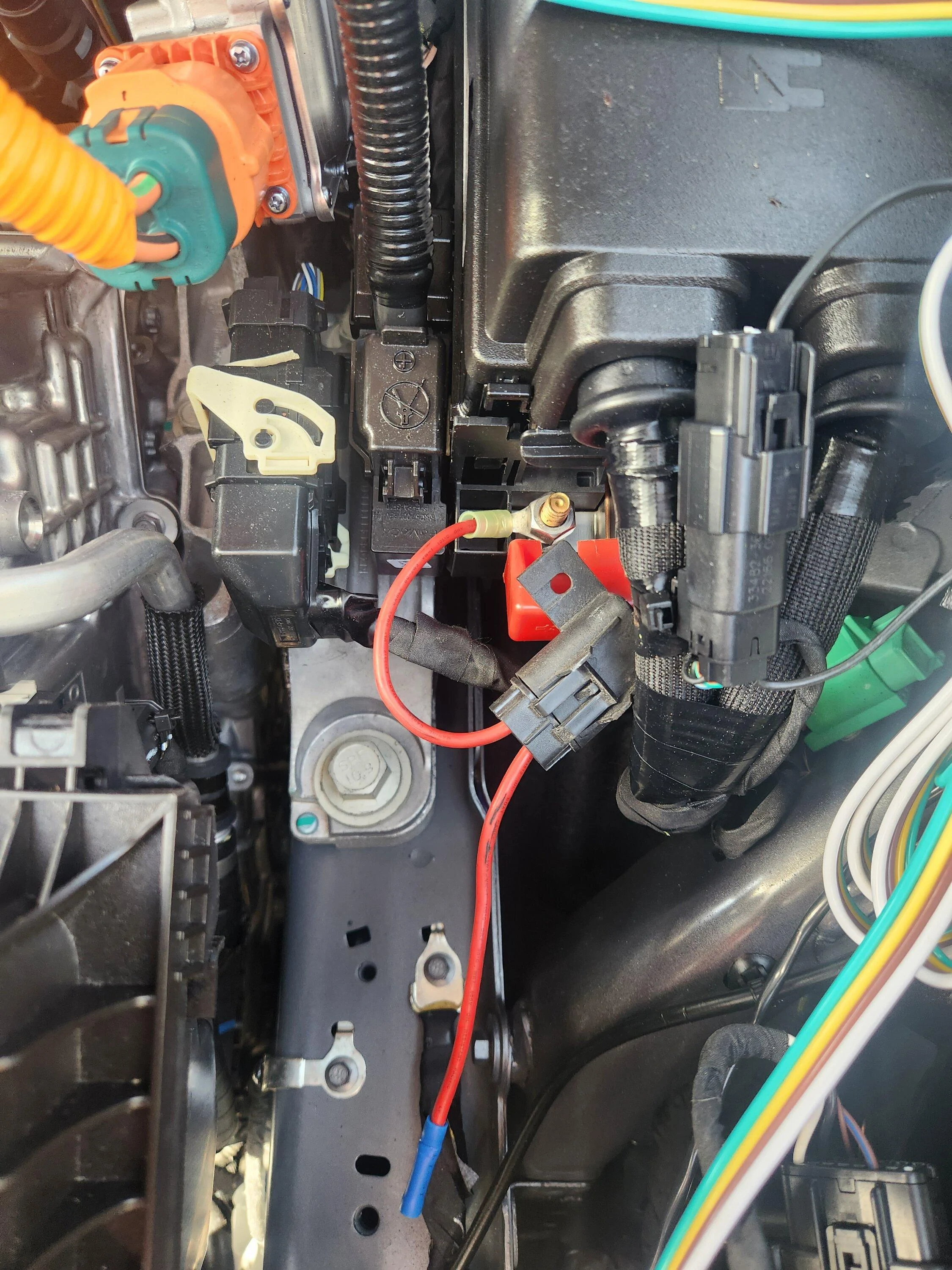

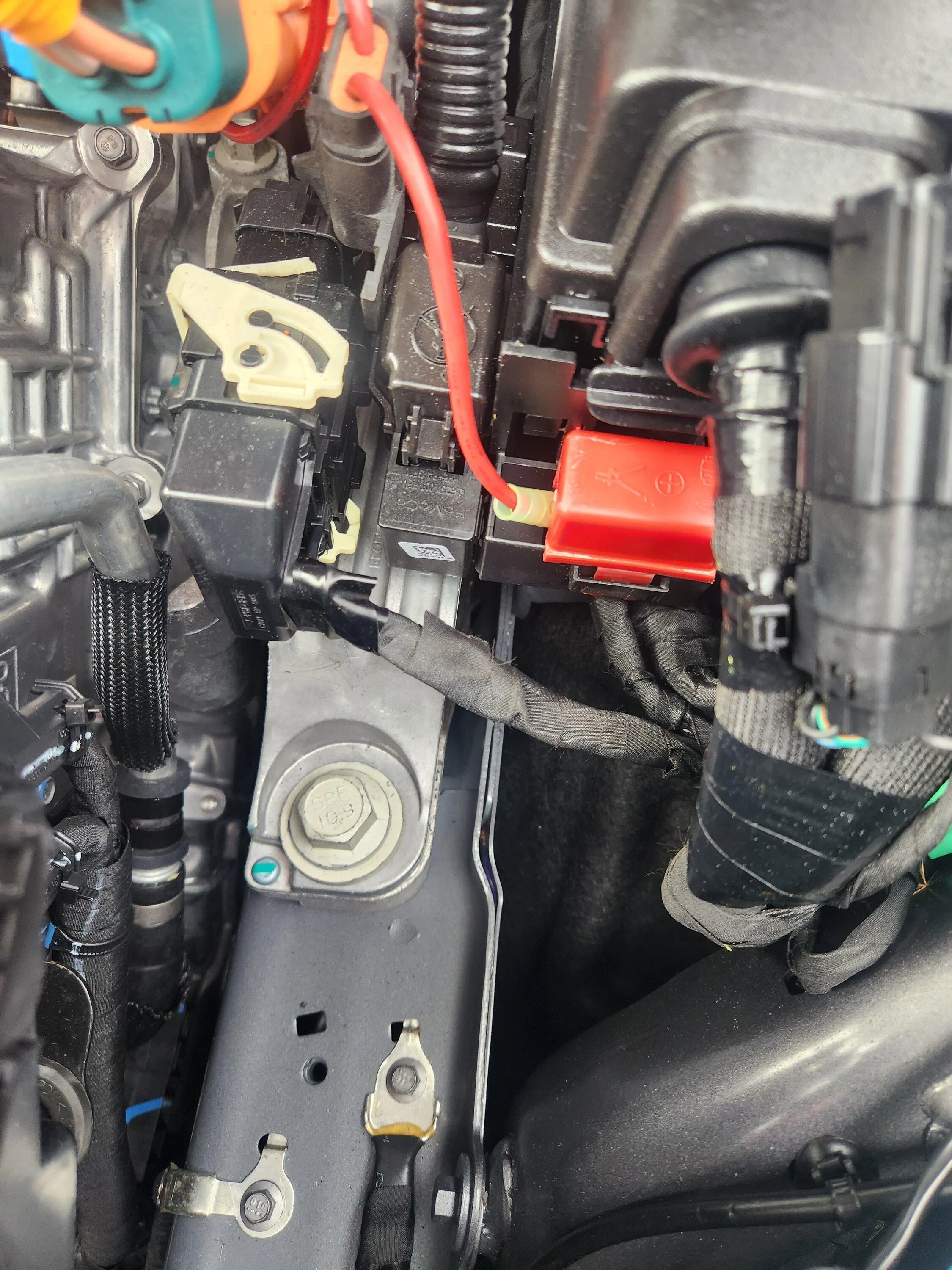

i used the battery jumper post for my brake controller and charge line. I also installed a 12 volt lighter plug under the dash for my RVi brake controller. Towed 2000 miles round trip to Key West and back. No problems.

So, John - If I do not connect to the battery, where would you suggest? My auxiliary brake system requires 12 VDC to operate correctly when towing the Maverick behind the motorhome. It was recommended to use the battery jumper post.

Don't have a truck yet, but from reading the manual, I would guess the positive and negative battery jumper posts under the hood.
Also where you would hook up a battery tender or a jump box.

I took a triple tap in fuse 24 (spare) to my mounted 12v female socket and shared ground for my BlueOx Patriot. Separate switched and constant taps for Valentine One G2 and dash cam with separate rear cam (powered by same cable to main one). Under hood post positive for RVi battery maintainer and front led bar, negative to one of the chassis grounds right under positive post. Hope it helps.
