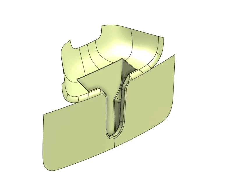

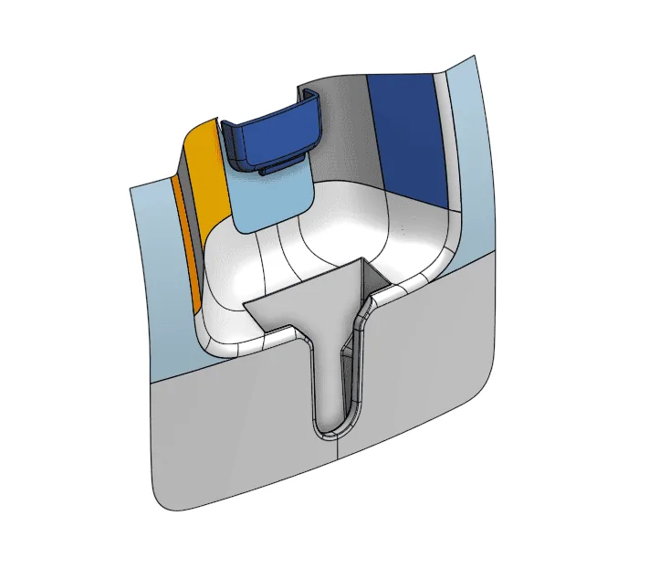

These files are not the accessories, they are for the truck-side mating slot so people can design stuff to fit.

What is this?
Its the center console in the back seat. The files are so you can design stuff and know it wont interfere with the vehicle.
In other words, kind of useless. No ones going to actually print these things, its just for virtual testing which.... who's making stuff that will fit that tight?
EDIT: Well, the center console one is pointless. The under seat one is actually useful.
Really? I've been waiting for months for this. Having a CAD model of the truck-side is way better than trying to measure it and then just doing a bunch of test prints. It's easy to get the fitment perfect when you can do a section view.
People have had the FITS socket mapped for a while. I just sent measured blanks in to the office for printing.
What are you printing that hugs the console so tight?
A garbage bag holder that one of my kids isn't going to shear off by bumping it. Most of the stuff I've seen looks pretty fragile, especially if people are using PLA.
