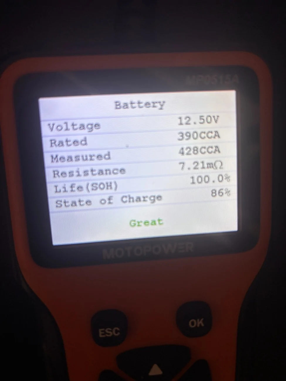

I took the original out, desulfated it twice and charged it up 3 weeks ago and just now tested it on my shelf. Not sure if this is good or not, but I think I'll keep it in the box for a spare. Starting voltage was "OK"
I noticed on my original mini and my current bigger one - the stated CCA and Ah must be understated on the battery.
Even at the worst of battery saver functions (though I never got Deep Sleep Mode), my SOH was 100% because the tested CCA & Ah was over, despite the fact my SOC was <30% because voltage was 11.5-11.7.
My Rav4 with 5 yr old battery has less internal resistance than yours.
4.93 mO mid-Jan when my last NoCo charging/repair was like Mid-Dec when warm enough.
It was at 12.5 also. And son doesn't drive frequently or long.
But yours is holding good voltage at least.
Nice emergency if going on like camping trip where you know doors may be constantly opened/closed with lights on.
