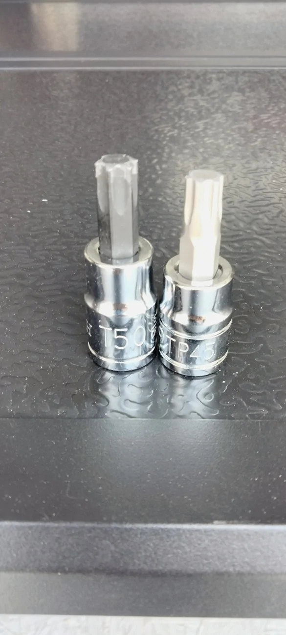

Torx PLUS VS Torx
I apologize for any inconvenience.
Update: Thanks to @Mavl-ous
He brought to my attention. The T 50 is the same size as the TP 45. Very similar to some of the metric sockets being the same size or close to SAE Examples
8mm (5/16"), 10mm (3/8"), 13mm (1/2"), 16mm (5/8"), 17mm (11/16"), and 19mm (3/4").
I went back and rechecked the smaller screws along the tailgate and I couldn't find a similar matchup between TP and reg. Torx.
I started this thread because a lot of folks don't understand the differences between Torx PLUS &Torx.
Ford uses Torx Plus on our Mavericks.
The difference between regular Torx and Torx Plus is pretty significant. It becomes a difference between stripping out the bolt and not stripping it. Here are some pictures and a short 9-second video.
Yesterday I received my Torx Plus bit set. $21.06 on Amazon. Link 👇🏻
https://www.amazon.com/dp/B004UC9WJE
yes quite a difference, thanks. I never knew. :oops:
This video shows the slop using a Torx in a Torx plus fitting. For those thinking it. Yes they are the same size. T45/TP45

Thanks for the heads up, I was wondering why my torx were seemingly an ill-fit when I was doing the tailgate strut. I picked up an impact driver set.
https://www.amazon.com/dp/B082QTHTRD

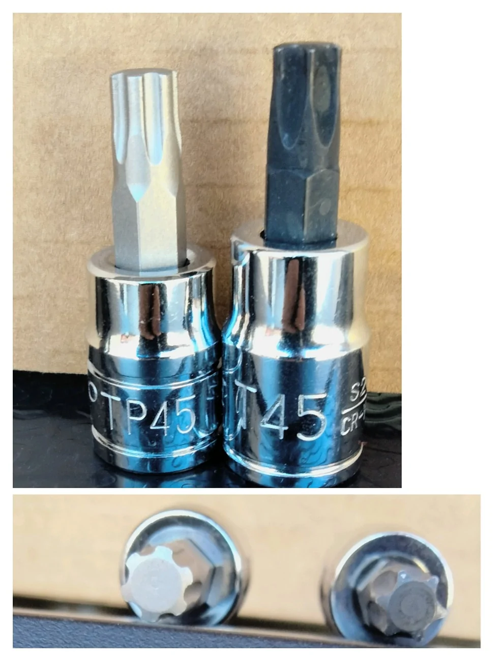

When you look at these pictures. The difference is clear. The TORX PLUS design, appears to be more robust.
While a T50 will fit in a TP45 bolt. It can get a little chewed up👇🏻
